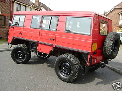

I do not know what kind of use you intend to do of your beast but, if you intend to carry passengers in the back, I would strongly recommend you to open an additional window between side doors, if you go for 3 seats on second row, and another one on rear side if you go for more jump seats on the back. I do not know if you had the opportunity to travel in the rear seats of any K Pinzgauer as it is a quite claustrophobic situation. In Australia you have wonderful landscapes and I'm sure your passenders would appreciate such upgrade.
I enclose a picture of a 716, allegedly a factory demo vehicle with such a feature. I'm doing something similar on my 716 k with 9 seats.
716 k.jpg (24.59 KiB) Viewed 11014 times
