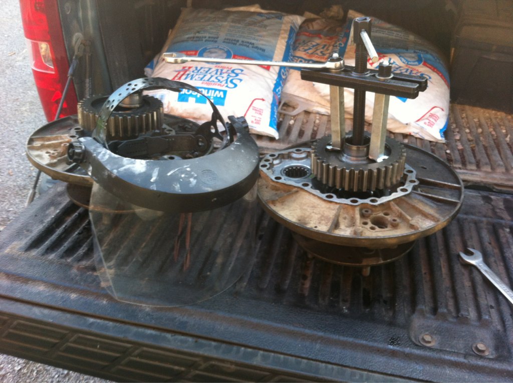

IIRC, I used a puller for both the gear and the drive flange. This is the puller I got from Harbor Trash (Sorry Vince :roll: ) but I had to modify the ends of the arms to fit into the notch in the gear. Then I made up a frame to mount the puller section onto the bolt holes in the brake backing plate, and was able to push it straight out. The frame is only 1x1 tube stock with some angle channel. Note that the shaft is slightly offset from the middle 4 bolt holes and center the drive hole accordingly on the 1x1. If you need pics, let me know.

Thanks to Paul's direction, I picked up a two-leg puller from Princess Auto....Canadian version of your Harbour Freight. I had to grind down the feet somewhat, but the puller pulled the gear off without any issues. One benefit of buying from China is you know their bolts are Metric!! I used the bed liner on my pickup's tailgate to hold the lugs in place while I removed the bolts.
I noticed that the socket bolts were 8.8, so I will replace them with 10.9.
Pulling the gear didn't take that much effort...
I did notice marks on the back plate....are these normal??
I am pretty certain this same puller, with the right metric bolts, can pull the back plate off. I will get those tomorrow.

Good pics Derek. That's about what my modified puller legs look like too. Well done! For a cheap puller, this really works quite well.
