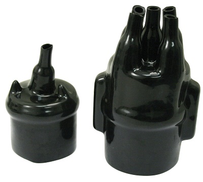

The common denominator for water intrusion problems with any of the Pinz systems is usually high speed driving in heavy rain. The rain comes straight up the tunnel sped up by the fan draw and hits the side/top of the distributor. If you are running a truck in these conditions, then you may want to consider alternative measures such as a "rain shroud" or waterproof distributor bag.
My guess is a small sheet metal shroud in front of the distributor would probably take care of a majority of the water intrusion problems. In the case of this ignition system, a "distributor bag" would be even easier as you are not having to fight with sealing all of the spark plug wires coming off the top of the distributor.

ExpeditionImports wrote:The common denominator for water intrusion problems with any of the Pinz systems is usually high speed driving in heavy rain. The rain comes straight up the tunnel sped up by the fan draw and hits the side/top of the distributor. If you are running a truck in these conditions, then you may want to consider alternative measures such as a "rain shroud" or waterproof distributor bag.
Yup, this is exactly what happened to me with both the stock ignition and the civi ignition. I cut open a Ural inner tube and made a wrap, closing it with zip ties. Works very well.
This would work well for 009 dizzy:
