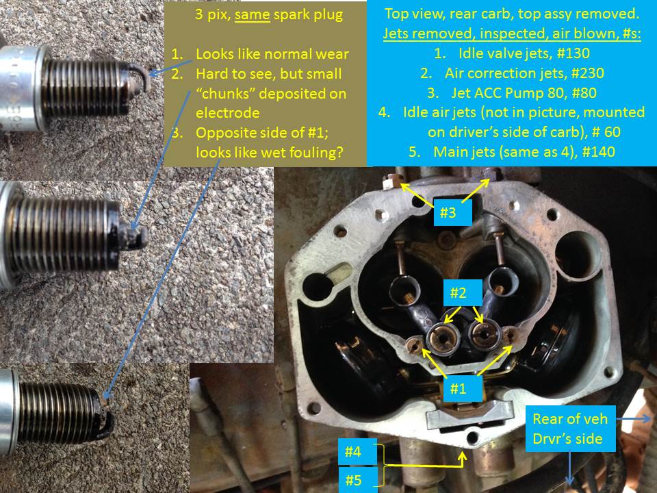

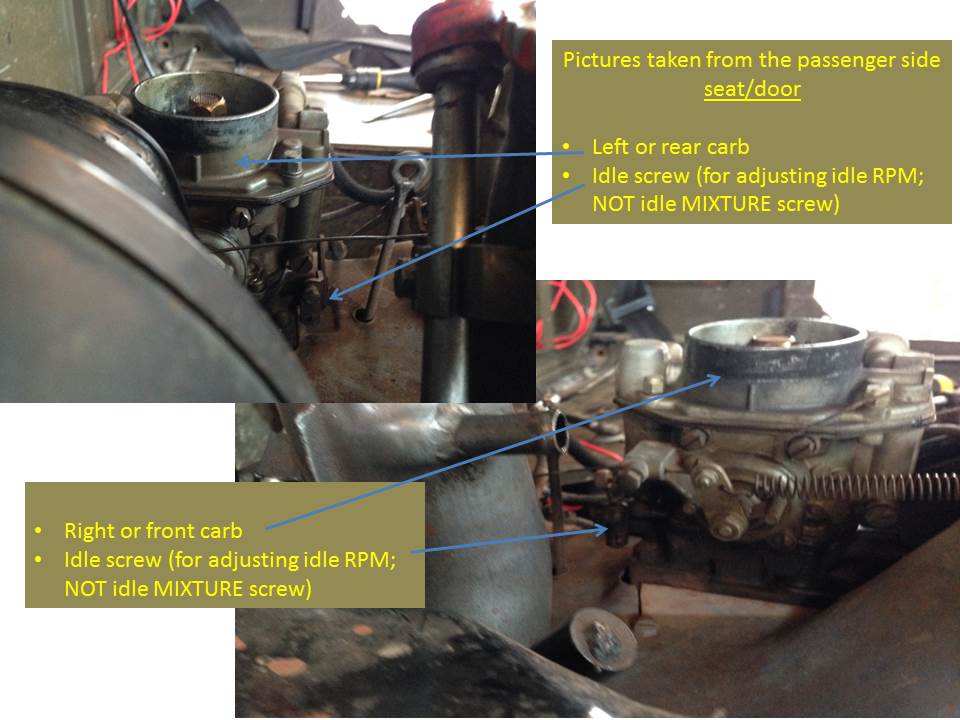

Latest update of actions taken since my last post: Per Scott's advice, prior to tuning, I executed #s 4 (1.5 turns out of the CORRECT screws) & 5 on his "prior to tuning" list. Also, idle screws backed out 1.5 turns. I also verified the fuel shutoff solenoids function properly (remove, RPMs drop as cylinder runs out of fuel, reconnect, hear click, cylinder "recovers"). I cannot get the idle below ~1080 as the engine consistently stalls (you can hear a dramatic drop in RPM, like a cylinder or 2 just quit). Timing set to 5 degrees BTDC. All plugs cleaned & reinstalled in same order (they are only a couple of months old). Engine continues to misfire here and there. Sometimes the idle drops dramatically at a stop and the engine stalls. You can tell all cylinders are not consistently contributing.
Go to this link to hear/see what happens as I rev the engine (timing light shows RPMs): http://youtu.be/1ma2QPLva2U Note flames shooting out of rear carb as I rev the motor. Also, recall little to no impact on cylinders 3 & 4 when I pull the ignition cables off the distrib.
Perhaps this is enough info to offer other ideas?
Unfortunately, per Scott's checklist, I have struck out (ie - can't find guidance online or in repair manual; can't figure it out) on the following: 1. Don't know how to confirm my carb's are "jetting properly" at my altitude (sea level; despite having the repair manual); 2. I do not know how to confirm float levels are correct. 3. I do not have a carb sync (reminder: EI synched the carbs in FEB & worked great - I continue to hope/assume carb synching is good). 4. Don't know how to find tune idle jet screws (have not found them yet).
Any advice, guidance, and/or pictures to ID/do these items would be GREATLY appreciated. I'm off the next week and a half and finally have some time to get after this problem again.
The good news I now know the difference between the idle & idle MIXTURE screws thanks to Scott (boy somebody really misled me on a different post...). Anyway, for rookies like me, hope the below helps you positively ID the idle screws. For the idle MIXTURE screws, they are on the other side of the motor near the fuel shutoff solenoids (see repair manual pg 59)

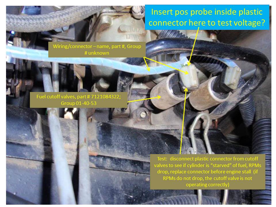

Where did you get the voltages for the ignition system check? My readings are 23.6 v at the solenoids, 17-19.6 at positive terminal of coil, do you know if those voltages are within limits? Where else should I check?
I will try to take some pics of the various adjusting screws,
Maybe someone can comment on if the molex red wire could be the cause of the missing etc...I would like to be sure of what i did to fix the problem for next time it happens!!!!

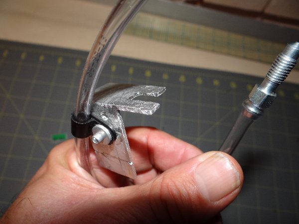

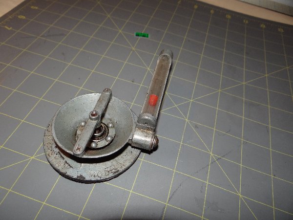

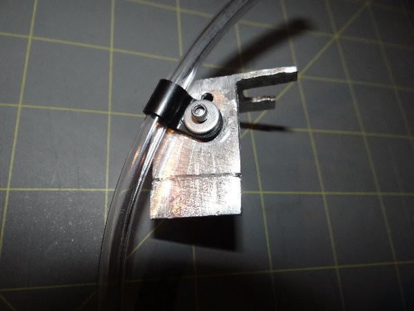

If you look at the entries in this section starting "float level gauge" you can see how to make one,,, made one using a piece of aluminum angle bar and thereby avoided having to make a bend I haven't used it yet and am unsure if i have the level mark correct...i used 1.04 inches from the bottom of the horizontal part of the piece ..(the part that sits on the carb)
I have an old "used but good " synch tool i can send you ..you can send it back ir we can negotiate a price or trade
good luck !

I thought I knew what I was doing and quickly learned these carbs are not for the above average tinkerer. From reading your posts, and based on the items which you are unable to test for, I highly recommend sending to Jim. There are way too many variables to account for, and the implied simplicity of the forum posts are misleading.
Now if you're dead set on continuing, here are my recommendations:
Set timing higher than 5degrees. Set it to 9 or 10. See if that helps lower the rpms before stalling
Your carbs are no longer synced. Once you turned the idle screws, you changed their sync. You must acquire a sync tool. The MB/Mini sync tool shown in the post above will not work properly. I have both and tried many many times..
You have found the idle jet adjustment screws at the drivers side base of the carbs. There is one on each corner. It might be external, or they might be internal. (If they happen to be internal, and sealed, leave them alone). You said you turned them the recommended 1.5 turns. Leave them alone. Don't touch until you've fixed the stalling issue.
Is any gas leaking from the seals?
Are you sure the is no vacuum leak or cracked intake runner?

No, there are two idle mixture screws on each carb (one for each barrel). They are drivers side front and drivers side rear of each carb, near the bottom, and they angle in towards the center of the carb.How many idle mixture screws are there? I am assuming 1 per carb & they are located under/near the fuel shutoff solenoids. Is that correct?

Sitrep: good progress made yesterday, more lessons learned (may help out other rookies like me? See details below). Current status: running ~85-90% normal; best in probably months. Morale is much higher now!
Current symptoms: occasional misfire (sputter) while maintaining a speed (seems gear agnostic); occasional = ~ every 1/10-3/10 of a mile. Still not 100% power (climbed a highway hill nearby, could not go fast enough to shift into 5th. Before I could slowly accelerate up the hill & shift into 5th gear once speed limit achieved). Runs at idle (after warming up) well – no sputtering/misfiring at all. I finished tinkering with the advance set at only 7 & idle RPMs at ~940-860. I did very minor idle mixture screw adjustments (see below). There is some RPM change when I pull #4 ignition cable from the distrib; there is barely, if any, RPM change when I pull #3. My 3 MAIN questions (there are some more below in the details) for the smart guys:
• Question 1: at this point, I think I can eventually eliminate the now relatively rare misfire AND retain the previously enjoyed 100% power by continued tinkering with timing, idle, and idle mixture adjustments. See #12 below for part of the reason why I think this. Am I kidding myself? Is the perceived lack of RPM change when I pull ignition cables #3 &4 off the distrib telling me something else? Thoughts?
• Question 2: see picture & jet numbers below. I live about 10ft above sea level. Per Mr. Burns, looks like I have the right main jets (#140). Is that correct? What about the other jets?
• Question 3: see picture below. Any thoughts or concerns with the spark plug pictures? I have not seen this before (on any vehicle) – 1 side good, 1 side not so good. Reminder: plugs have maybe 1K miles on them & were installed 4/13.

(here is another big lesson learned. While I was playing with timing, RPM with hopes of eliminating misfires so I could use the carb synch tool without fear of flames shooting thru it, I noticed by accident that the rear carb (the one that has nearly all of the misfires/sputtering/flames shooting out) was not returning all the way back to idle. Not sure of the right part(s)/nomenclature…but bottom line is I discovered I had to push the pump lever to get the throttle plates (I think?) to push all the way closed. Just a tiny bit, but it was clear it was not closing all the way like it’s supposed to. Meanwhile, the front carb worked properly – no issue here. Turns out the linkage, the ones I did NOT disconnect in step 6 above, was a bit off. I popped the linkage off and preceded with steps 7 & 8 above. Poof – got rid of all misfires at idle!)
“At this point you may be going back and forth to balance sync, timing, and idle. This is the first round of adjustments. Once the above is set.....you can work the idle mixture screws.”

- Gauer spark plug and carb 201312.jpg (135.34 KiB) Viewed 8054 times
Mahalo for your assistance!

Item #5: You mention that the voltage at the fuel cutoff valves is 8-10. This should be close to 24 volts since there is nothing in the ignition system that steps down the voltage to them.
I'm not sure if this has any effect on your issues but the wiring really should be traced back to breaker #10 and voltage checked along the way.

Please confirm that the voltage on the idle solenoids is 8-10 volts, and the voltage on the positive coil terminal is 20-25 volts; it sounds like these could be interchanged? If so, and the positive coil voltage is 8-10V (when running) then you have a bad 4500 rpm box. It was designed to cut the ignition power if the rpm went too high, but these 40+ year old boxes are dying and reducing the coil voltage even at idle.

Love this forum...would be lost without it! Thanks to all!Jimm391730 wrote:Please confirm that the voltage on the idle solenoids is 8-10 volts, and the voltage on the positive coil terminal is 20-25 volts; it sounds like these could be interchanged? If so, and the positive coil voltage is 8-10V (when running) then you have a bad 4500 rpm box. It was designed to cut the ignition power if the rpm went too high, but these 40+ year old boxes are dying and reducing the coil voltage even at idle.
Jim, confirmed: voltage on pos term on coil 20-25 volts; fuel cutoff valves, confirmed 8-10. Perhaps I'm placing the probe in the wrong spot on the cutoff valves? Or maybe I'm not jamming it into the connector far enough (I barely poked it into the connector out of fear of wire damage)? See diagram below & tell me if my probing is wrong. Also note/confirm part names & #s to ensure we're all talking about the right things:
Tim: I am tracking same (test for clicking when engine is not running; test for decreased RPMs when running & valve cutoff connector removed = carb fuel cutoff system working properly). Also note my carbs were rebuilt by EI ~9 months ago so, unless I see/hear otherwise, I'm ruling out carb rebuild. I'm sticking with timing/RPM/richness combination (the art to find the right combo) as the leading candidate causing my performance/misfiring issues.
- Gauer fuel cutoff valves.jpg (98.55 KiB) Viewed 8017 times
