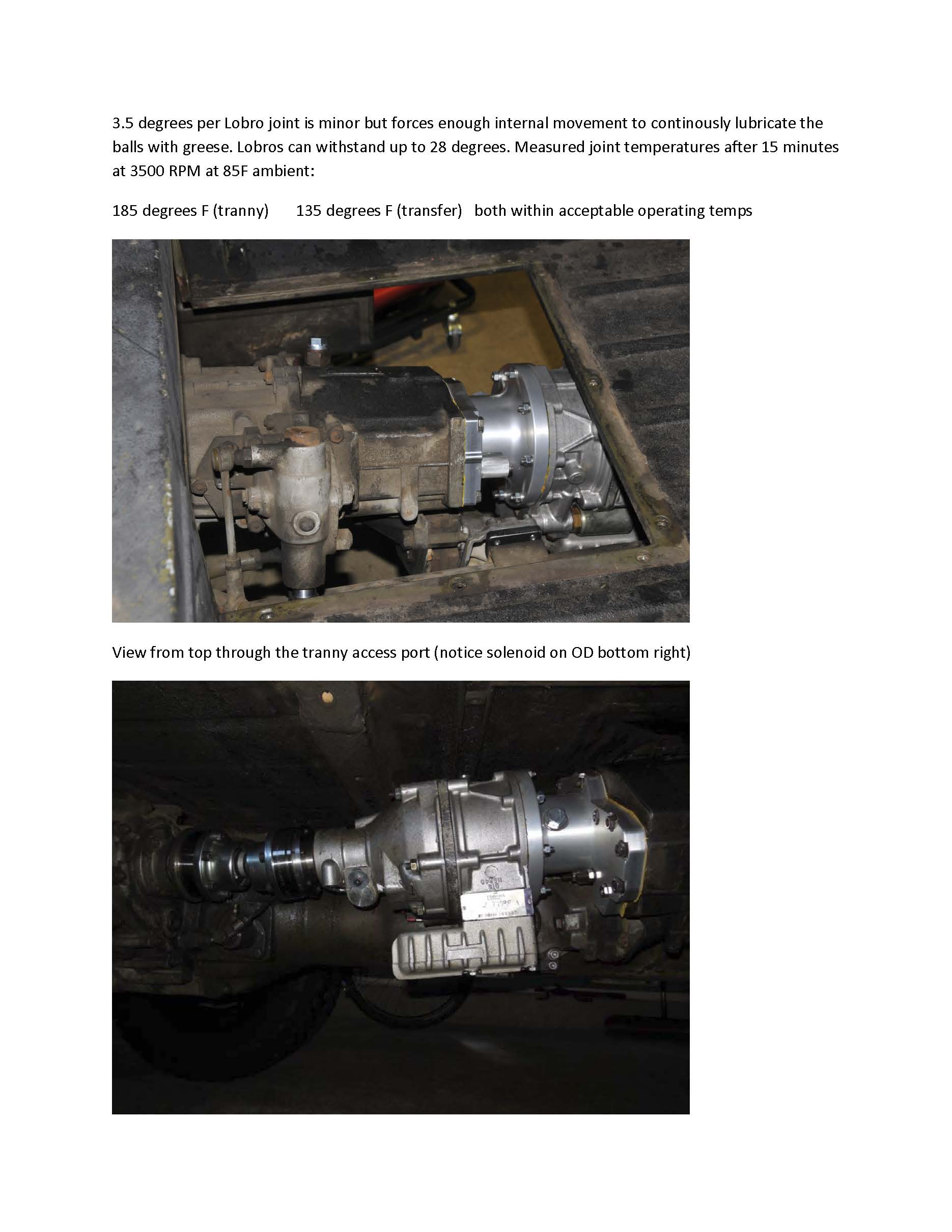

Pinzgauer 710 or 712 over_Page_01.jpg (223.86 KiB) Viewed 10708 times
Pinzgauer 710 or 712 over_Page_02.jpg (182 KiB) Viewed 10708 times
Pinzgauer 710 or 712 over_Page_03.jpg (222.14 KiB) Viewed 10708 times
Pinzgauer 710 or 712 over_Page_04.jpg (239.71 KiB) Viewed 10708 times
Pinzgauer 710 or 712 over_Page_05.jpg (208.42 KiB) Viewed 10708 times
Maybe this will work....next posting will have the rest
Pinzgauer 710 or 712 over_Page_06.jpg (221.33 KiB) Viewed 10707 times
Pinzgauer 710 or 712 over_Page_07.jpg (165.19 KiB) Viewed 10707 times
Pinzgauer 710 or 712 over_Page_08.jpg (237.45 KiB) Viewed 10707 times
Pinzgauer 710 or 712 over_Page_09.jpg (259.53 KiB) Viewed 10707 times
Pinzgauer 710 or 712 over_Page_10.jpg (243.46 KiB) Viewed 10707 times
Re: Overdrive (again)
Posted: Sun Jul 06, 2014 10:09 pm
by bikmakr
Pinzgauer 710 or 712 over_Page_11.jpg (206.11 KiB) Viewed 10706 times
Pinzgauer 710 or 712 over_Page_12.jpg (62.44 KiB) Viewed 10706 times

I had a Laycock De Normanville overdrive in my 1971 MGB. That was a lot of fun, I wish I still had that car.
I must admit that the OD unit looks great, but I can't help but wonder if the Pinzgauer engine would have enough power to drive the vehicle with such a reduction in gearing?
Posted: Mon Jul 07, 2014 11:00 pm
by bikmakr
Thank you all for the kind words. These are the projects I love to develop on my off ours. As to the ability of the Pinz to utilize this OD unit, I had the hand throttle set and maintained 60 mph for over 15 minutes. Dead flat, no headwind. I'll continue to test and report. I'll workup some costs for the adapter in small runs. These are not money makers in the grand scheme of our business, but if I can payback in a small way for all the assistance I've received from these forums, that would be great.

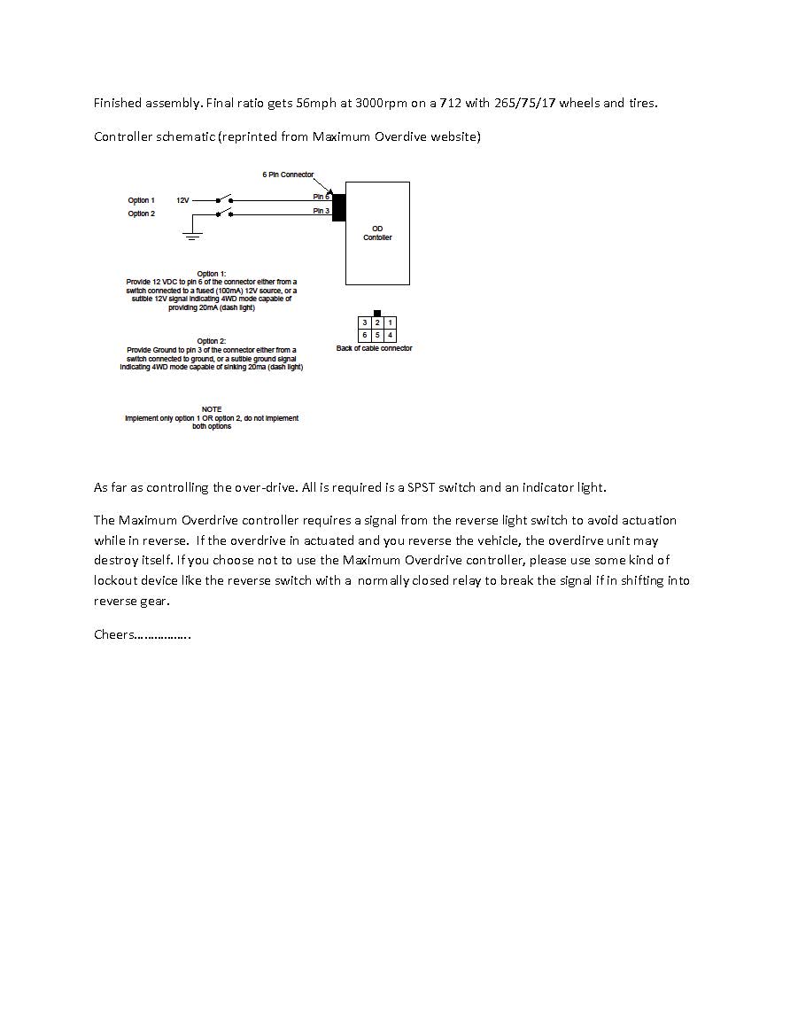

On the last page it states not to engage the overdrive in reverse. I also read this in the owner's manual for my MGB back in the 70s. What would happen if overdrive was engaged in reverse? I never could get an answer to that question, and have always wondered.
