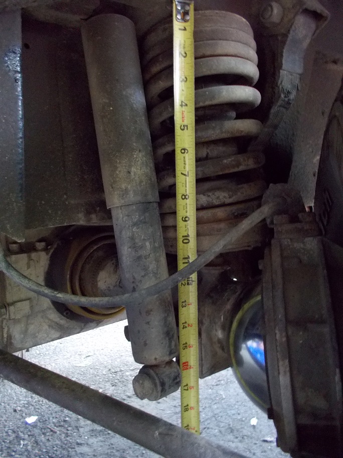

Thanks for the opinion Jimm, I don't do much loaded, in fact bar the shopping I don't carry much in the Pinz at all......the pinz is just a fun truck, the Unimog carries anything that is heavy or bulky. I'm glad I don't have to worry about it straight away........I don't feel the Pinz bottom out even on fast humps.....in fact the pinz really has such a comfortable ride, there is a drop off tarmac onto a gravel/dirt road around here that we always take at 40MPH...in the UAZ 469 that drop is a real THUMP!! crash bang!!!...with the pinz hardly a noise......I watch passengers bracing themselves and then the look of amazement as we just waft over the humps and bumps ahead. I am hoping someone will give a closeup shot of their front springs so I can compare. I did a search but cannot see any pic of front springs with weight on them.

Was mucking about with the truck this morning. Here are some pics of my 710m's front springs with a tape fro reference. Hope they may be of some help.
Cheers, Clive

Dreadnought
Posts: 317
Re: Uprated Front Springs ??
Post by Dreadnought »
Thanks Clive......mine don't look so different to yours.......my bump stops are a little closer to the bottom.......I,ll persevere a bit longer before I think about doing anything drastic like changing them for stronger longer springs.
