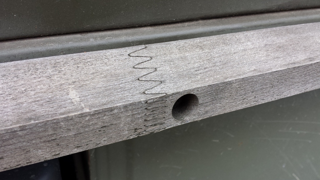

Sorry, I was out of town for a while and couldn't take this picture:
(I assume this is original to my 710M ?)

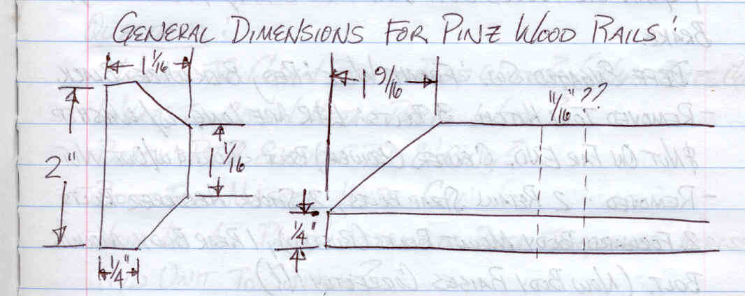

I don't think your rails are stock, have never seen any that were spliced. Don't know where I got this drawing however the dimensions compare well with my rails.
Re: rub rails
I copied what I believed to be originals, and the holes differed from your drawings. It's actually a smaller diameter central hole, with larger diameter (probably what your drawing specifies) holes countersunk in from each side. Inboard, the countersunk hole allows clearance for the nutsert, and outboard, it sinks the fastener head to avoid rubbing damage.
Frankly, the drilling is the most difficult and time consuming part of making the rails, IMHO. IIRC, the central hole is too large to center all my countersink bits, so I had to bore the initial hole undersized, then perform the two separate countersink holes, then drill the center hole to size. If the spacing is off a hair, it's tough to line up, and the washers make "cheating" the holes more difficult.
Your drawing makes the end miters look to be approx. 45 degrees, but I think the measurements are accurate (making the angles more like 70 or something).

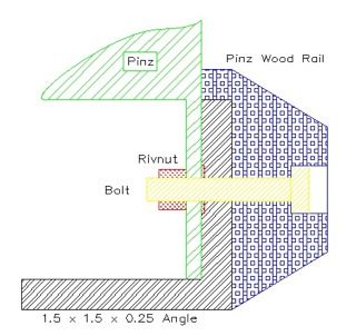

My plan

As a wood worker, I'll be interested to see how the top edge of the wooden rail holds up over time.
If I read the cross section correctly, you have the rabbet cut for the metal bracket only about a 1/4 inch under the top angled cut of the wooden rail. Might be a weak point as it runs parallel with the grain, the metal angle may act as a stress riser underneath that area? :)
Re: rub rails
totaljoint wrote:As a wood worker, I'll be interested to see how the top edge of the wooden rail holds up over time.
Yeah - that is a weak point - may have to tweak it a bit but the end goal is to try and combine the benefits of metal while trying to keep the stock look.
I had another design using C channel with the stock wood profile inside it but that just ended up looking like a quick way to rot the wood.
Will be a bit before I fab it all up but thought with the 1.5x1.5 angle iron it could act as a side jack/recovery area?
In reality my drawing is not 100% correct as the rails do not go down to the bottom of the truck sides as shown - once I get into it I am sure the rails will end up being on top of the angle without the rabbet.
Open to any ideas!

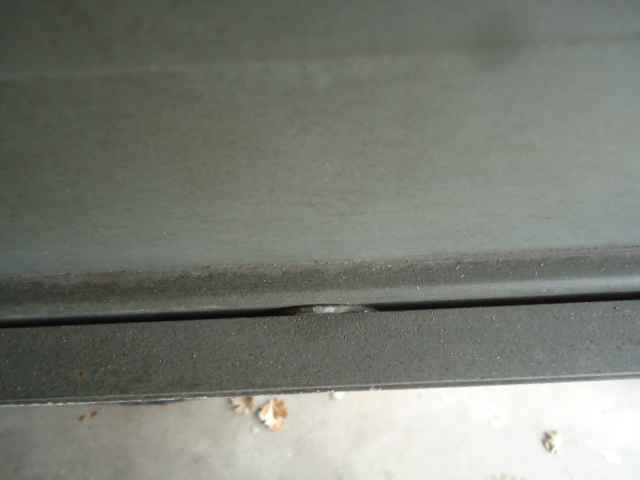

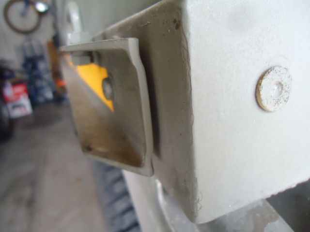

Re: rub rails
I think one of the 'weak' points of any situation concerning rub rails is the direct contact with the metal of the tub body. I found a bit of rust behind the rails when I removed them.
Putting galvanized washers between the rail I created and the body seems to have alleviated the direct contact and also seems to have lessened the possibility of water staying
in between the two surfaces. As my rails are now metal channel they do not appear to be weak or have any flex between the screw points.
