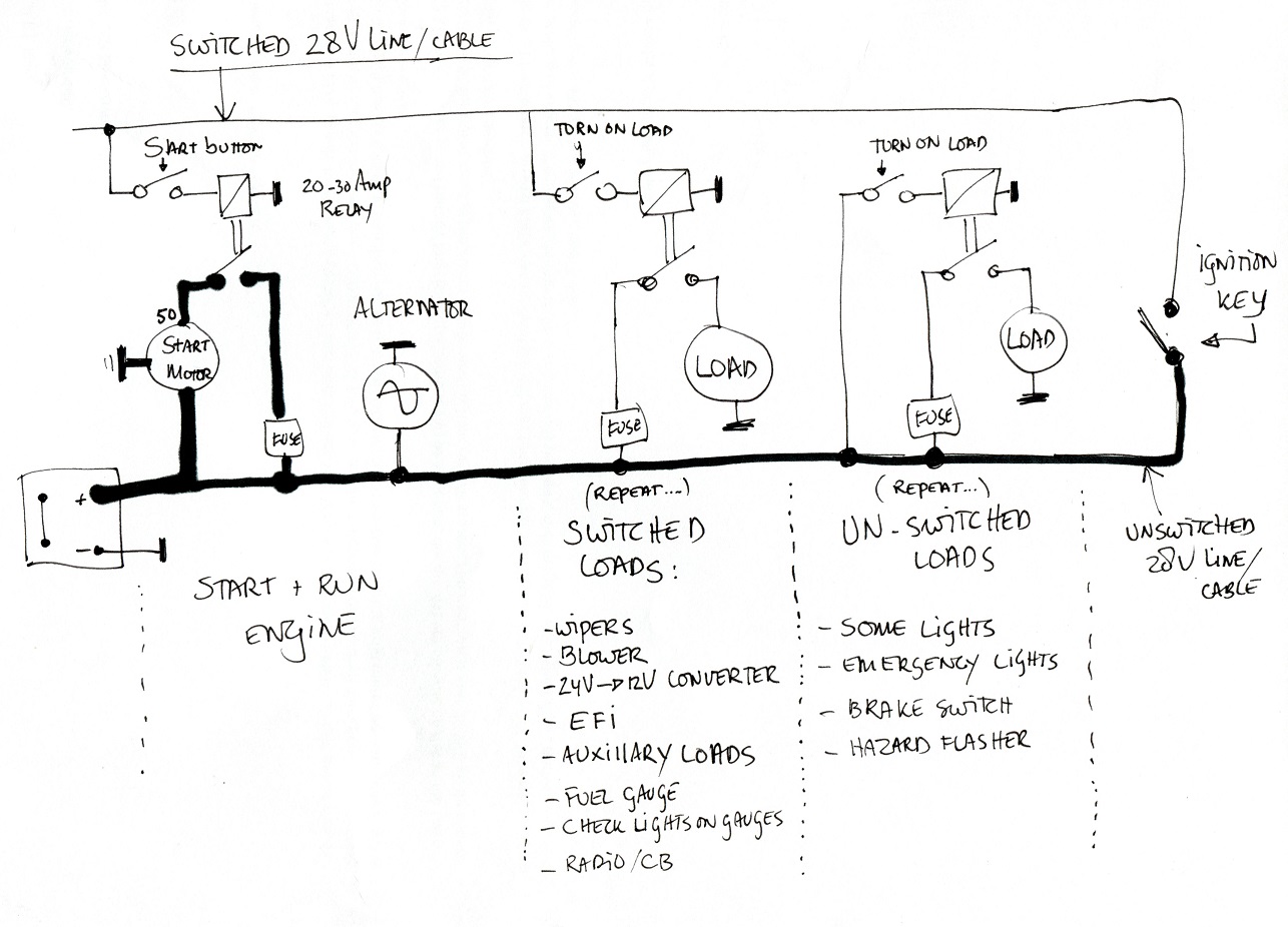

Hi Jules, remember that the ignition switch is capable of handling ALL the power that the truck uses; it enables power to EVERYTHING, all the breakers, all of it (with the exception of the starter motor and the connector behind the right seat). So you need a switch that can handle 50+ amps, or a relay that is energized with a lockable switch. The push button starter switch only has to handle the 5-10 amps that the solenoid draws.

Gents,
What an absolute great forum this is!! You ask your 'Pinz-brothers' and some will always come trooping along, to give an answer on any problem. Thanks for the replies;
I am aware that in the original Pinz-system, the ignition-switch needed to handle 50 amps or so, but I want to rewire my Pinz differently; basically run each component through a relay . (see drawing) (maybe two components sometime) That way I can switch on all different loads through a 'smallish' relay with fuse and keep the main cable from the Alternator/Battery as short as possible with minimal losses, that you normally will get when you go through a ignition-switch and then on to other parts etc. Hopefully it would also make it easier to track electrical problems. Also some thin cables run to various points; to show voltages for analysis on the run, instead of having to use a multi-meter in hard or hot places...
It would require a lot of relays; 20 or so, but with indication lights installed would be an easy system to check.
