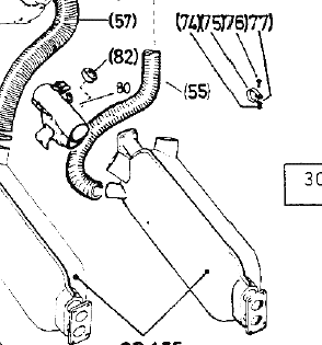

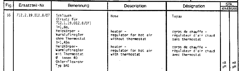

I'm trying to determine the right hose for 30-05-55 that comes off the low port on the front of the heat exchanger. Mine is worn through because it rubbed against the upper exhaust manifold.
Do I translate the parts page correctly that this is 1.6m of 40mm ID hose?
I want to get the quality stuff from Aircraft Spruce since I order from them on a regular basis, and the Pinz deserves the best. Seems like SCEET is the best choice, and since 40mm --> 1.57in that pushes me to the 1-3/4in size (#05-3067).
Does this all sound right? From comments upthread it sounds like the 1-1/2in can't be squeezed over the male fitting.

PDF page 327 from the parts catalogue

Anyone interested in going in on some 40mm metric-sized SCEET ducting?
Metric doesn't seem to exist in regular distribution and appears to be special order only, though the price is in-line with Aircraft Spruce per-foot cost. It comes in standard 4m long lengths, so that means at least three lengths for most of the Pinz applications.
40mm is the key one I need (1.6m) as the english size isn't a great fit at 1.75in for a 1.57 need. The other sizes 50, 70, 90mm have good inch-equivalents.

I used the 1 3/4" for that section when I replaced all of the ducting with SCEET a few years ago. It worked very well.
