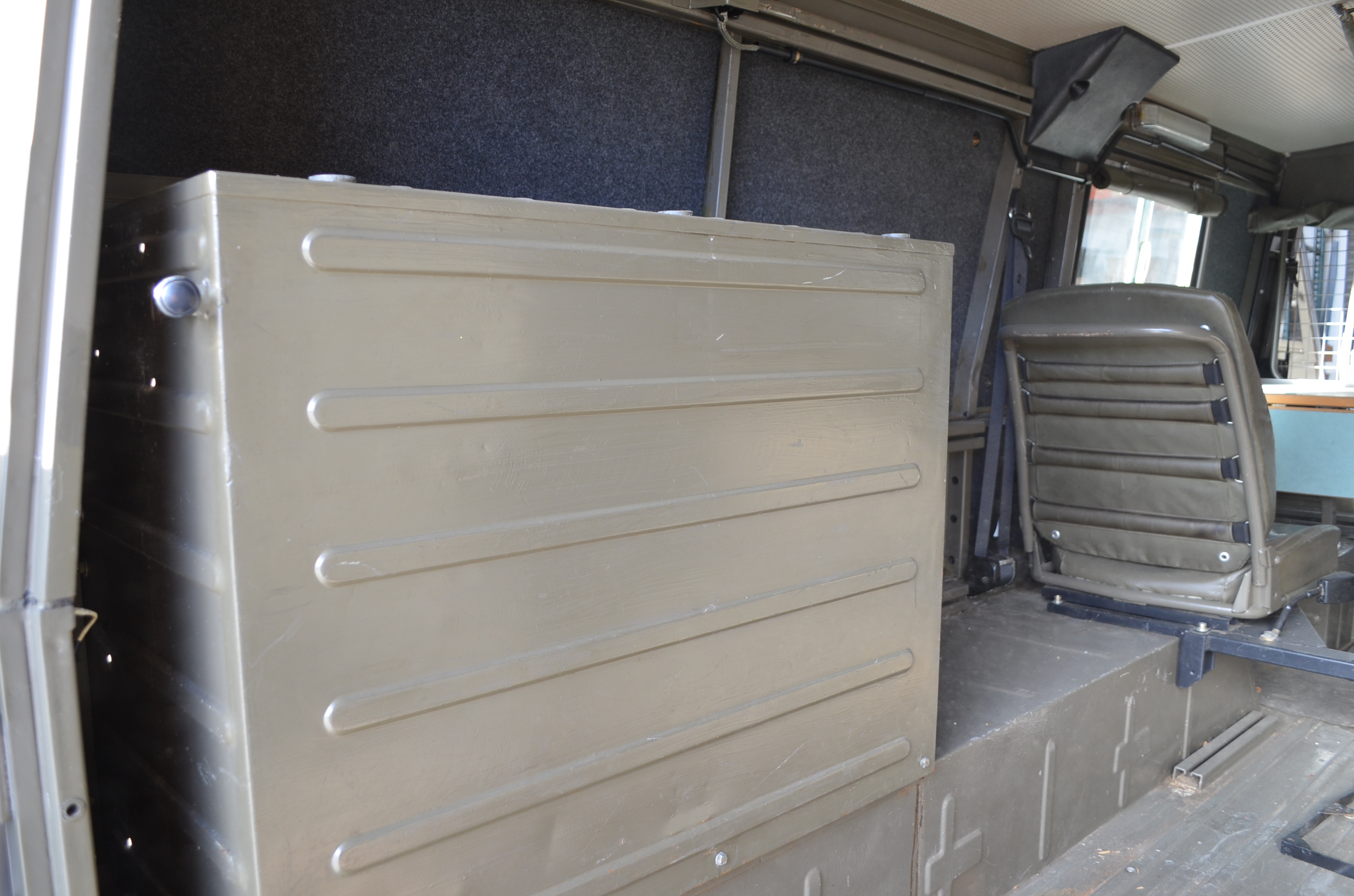

I realize this is a bit of an old discussion but I've been searching for the dimensions of the 712k behind the second row seat cargo area as well as just the second row seating area dimensions. Anyone happen to have this, all I can find are the total dimensions of the m variant which as far as I know doesn't have a second row seating area.

712Ks don't really exist at all - they are sort of like unicorns. :wink:
I may well be wrong, but I understood that the rear seating of a 712K was set up identically to a 710K. So dimensionally the rear seating areas were the same, and the more rearward cargo area was extended by the same amount a 712 is longer than a 710 - some 30+ inches longer.
I suppose this will not be enough info to answer your questions. But it might be easier to get rear seating dimensions from a 710K and then figure the cargo dimensions based on the extra length of a 712, instead of actually finding a 712K.

Rear area behind the rear seats is not that straight forward on a 712K since most have at least one box with outside access bolted to them. If you remove the boxes then the distance from the rear seat to the back of the truck is around 56-65 inches. The variance is the seat back inclines rearward and the back of the truck inclines forward. Base of the seat 65 inches, top of the seat back 56 inches.
