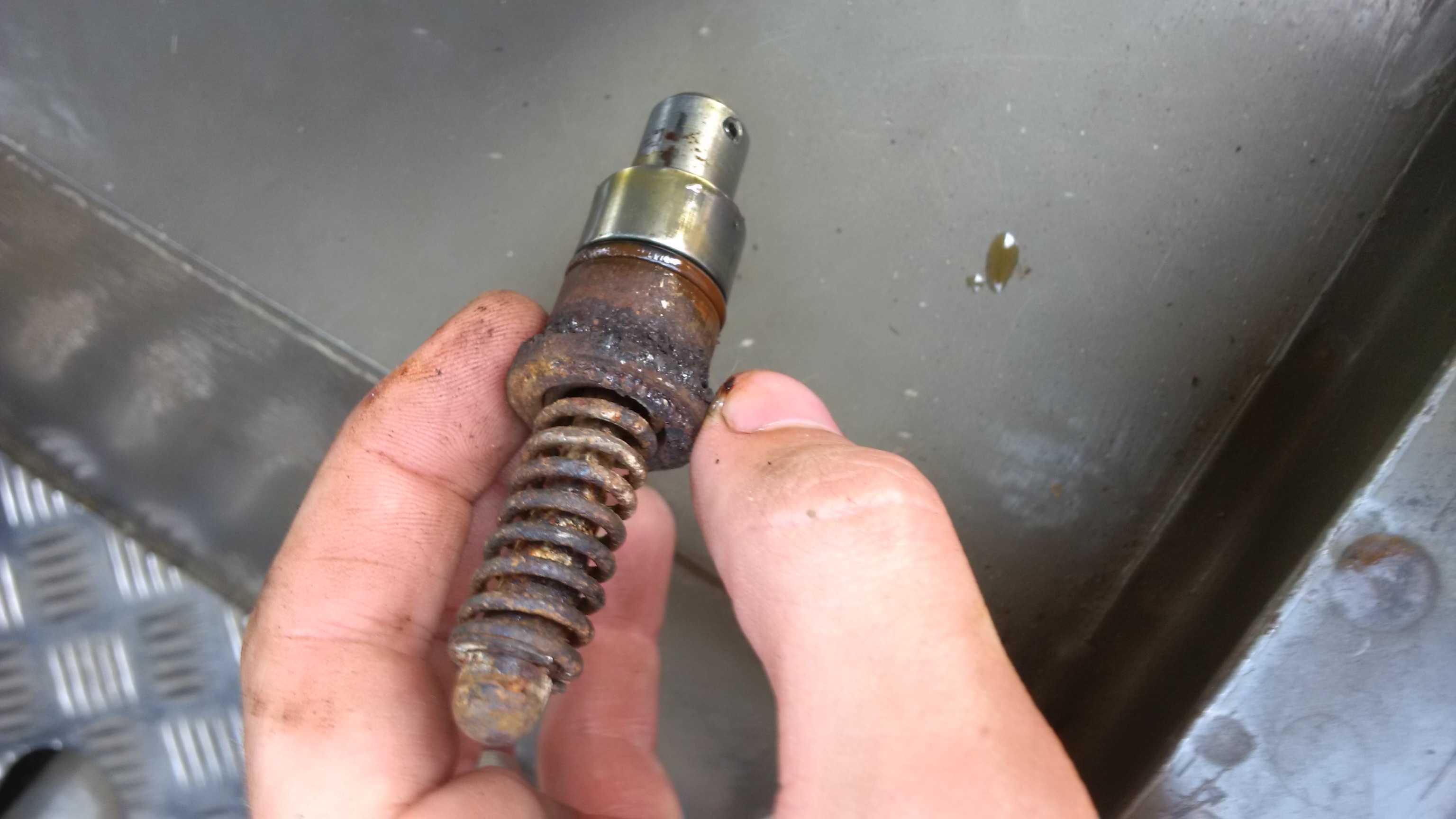

Alright, so the rear locker is FULL of fresh fluid.
I bled the system till clean and nothing changed.
Then I removed the slave, popped the piston, cleaned it and then replaced the piston, rebled, and tried again.
Now the lever feel is more resistant and very sluggish. It does not pop back and requires a little extra force to get down. I did notice the spring shaft that the slave pushes on is EXTREMELY rusty. I can move it easy enough with my hands (takes some force, but not an inappropriate amount) but I think this is what I will try replacing next...
I'm not sure where to go next!

Re: Rear diff light won't come on
Problem solved! Pushrod was way too rusty. I swapped it with the front diff assembly and like magic, the front stopped working and the rear worked beautifully
No throwing money needlessly. I love when diagnosis go well!
