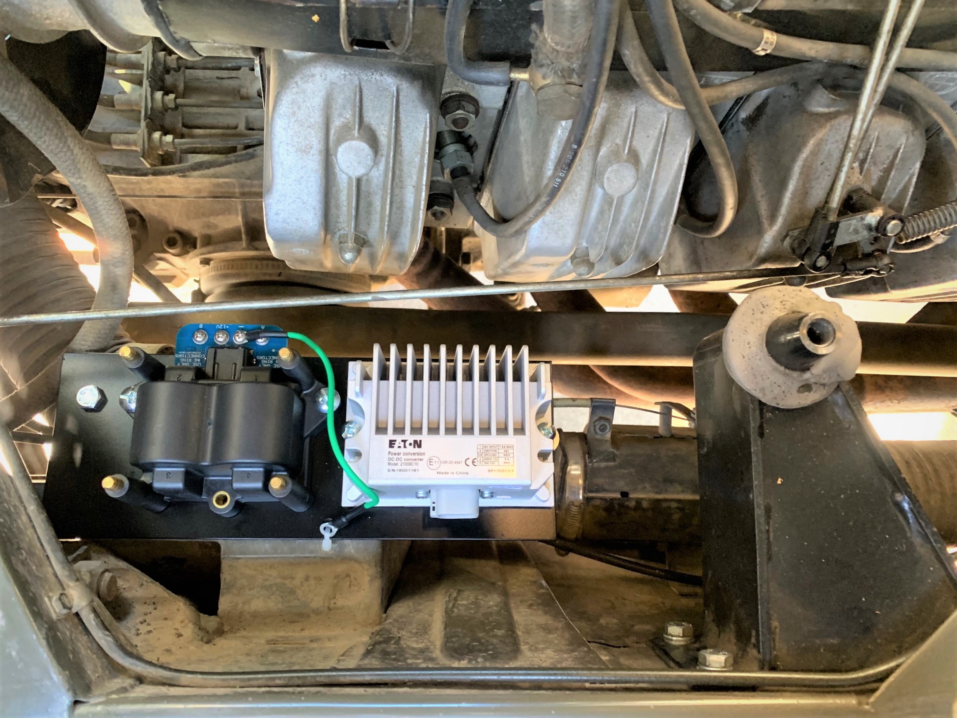

For those wondering about the fit of the current PinzSSI on Austrian rehab updated models, the reduced area from the Austrian rehab seat belt mount does not really create any issues. Pic below of where it mounts (taken early in the install process). The new plug wires have to route over, under, around the mount for the back cylinders.
The existing challenge accessing the mil plugs and wire connections (due to the restricted access the updated seat belt mount brings) goes away with the SSI update as the new plugs and wires are generally easier to deal with and smaller.
IDK about you guys popping the SSI kit in in a couple of hours, but I seem to move a lot slower than that. Some projects slide right in and some fight you all the way (no fault of the SSI kit) and this one was in the latter for me. Of course every step I have to stop and clean/fix something
which adds to the time. Pulling the old ignition parts gives access to clean areas you don't normally get to see. I found a few missing washers and other items along the way and had to wander off to source those too. I fiddled around with it for two afternoons to get it done - removing the old parts and prepping for the install (grr mil plugs and wires), the next day putting in the new stem, module, harness, assembly, plugs, wiring to the battery box, set-up, etc.
I thought my old mil ignition was running pretty well for what it was, but the SSI kit really shows how bad it was by comparison. The new kit can pull smoothly at very low revs and any periodic stumbling is completely gone - much less finesse is required to drive smoothly. Hats off to Richard on this kit.

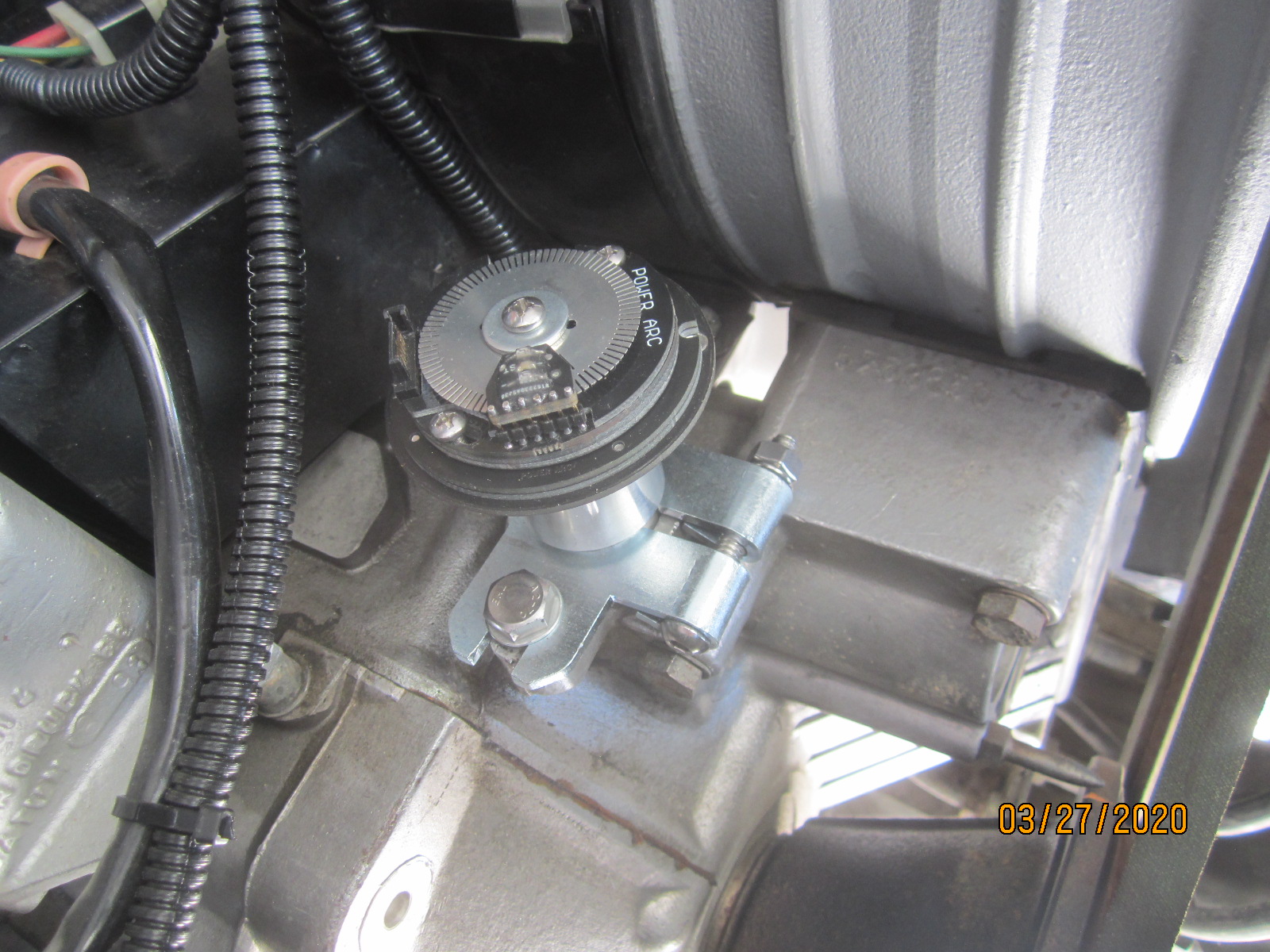

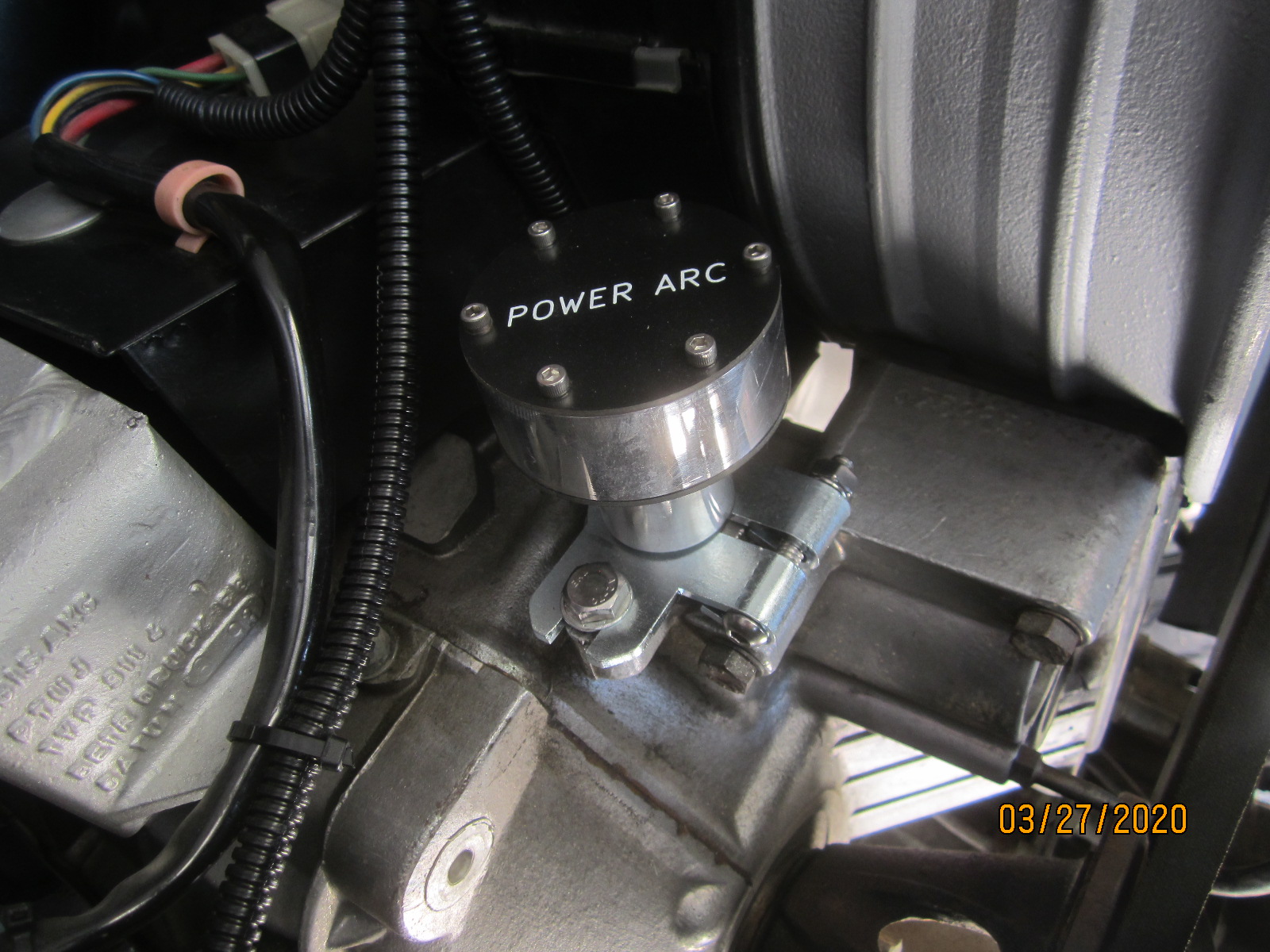

Rick, curious.....what's the difference between the 2.0 and the 3.0 versions?
Re: Pinzi SSI
Posted: Sun Apr 19, 2020 2:34 pm
by pinzinator
The 3.0 had a metal top, is smaller, and has an adjustment that makes setting the timing easier. Performance is the same as 2.0.
