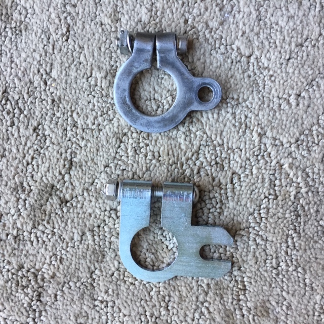

I have come up with a conclusion for those of you with PinzSSI 2.0 who want to know if the 3.0 version is compatible in case you wanted the option to get the parts that make setting timing easier.
I installed a 3.0 over the weekend (the date stamp is incorrect) using a new pinch clamp that works perfectly with the PinzSSI or the OEM Bosch distributor shaft. This part makes it much easier to set timing by rotating the distributor by hand, much like how we set timing in the 60s and 70s. With this clamp I didn't even bother using the screw clamps on the 3.0 to set the timing, it was that easy. The clamp that came with the Pinzgauer from the factory is usually in bad shape by now and is difficult to tighten at best.
Google this part "Distributor Hold Clamp for 235-261 Chevy Elect Distributor" and select Speedway Motors, as they have the best price. This clamp installs like it was custom made for the Pinzgauer. I recommend that everyone orders and installs this clamp. The price is quite reasonable, too!

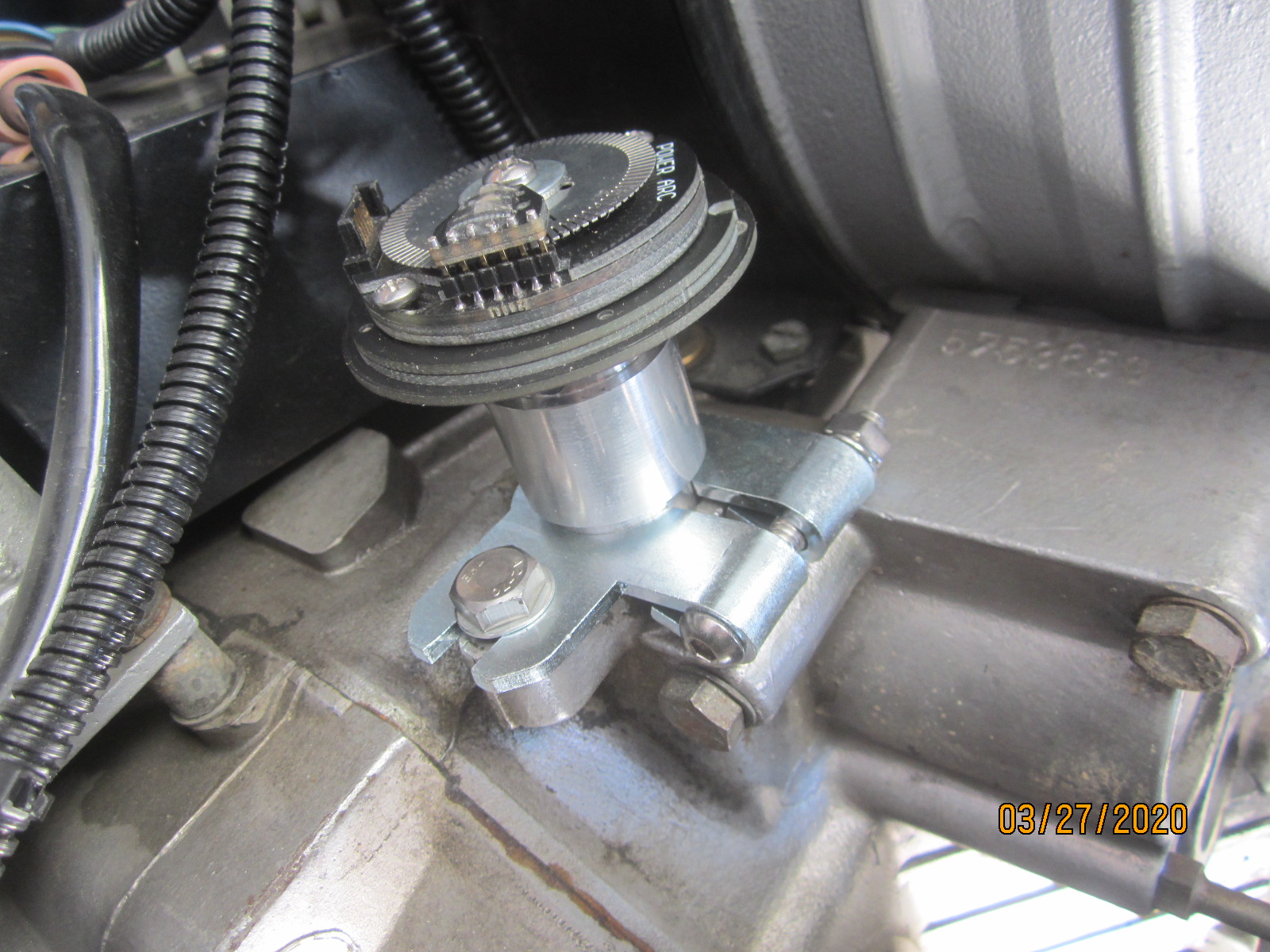

I have had 2 Pinzgauer owners encounter running problems recently due to dust getting into the module and partially blocking the optical pickup. Symptoms of this are rough running to the engine stopping. There is an easy fix and this is easy to prevent.
The module and shaft have to be removed as a unit. On the bottom of the module base plate are 3 small holes that vent into the interior of the module, the rest are blocked by either the module itself or the two mounting screws.
Take a dab of silicon sealer and plug 2 of the holes as shown in the photo. In the third hole, insert a short piece of .2" (5.4mm) rubber tubing, which is available at auto parts stores and is used for windshield washers (give credit to Ron for suggesting this). Route the tube off to the side and out of the way, it doesn't have to be very long. An option is to silicone all 3 holes, but installing the tube will allow moisture to vent out.
Remove the disc and thoroughly clean it. Then take a Q-Tip with alcohol and clean the optical pickup. Re-install the disc and re-set the timing.
The vast majority of PinzSSI ignitions will never have a problem with dust, but this preventative procedure is recommended anyway as a precaution. I will post a similar procedure for the 3.0 ignitions and email it to anyone who has already purchased one.

Thanks for posting this Rick, yup that be yours truly running into this problem :wink:
Up at Poker Flats this week, these trails are very dusty. Coming out of the flats
I was on a forest road and she suddenly pooped out. Started debugging looking
at the vital signs; electric Fuel pump good, fuel flowing in carbs, good healthy
spark. Then decided to check the timing. Pulling the cap off I was amazed at
the amount of dust build up. Cleaned as best as I could W/O removing the disk,
started right up. In retrospect the problem is now obvious but it sure wasn't at
the time.
Two symptoms I noticed, fails to run or runs poorly. If it fails to run that's a sign
that TDC is not detected and there will be no signal to fire the coils. Running poorly
is due to not being able to reliably calculate the engine RPM so you get little to no
advance and will have very poor performance. I also noticed a lot of post-fire in
the exhaust going down steep grades. All makes sense now :P
By the time we exited the area I decided to leave my 712 at a friends in Nevada City
as it was getting very late, it was not running well again and I was not 100% sure of
the problem. Monday I'll jump on Amtrac and bail her out. I have been promising
to look at my buddies Jeep X-case linkage so now he has my baby as hostage so I'll
be looking at that too :D
Re: Pinzi SSI
Posted: Sat Jul 11, 2020 4:13 pm
by pinzinator
The disc takes 2 readings continuously. The first is TDC every 720 degrees of crankshaft revolution (or whatever you set the timing at in relation to the notch in the pulley). The other reading is taken with the 96 slots cut into the disc, which measure engine RPM, and the rate of acceleration and deceleration. With this information the CPU sets the timing. This is quite simple, electronically.
There are two optical windows in the module, one reads TDC and the other reads RPM. If either one becomes blocked, the CPU gets confused and shuts down as programmed, normally within 5 seconds. Under normal driving conditions this would be a rare occurrence, but every PinzSSI owner needs to know about this. A simple blast of compressed air could solve the problem for a long time, but preventing dust makes more sense.
The vents are intended to vent moisture, not heat. If all vents are blocked off there may never be a problem, but if your're in Florida or Louisiana, etc., I would recommend the vent tube to be sure. In those climates moisture is more of a problem than dust.
However, I have never heard of a failure due to moisture anywhere.
