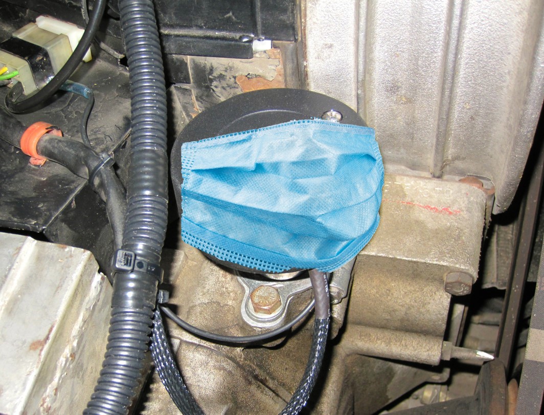

In any case, I'd suggest everyone with a PinzSSI that gets into dusty
environments, take a look under the cap, and if anything it's a good
excuse to re-check your timing. If you don't want to plug holes and
add a tube then there's the Farmers fix -- put a zip-tied Freezer bag
over the entire assembly.

Wow! That is even simpler!

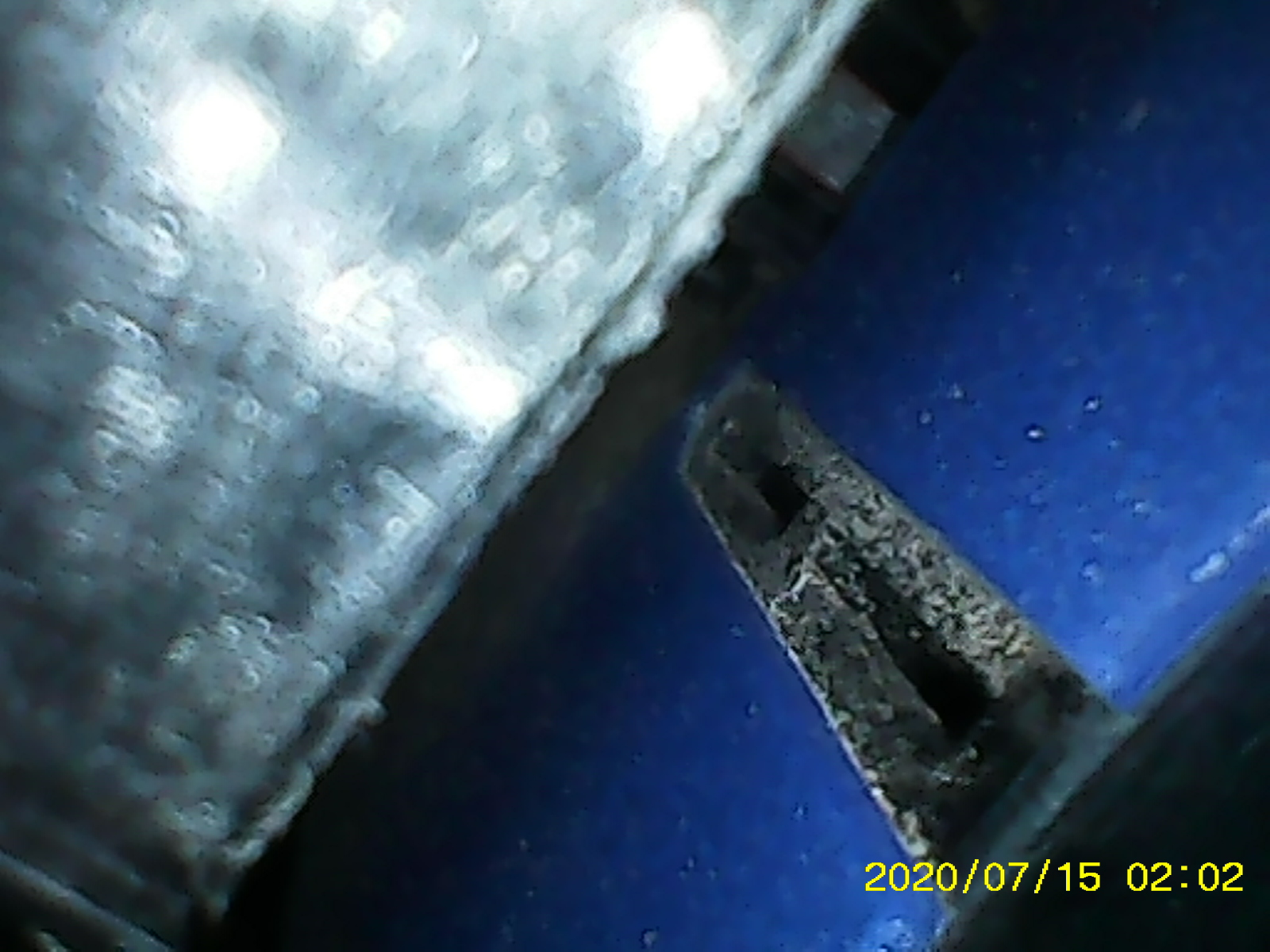

After removing and cleaning the timing disk and swabbing in the area of
the optical head, I decided to give it a go and drive my rig home from my
friends place, about 200'ish miles.
It still didn't run right but I got home. Yesterday I had some time to tear
into the issue more deeply and now I know why the problem occurred and
why it's not a quick fix. The PIX below shows the debris buildup on the photo
diode area. Note there are two slots, one for detecting TDC and another for
RPM/Accelerating. These slots are recessed, I presume to eliminate "cross-talk"
between the two channels. Being recessed it's vulnerable to dirt getting in
there effecting the detectors, it's a tight space obscured by the illuminator
and not easily cleaned with Q-tips.
What I ended up doing was to fill a syringe with Alcohol, squirt it in the
cavity area, then used my air compressor to blow it out. It took 4 tries
before I felt it was clean. An alternative would be an eyedropper, and a
can of dust blaster, or a electronics friendly ultrasonic cleaner. For good
measure I RTV'd the holes up on the underside, and placed a piece of foam
at the cable entry. On the trail I'll toss a freezer bag over the assembly.

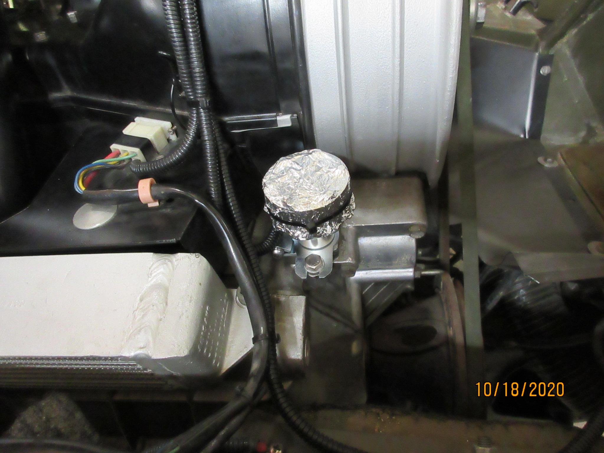

A piece of aluminum foil might be a simple solution. Cut a round piece and place it over the module, then form it to the shaft. A zip tie will hold it in place forever. The amount of dust that can get in will be minimized.

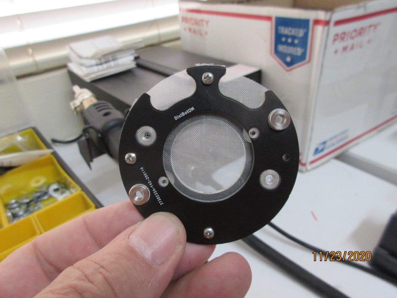

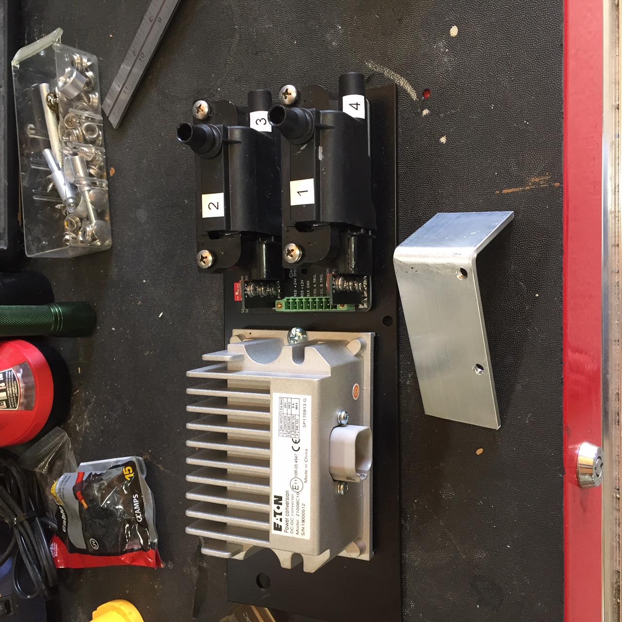

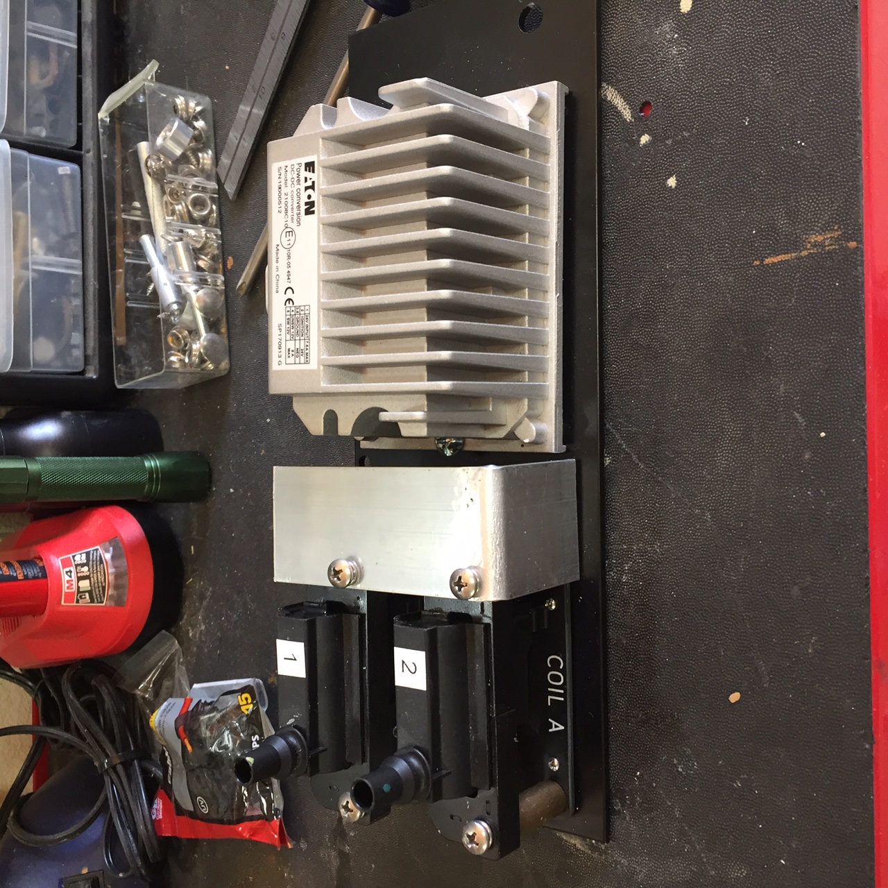

The latest version of the PinzSSI, the 4.0, is now available and includes a filtering system in the module that will keep most of the dust out, if not all. The 4.0 also incorporates 2 separate coils, one to fire cylinders 1 & 4, the other fires 2 & 3. Another difference is that the ignition comes completely assembled and ready to install, except for the plugs and plug wires. Performance and dependability is no different from previous versions.
The 4.0 also comes with a lead that supplies 12 volts for an accessory, such as a phone charger, radio, tachometer, or GPS, when the key is on. Total current cannot exceed 5 amps.
