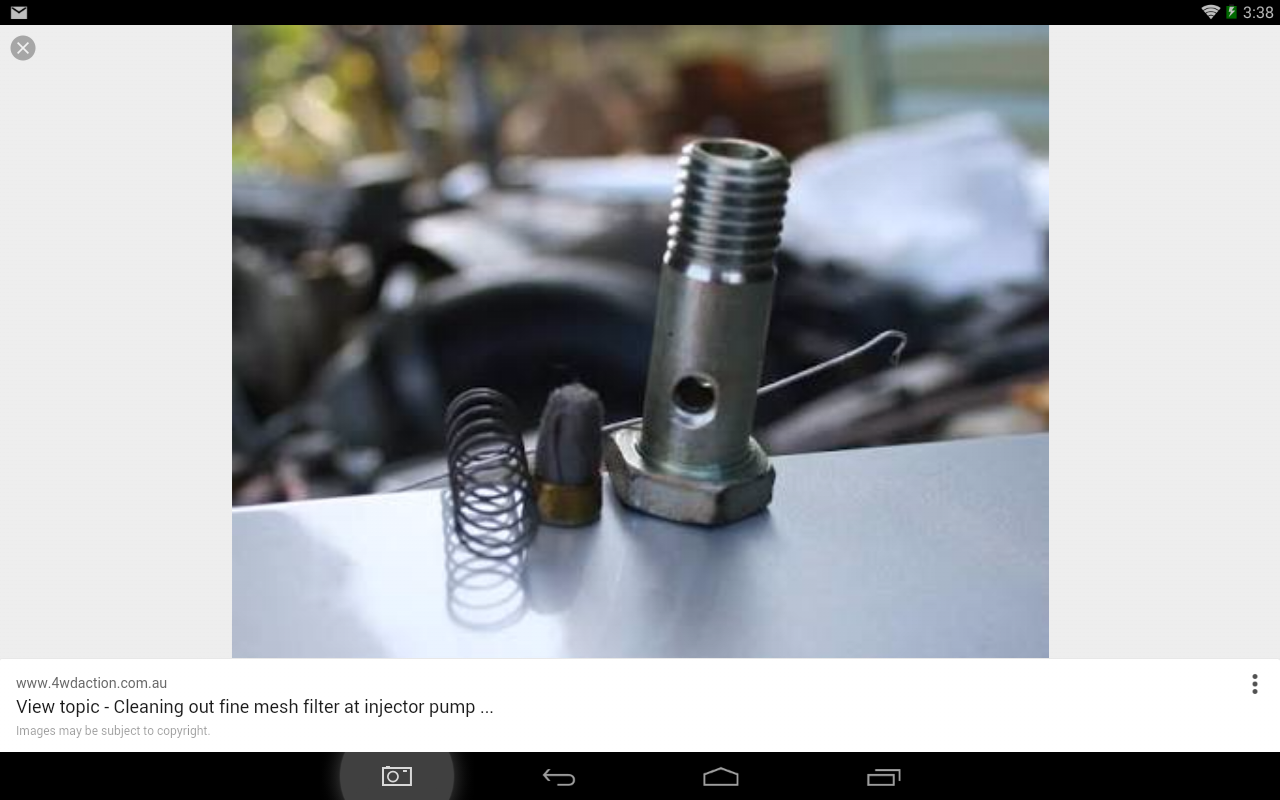

one2many
Posts: 178
Location: Melbourne Australia
Re: Intro from Malaysia - WR7002 - C304
Post by one2many »
Often the mesh strainer found in most IP's is a source of white smoke or lean condition, you've probably already ruled this out if your pulling the injectors but if not then you should definitely check it as the first point when looking for cause of white smoke. They are often hidden inside a banjo bolt or behind a hex bolt "plug" and its common for them to be neglected or not known of.
Love your build, it will be a fun vehicle once completed.
geckoadventure
New Zealand
Posts: 481
Location: Malaysia
Post by geckoadventure »
Yeah I know will check it Saturday when I put the injectors back in. Had this before in a my 13B-T monster.
