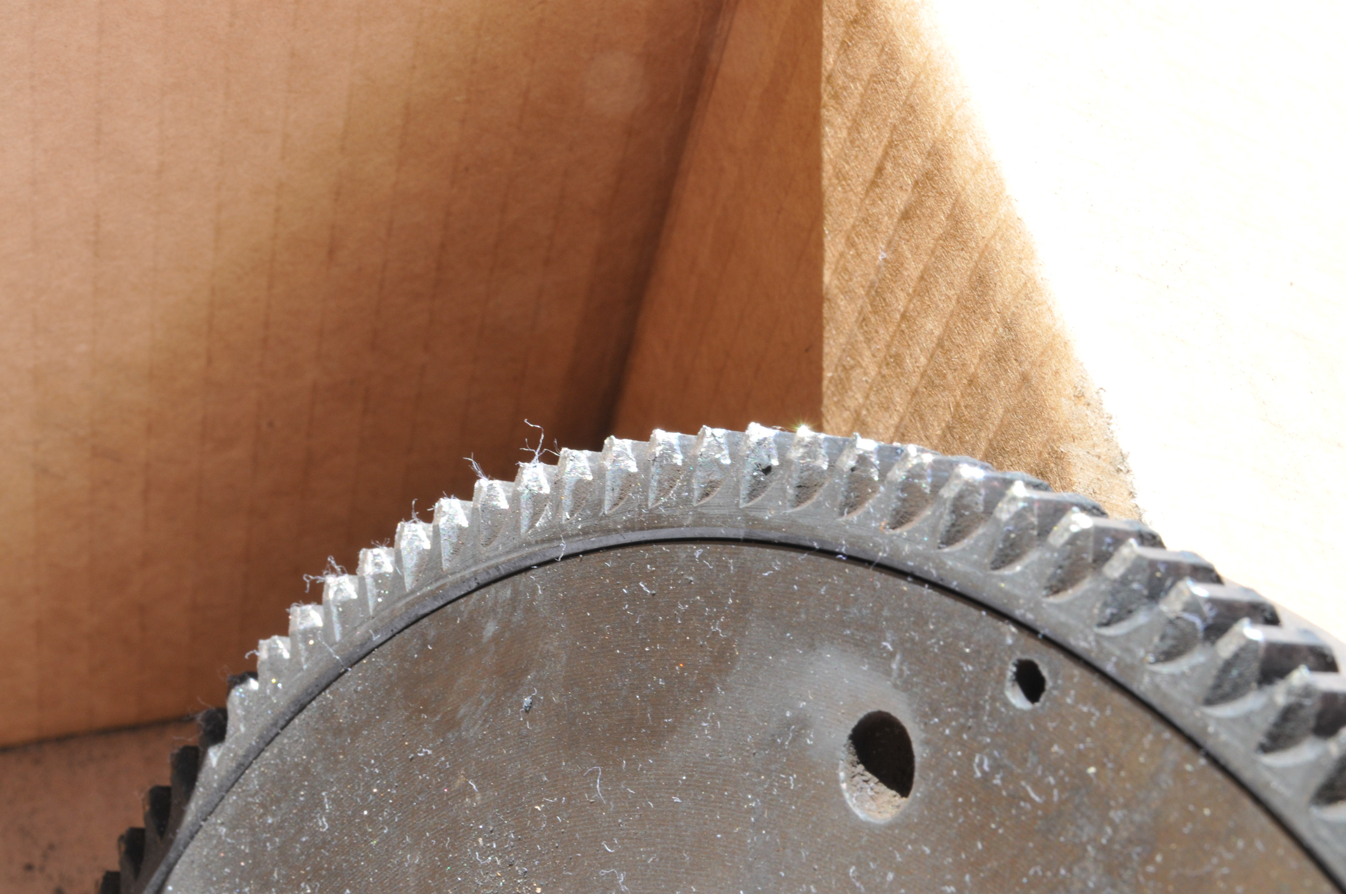

I seem to be having a similar problem. I removed the flywheel to replace an aging rear main seal and noticed me (new) E.I starter gear badly worn. So I inspected the ring gear (photo attached) and it appears to have freshly worn teeth. As much as I have been working on this truck, I doubt I have 100 starts with the starter motor. I'll call Scott to discuss.
