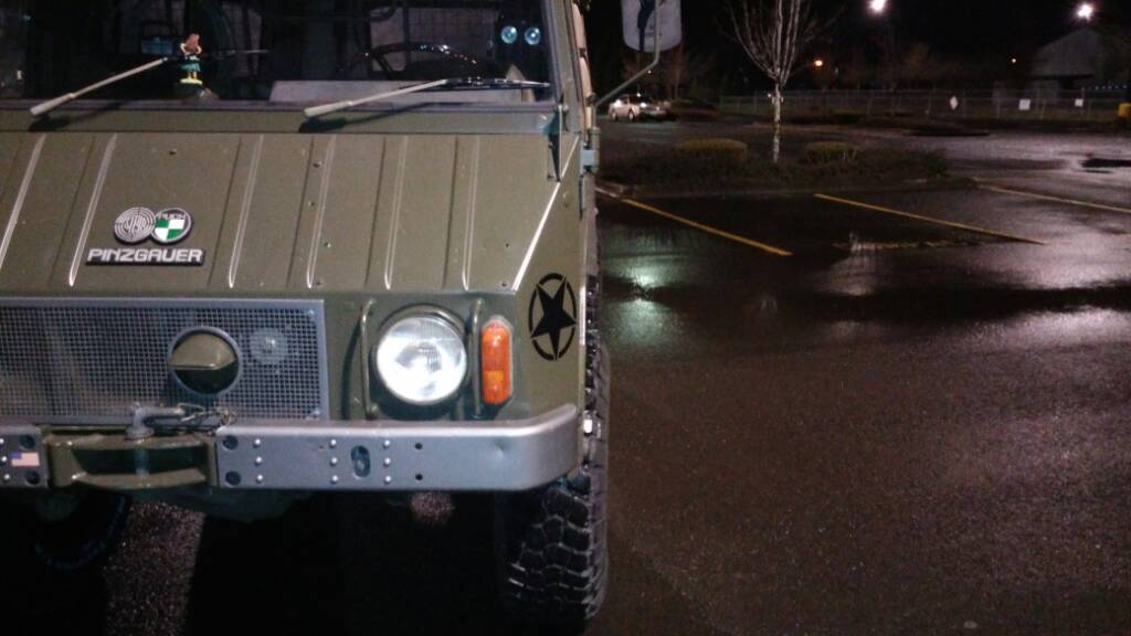

Curious also to see how far out the wheels are with the TrailReady's on.

Looks great - You'll probably get some spray on the sides...

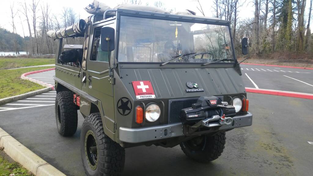

I think perhaps that most of the distance outward is just from the tires and rims - here is a picture of another 710M with the Trail Ready wheels and 285/75-17s BFG MTs on them (I think they are the same...) Maybe they look a little bit farther in than the same wheels on GadgetFreak's 710M?

I'm running 285's on 8" wheels, I think I am just at the edge of being OK, but just barely.
By the looks of the disk brake conversion -- rotor position vs drum position, eyeballing it,
looks like it is adding up to 1" to 2" of additional mounting/track width per side.

All good feedback. The Disc Brakes definitely add to the width, the additional back spacing added to the rims to afford a little more clearance for the brakes exacerbated that..
I am working on a set of revised rub rails that will incorporate some additional wheel coverage, which will help. Additionally I will primarily be using it for Search & Rescue on active missions so am unlikely to get much grief for minor infractions. We'll see... :wink:
