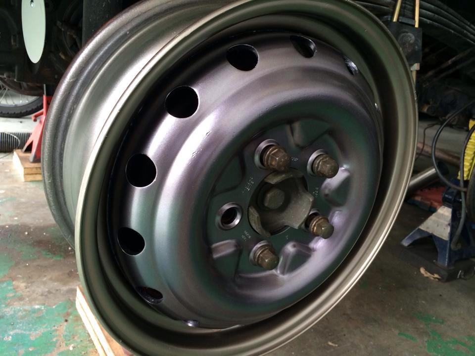

Yes - the wheel flange (Item #6) is not modified. The custom disc has just enough room for the friction surface to work as long as the wheel has a larger inner diameter than the original stock wheels. The key is the disc being flat and not having a "hat" shaped profile like a typical brake disc. The flat shape also provides enough room for the caliper behind the disc to not require modification of the aluminum casting which serves as the backing plate of the drum brakes.
No machining of the stock Pinzgauer parts was the goal. There are a lot of small details to the exact shape and dimensions of the brake disc which I have not detailed here as it is quite complex to explain without detailed drawings - but the bottom line is I got it to fit with the 16 inch Sprinter wheels. Hopefully, it will work in the USA transit wheel and probably in the European transit wheels as well - and probably will use a thinner, cheaper spacer instead of the more expensive "adapter/spacer" I used for the transit wheel. Longer lug bolts may be required though.
Its worth noting that Sprinters in Europe come typically with 15 inch wheels - so that isn't probably a good option in Europe then. G-wagen steel wheels or the real TD Pinz steel wheels would be the best option there - they have a bulge in the outer section of the wheel center to give extra clearance for the caliper. But, since they are 5x130, they would require a wheel adapter to be used.
