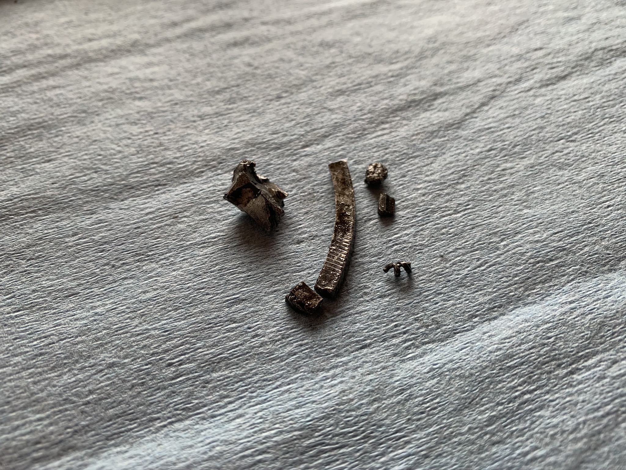

Well,
Whatever success I've had was short-lived. I had a few spare minutes today, so I dropped the oil.
Battleship sunk...
Re: Sitting 4+ years, checklist for resurrection...
Posted: Thu Mar 05, 2020 1:28 pm
by Texas710
Well... Crap.
Posted: Thu Mar 05, 2020 1:39 pm
by rmel
Well off with the oil pan.
Posted: Thu Mar 05, 2020 1:55 pm
by rmel
It looks like fragments of a zip tie? Or are these metal bits. Still does the tranny seem frozen. Maybe the junk in the pan is not a sign of a handgernad going off
Posted: Thu Mar 05, 2020 4:50 pm
by Get2work
rmel wrote:It looks like fragments of a zip tie? Or are these metal bits. Still does the tranny seem frozen. Maybe the junk in the pan is not a sign of a handgernad going off
Definitely chunks of metal. I played around with the linkage a little bit and don’t think anything is malfunctioning there.
Going to have to drop the pan next and see if I can get more of the story.
