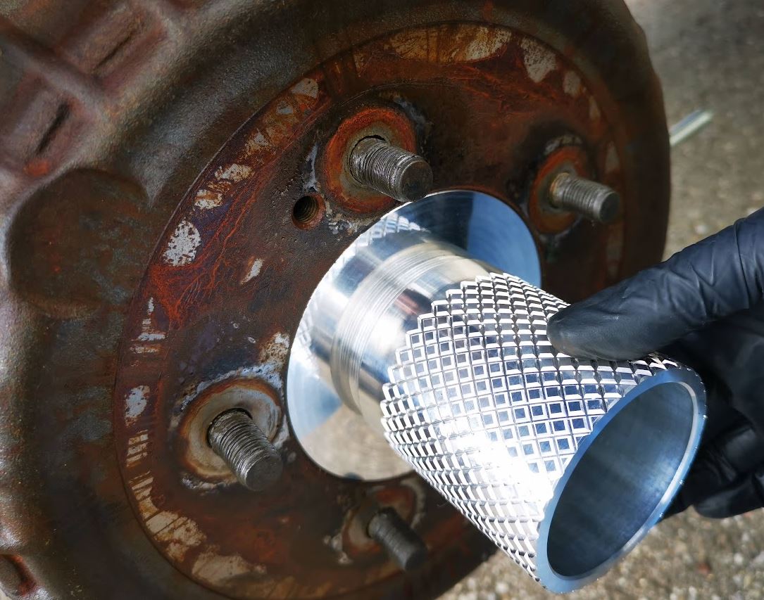

I can make some up as shown above for $100 a pair plus shipping. If anyone is interested at that price I will get some material on order.

Can you share the dimensions, here on forum or by private message if you prefer,
so i can check they will fit my wheels.

Here you go.

ok I'm in for a pair,
i'll contact you by PM for payment

I have material on order for a few sets so let me get one set made up, have Hugues test them out and we can go from there.

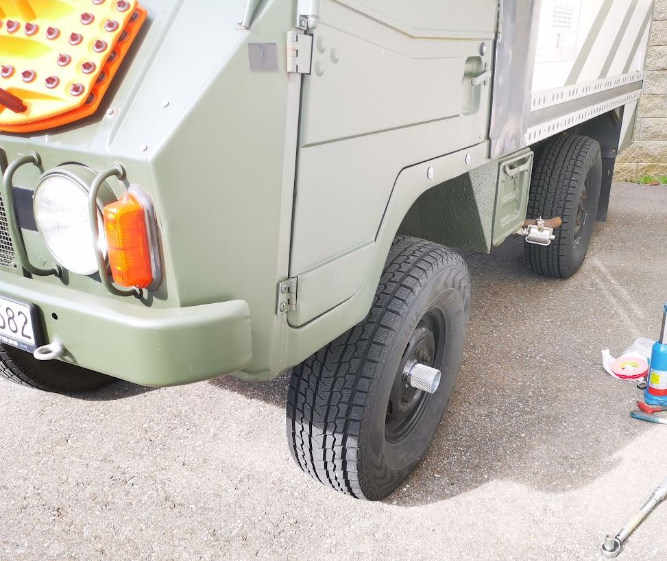

Got my hub steps from @compunerdy :D
Pretty good quality, nice finish,
The fit is excellent, the disk fits nicely inside the drum's central flange,
I put some loctite to secure the hub in place,
thanks a lot !
