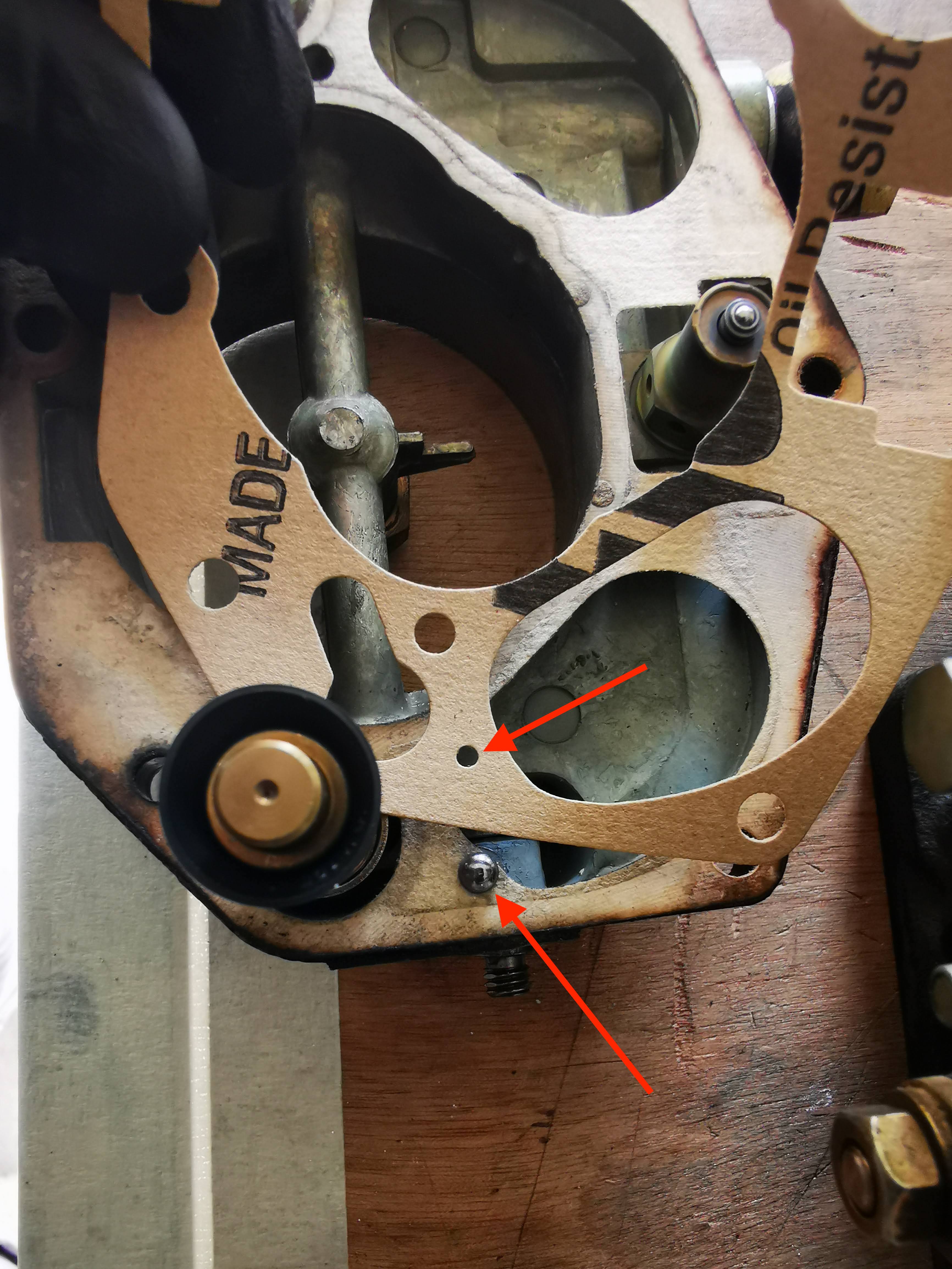

and these seems to be rivets that hold the gasket in place
but the hole in the new gasket is much smaller than the rivet's head.
Do i need to pop the rivet out with a blade first then put it back ?

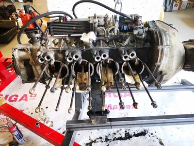

Well, all heads, cylinders and pistons are out.
Apart from the broken compression ring, I didn't see any obvious damage, but I would need to measure the parts.
Now how do I remove these long bolts? They are quite stiff, I don't want to break them into the crankcase.
But I think it's better to remove them so I can better clean the surface that received the cylinder?
I think I will use 2 nuts held together? I sprayed WD40 at their base, but....
Should I apply heat around the bolt on the crankcase if necessary?
Can I use an impact drill? Or just manually?

The the long cylinder bolts should be removed.
Double nuts work sometimes. I have used Visegrips
on the shaft close to the base -- use two to increase
surface ares to minimize marring. A plumbers
wrench can also be used.
When you put them back make sure you put the FLAT
surfaced end into the block -- the ends are different.

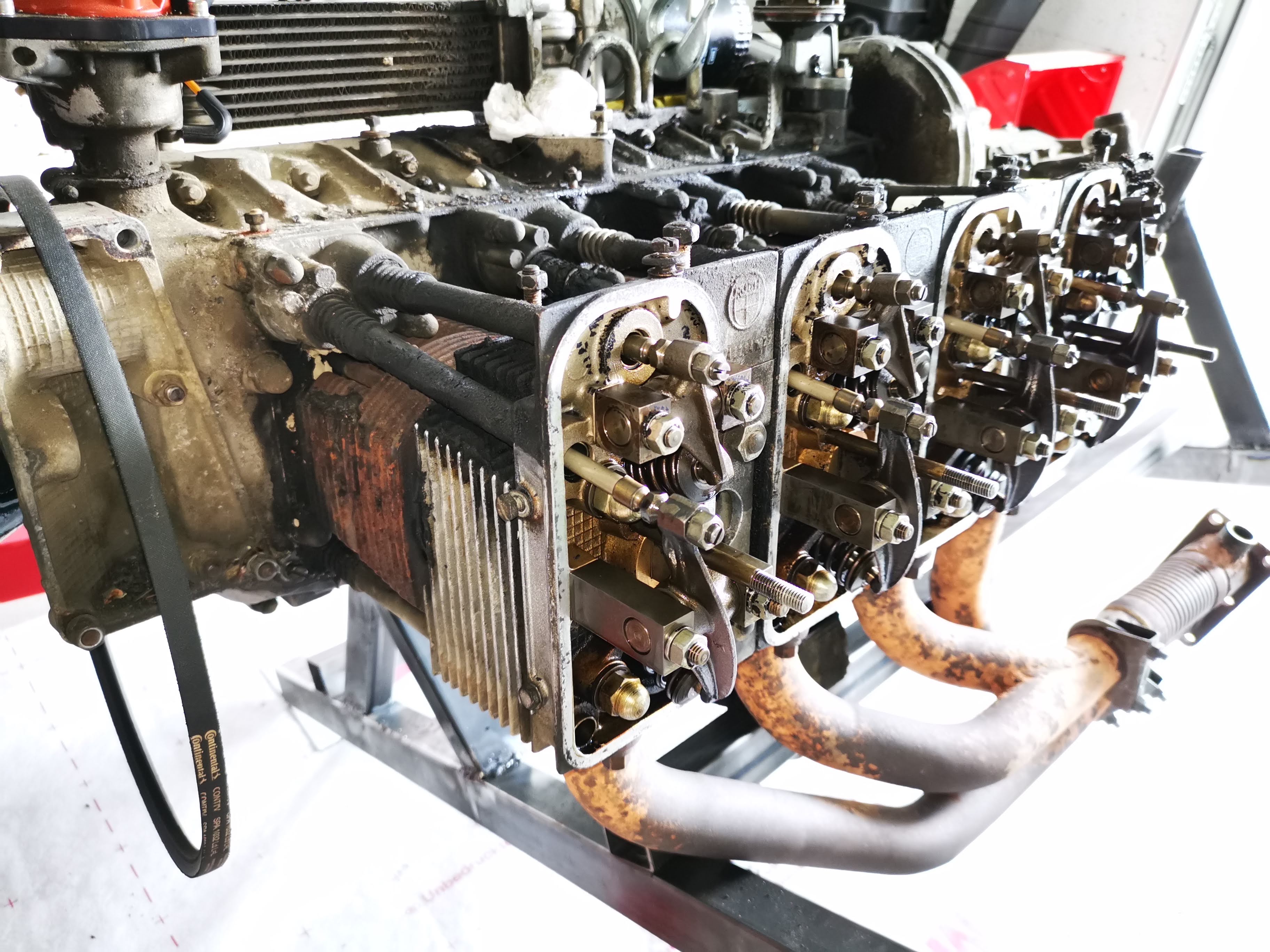

So just test fitting the parts today, lubricated but no sealant.
I'm a little stuck when it comes to push the head completely against the cylinder,
as shown in this video:
any guidance appreciated, i don't want to force anything and break stuff,
https://www.youtube.com/watch?v=lyU3xjRpWiE

Spring force wants to keep the head/cylinder apart.
But there also could be burs on the head side preventing seating.
These are new heads I believe so they were machined and never
mated to a head -- unless hand lapping was performed which
would help to remove any burs or fit fit. Even new out of the
box lapping is necessary for a tight fit and again to open up the
mating surfaces.

I managed to install pistons, cylinder and heads for #4, #3 and #2 today, without sealant, indeed it was the springs holding up.
I did lap the cylinder on a flat surface, and the cylinder with the head. I posted about this in the VW forum, while I could not post to the forum here some weeks ago for some technical issue.
https://www.thesamba.com/vw/forum/viewt ... 9#10259899
Tomorrow I will install #1 and test for the air intakes and exhaust.
