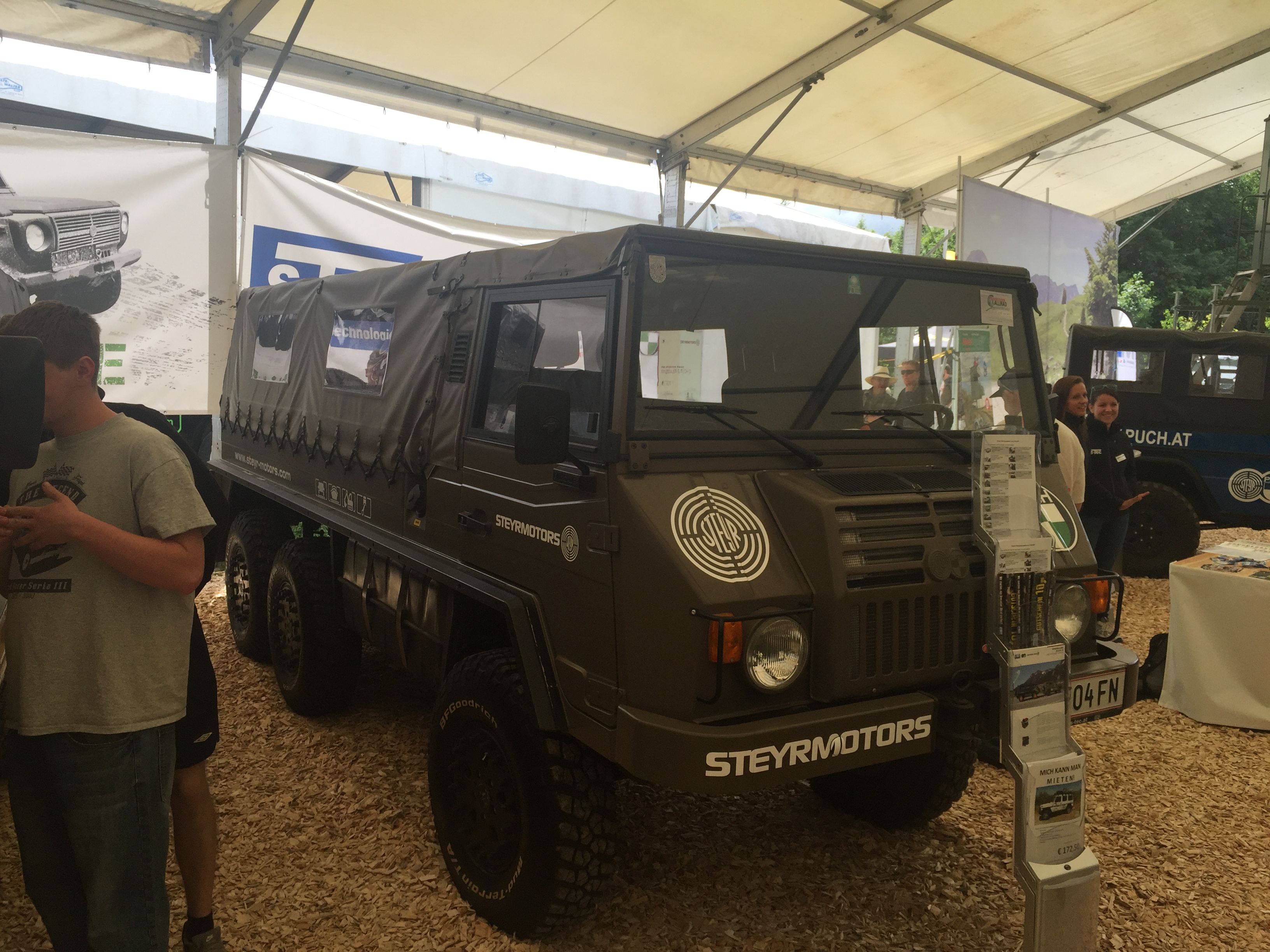

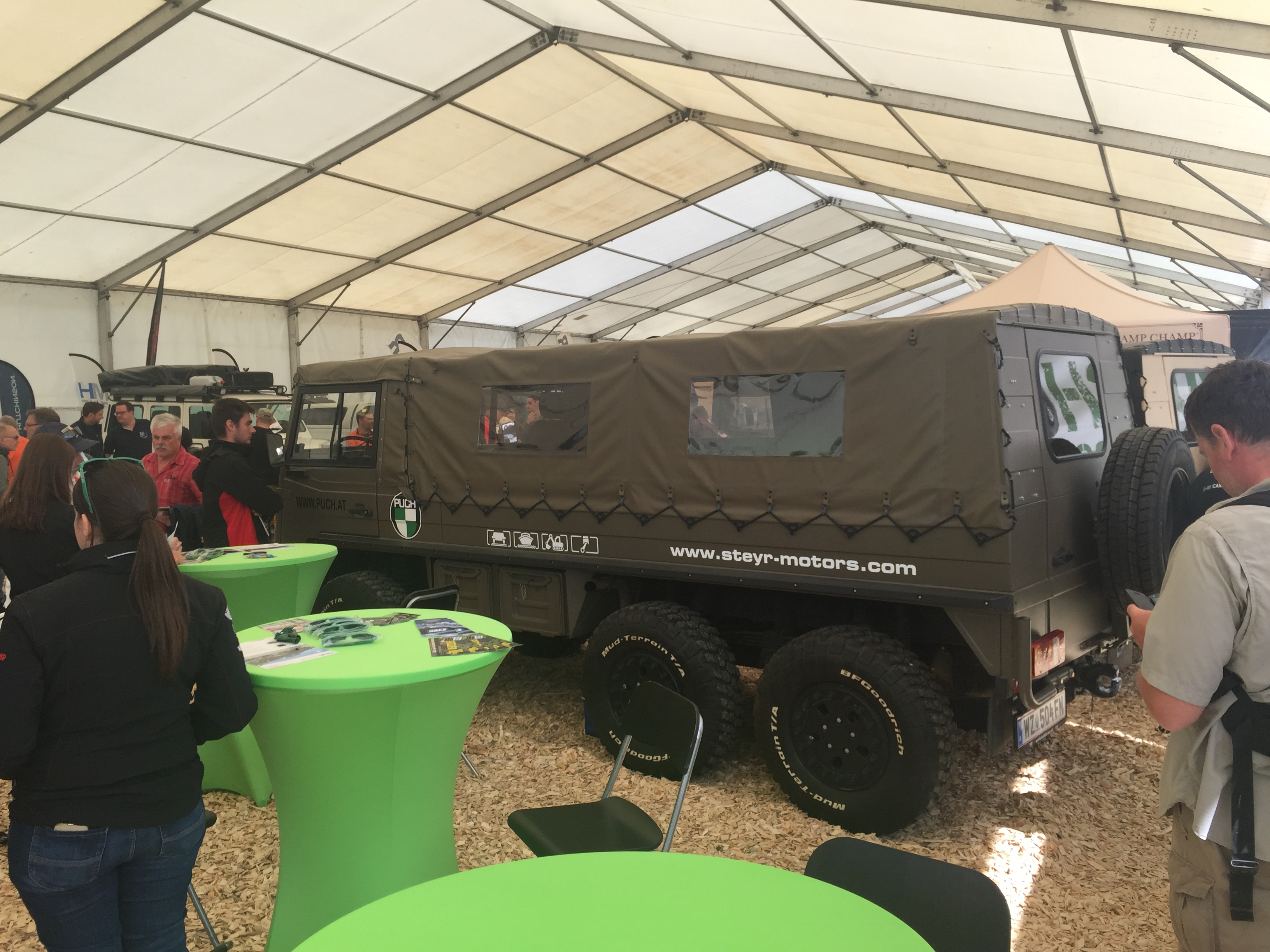

The S-Tec guys have a booth at Allrad in Germany this weekend and they had some nice re-engine examples on display. Lighting was difficult but photo is not a 718 but a reworked 712M with there diesel.
Scott

Did you notice which side of the central tube the transfer case input was? The original right side of the 710/12 or the left where the TD is?
The 712 high range is a little higher than the TD's, but the TD has a lot lower low range.
With the 712 being 8" shorter in the wheelbase and cab length than a 718, I'm curious to what trans was used and if the cardon shaft was was even shorter.

Those are all excellent questions and well thought out and I did not even bother to look since it will never see the shores of the USA. More business related items to discuss with S-Tec and lots to see. When you mention EPA they just laugh. I am sure they will have some details in the future. They also had a nice re-powered Puch 230GE.
Maybe next time in Graz we might have a chance of driving on of them and climbing underneath. Still not something your are going to see one the shores of the US.

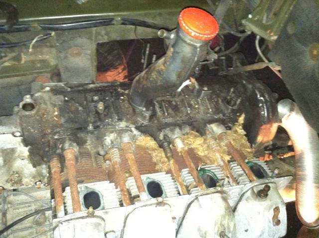

Right now we are running our own engine program for people who can't check their oil, rev their motors too high for too long or can't keep rodents from building nests under the engine tin on top of cylinder #4. Will see what magic can be resurrected from these units.
Scott

Rats nest you say?
Never heard of that ;)
