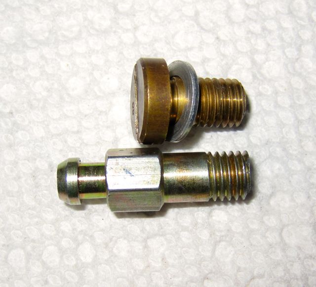

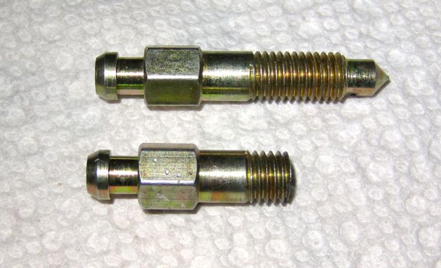

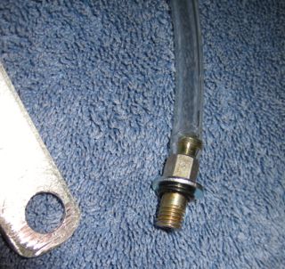

I'm still working with them to make sure they'll fit ok. I had to cut them a little shorter cause the threaded area was too long.
I found some clear tubing easily enough but I'm still looking for a seal washer. Could re-use the one on the jet I suppose.

pcolette wrote:I found some clear tubing easily enough but I'm still looking for a seal washer. Could re-use the one on the jet I suppose.
I would think a plain aluminum or steel washer followed by an “O” ring would work well.

When you mentioned what size yours were, I thought the M7x1x34 may be too short, but since you cut so much off, mine might be just right.

I did find 7mm steel washers today so just need a gas-proof o-ring to go with it. McMaster has some so Tuesday I should have it complete.

:idea: May be able to just slice 1 or 2 mm off that clear tubing and use that in place of an "O" ring till you can get an "O" ring.

edzz wrote::idea: May be able to just slice 1 or 2 mm off that clear tubing and use that in place of an "O" ring till you can get an "O" ring.
Excellent idea - thanks!

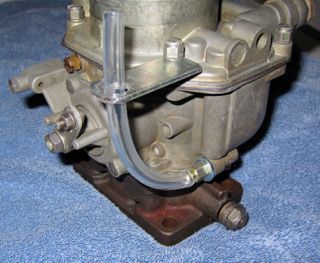

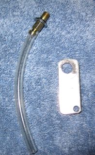

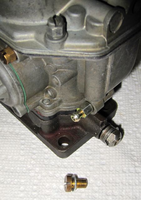

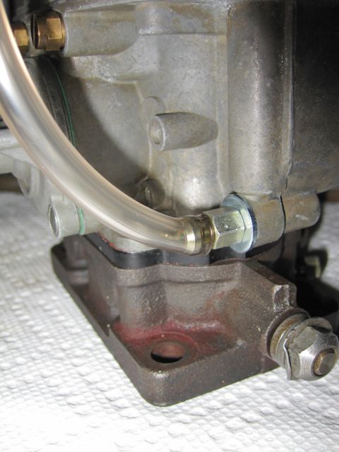

I finally found some time to finish this up. Turned out okay and for about $4 in parts it's a nice solution.
I've got 8 bleeder screws left over, so if TechMOGogy, djw, audiocontr and kpoling are still interested, send me your addresses and I'll mail a couple to each of you.
