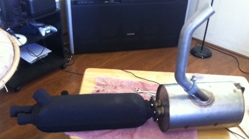

Stainless steel is really pretty. I was worried it would detract from from the Pinz's inherent beauty.

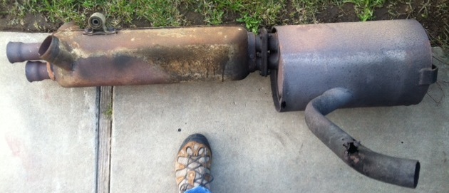

Six 41 year old bolts between the heat exchanger and the muffler... Sheared all of them off with an air wrench. Had to cut out the middle two. Removed rust and patched the holes on the heat exchanger.
Bolted it all together, installed it and started the beast. It has a different sound. Of course, it would since it is missing the three large rust holes and caved in rear wall. It is a good sound. More important, it runs much better.
The stainless gets a little less silver with a couple of drives. But, be careful, that tailpipe gets boiling hot after a drive. The kids now exit on the starboard side just to be safe.

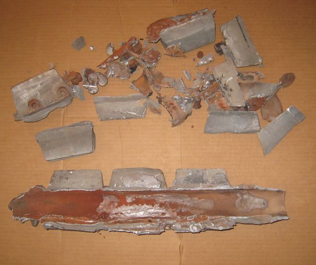

A few years ago I bought a 710 that had had the heat exchanger get so hot it melted the aluminum fins inside it and some had pooled into a solid mass at the bottom. I did get the Pinz running nicely after a while but there was no saving the heat exchanger.
