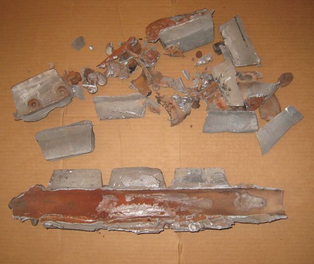

A few years ago I bought a 710 that had had the heat exchanger get so hot it melted the aluminum fins inside it and some had pooled into a solid mass at the bottom. I did get the Pinz running nicely after a while but there was no saving the heat exchanger.
Probably not the norm :wink:
