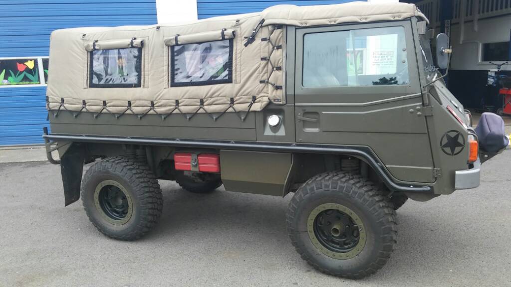

Thanks Undy where as most of these are 40 years old and worn, mine is in really decent cup/rust free shape and the truck is driven daily. Having it torn down and inop for " be patient" isn't an option at this time. I will tear into it today and get it lifted back up after winch installed.

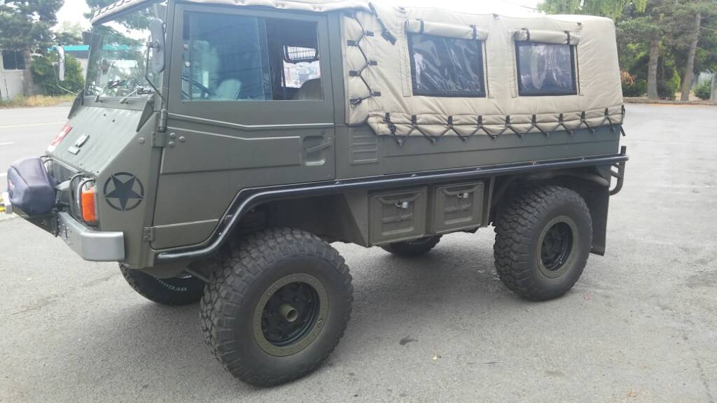

Just finished. Sits 1/4 higher than the rear but with my wife or a buddy in it 400 lbs plus and light gear out back it should be fine. I have alot of material to machine if needed to drop it down a little. Limit straps and shocks have plenty of travel and all of my pins, cups and spacers look new. Zero rust or pitting. Maybe the 6,400 km is correct?
