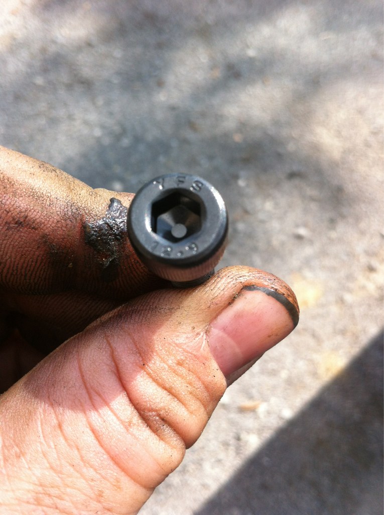

pcolette wrote:I found it interesting that 3 of your 5 retainer bolts were allen socket head vs hex head. When I ordered them from SAV recently for a repair/upgrade it showed all 5 were hex head and that's what I got. I wonder why a previous owner/mechanic would have used socket head - any thoughts?
Interesting....could it be that sourcing the hardened bolts in a socket head was harder? Which is the original? I picked up some 12.9 as the replacements.
Replacement bolts...

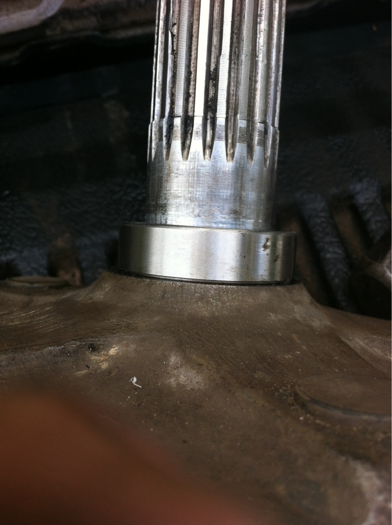

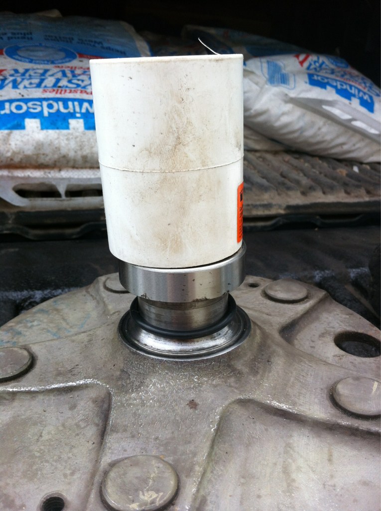

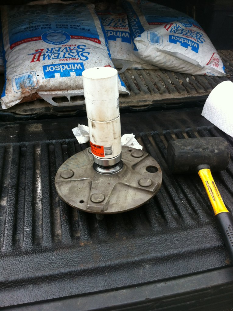

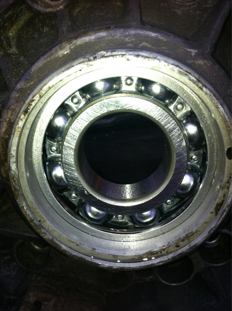

Thanks Paul. Eventually got them out. I decided to replace the 6308 bearings while I have it apart, so that will delay the repair somewhat.

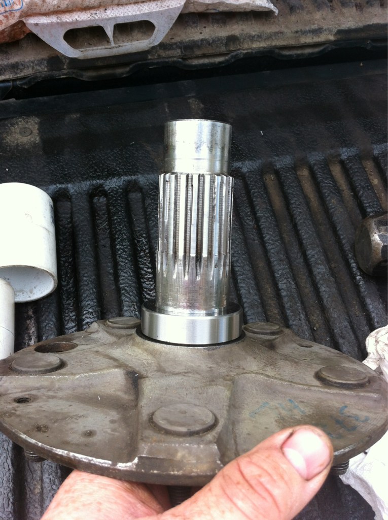

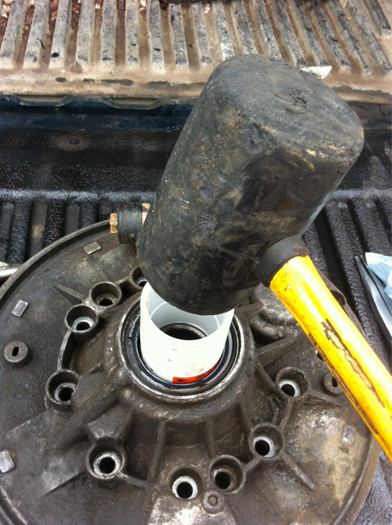

After removing the retaining ring, I used a piece of PVC I had laying around to remove the bearing. I am not a fan of removing a bearing using the inner race, but since EI did it.... :D . It didn't take much and I used a rubber mallet.

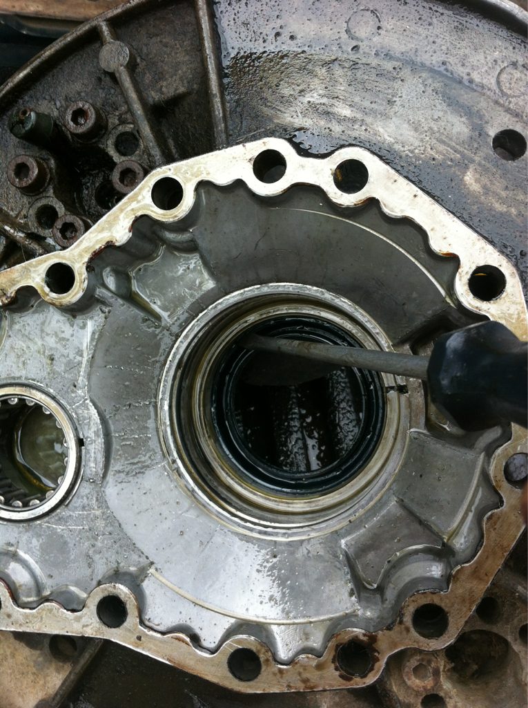

Now to remove the seal. I used a flat head screw driver to knock it out from inside, then pulled it out.
I am now just cleaning everything up in prep for reassembly....once I get some new bearings.
By the way, ever wonder where that weep hole on the back plate originates?

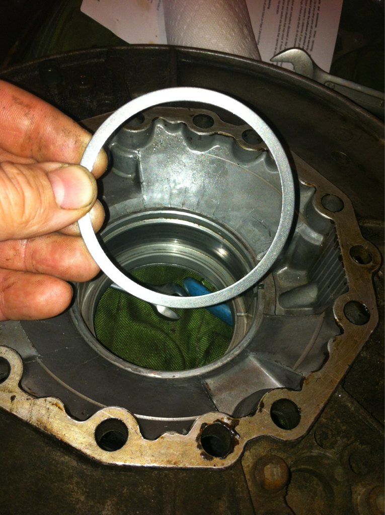

Not much more I can do today, but I decided to install the spacer/wear rings and o-rings. My PVC came in handy again.
The rings are not completely flush with the base, no matter the pounding. I did see Scott's install had a similar gap. Should these be flush? Don't be shy, jump in if you know! :D
Mine (both are the same). Seems necessary to remove using the chisel...
I assume there's a bit of space to allow the o-ring below it to compress some.
The weep hole is there to allow gear lube that may get by the seal to get out of the brake area without contaminating the brake parts. So sayeth pcolette per Willy at SAV...

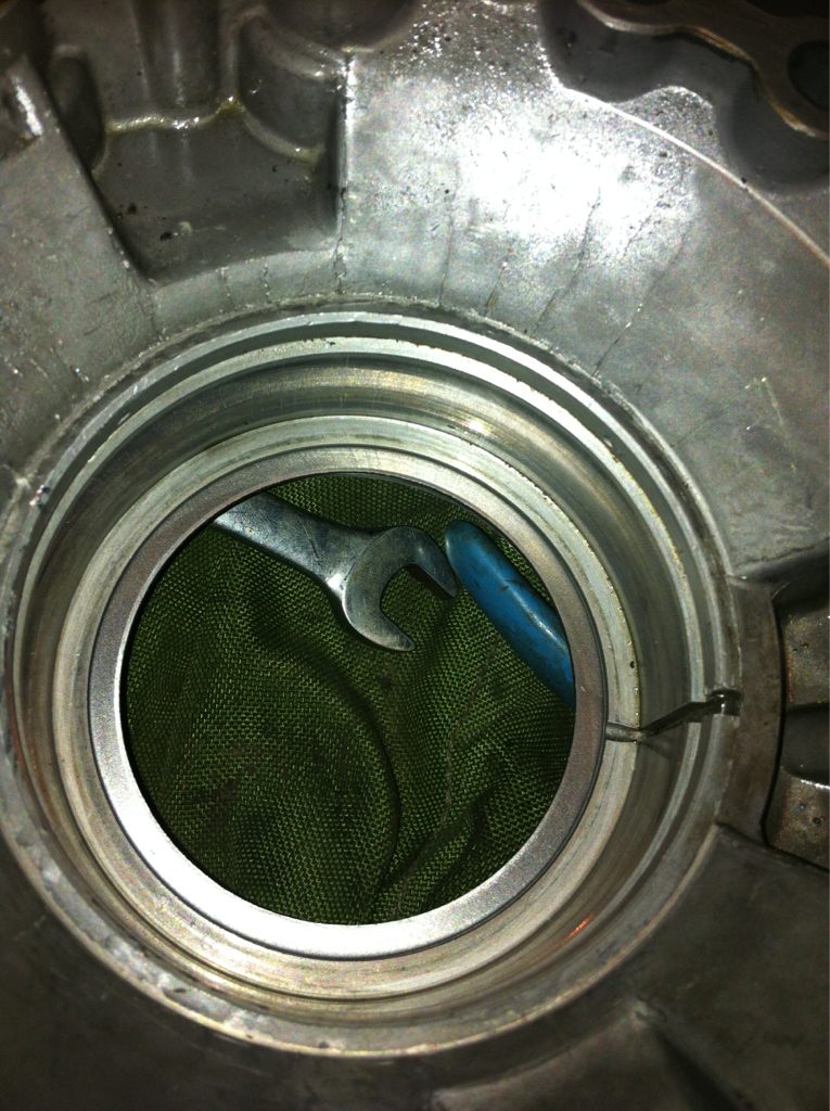

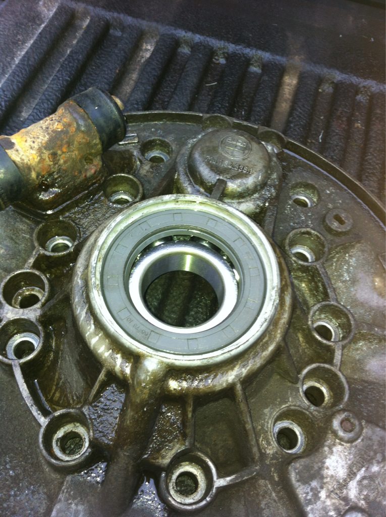

So, I placed the bearings in the freezer for a few hours this afternoon, and installed them this evening. I placed the steel ring in the bottom and lightly tapped the bearing down using a brass punch (only using the outer race.
I pressed in the seal, but I may have jumped the gun.
I placed the snap ring in, but it won't slip into the groove fully. When I inserted the bearing, it felt like it went all the way...different feel to the tapping, but I am not certain. The snap ring is just a hair high....
Hopefully I can press it in further.
