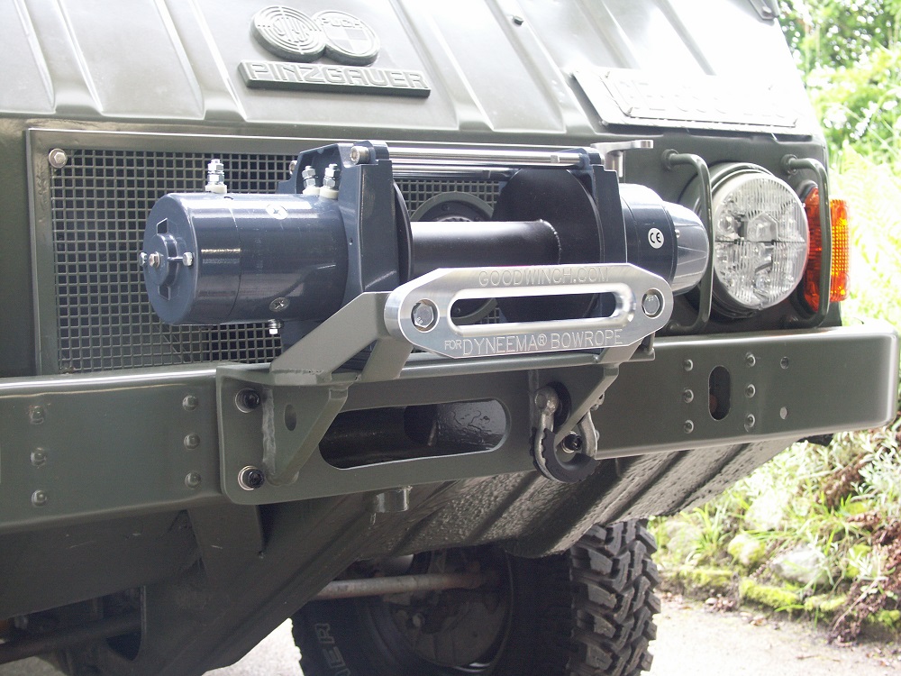

What sort of mount did you use? A custom bumber or plate that goes into the front pin?Mead wrote:I bought one from Scott and have been extremely pleased with it.Just clicked on that link, Scott's prices are very reasonable. That 9500 lb unit is very tempting for the price.
Re: 12v winch

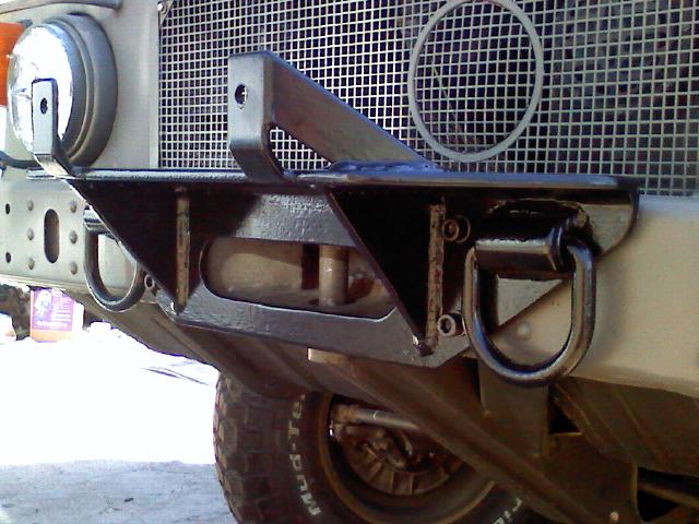

one of these can be had for under $500
This one runs a bit more as it was made to accept a larger winch drum and that 3/4" gusset material gets pricy.

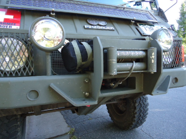

I got my 9500 from Scott and the bumper as well.
edit: I had the hole cut and plates welded in by a metal shop so I could still use the pin that is already on the pinz. Had to cut off the tab that holds it in place so it could lift straight up, the chain keeps it there and it is heavy enough that it has never moved. I also use it to secure the hook at the end of the winch cable.
