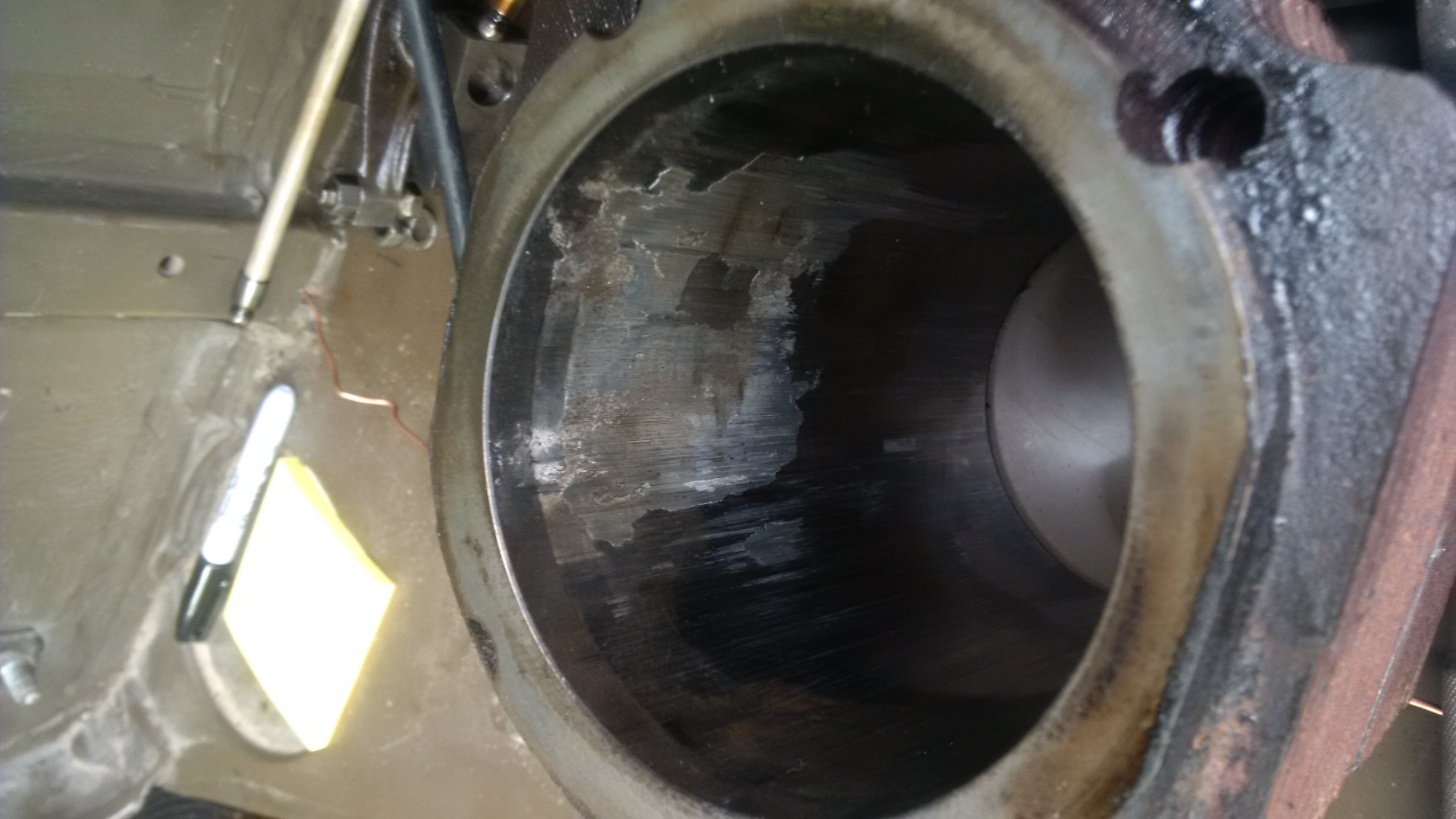

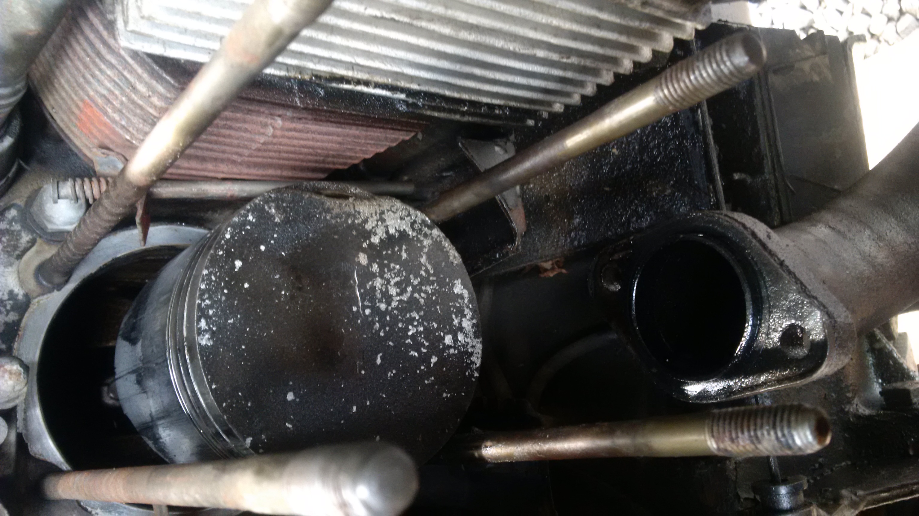

ok, so as previously mentioned, the second cylinder from the front was 0 on the compression test. We put some compressed air in there and had a lot of bypass coming out the oil filler tube and nowhere else. Pulled the head and cylinder and voila! A nicely F'd piston.
So, when replacing the piston and cylinder (I know I can hone the cylinder, but for arguments sake, lets say I'm replacing both), does it matter if I use a 92MM, 92.5mm or 93mm, as long as the piston and cylinder match? Do I need to match them to the remaining 3?
tx Dave
tx Dave

Here are the pics of the culprit
- pinz cylinder bad.jpg (741.58 KiB) Viewed 6771 times
- Pinz piston bad.jpg (966.25 KiB) Viewed 6771 times

Also, I'm guessing that I need to buy a tool to remove the piston, is there are common variant?

I wonder what would cause a failure like that? Did a part of the piston break off and hammer the cylinder?
You should go with the same size piston and cylinder as stock to keep the engine in balance. The piston/rings and rod assemblies should all weigh the same, so if you go with 92.5 or 93 mm pistons you could have vibration problems or bearing failure eventually.
- Posts: 776
Re: Big smoke, big oil mess, big problem! Advice/confirmati
Thanks, yes, I've established that I need 92mm and have ordered that. As for cause, still trying to figure that one out. looks like the piece of the piston did detonate, not sure the cause. Valves are all good, so heat is likely not the issue. Oil is fresh and in good supply. :?: :?: :?:

No special tools to remove the piston. Just remove the retainer and slide the pin out, you will have to remove the #1 piston to remove the bad #2 piston. If the pin is stuck, use a nut and long bolt through the pin and pull it out.
- Posts: 776
Thanks Jim, I was wondering if I had to remove any other pistons. A great help as always!Jim LaGuardia wrote:No special tools to remove the piston. Just remove the retainer and slide the pin out, you will have to remove the #1 piston to remove the bad #2 piston. If the pin is stuck, use a nut and long bolt through the pin and pull it out.
