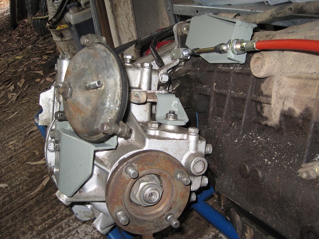

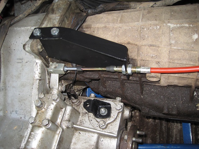

Spent some time on the transfer case shift mechanism, which needs to be a unique set-up for obvious reasons.
Diff lock actuation uses the standard Volvo vacuum actuator, which has an internal spring to return when no vacuum is available. This set up means that the diff will be locked when the engine is off, and open when a vacuum is applied - similar principle to the original Volvo set up. It also means that under heavy braking, a pressure switch in the brake circuit switches off the vacuum causing the diff to lock and preventing either front or rear wheels locking independantly. This is how the part time transfer case worked, and I hope the LT230 is strong enough for...
Appears to function so far, but have yet to try with a vacuum.
High/Low range is to be actuated by the bowden cable, with a yet to be decided lever in the cab.
- Shift mechanisms 1.jpg (153.62 KiB) Viewed 9221 times
- Shift mechanisms 3.jpg (136.49 KiB) Viewed 9221 times
- Shift mechanisms 4.jpg (135.8 KiB) Viewed 9221 times
- Shift mechanisms 5.jpg (156.57 KiB) Viewed 9221 times

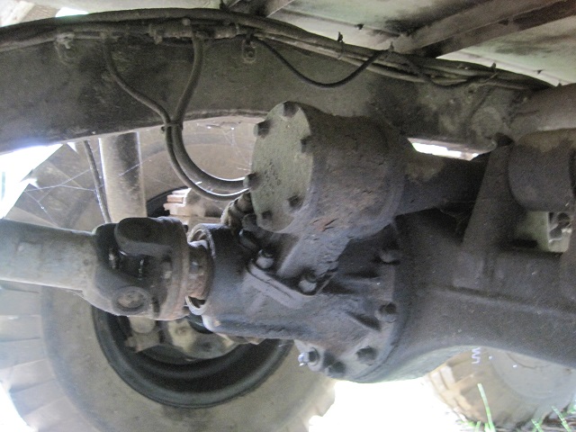

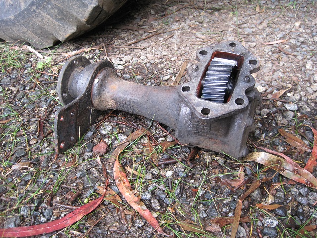

1st rear axle has a PTO taken from the input pinion and driven over the top of the axle to the 2nd rear axle.
No differential action between the two - fixed drive.

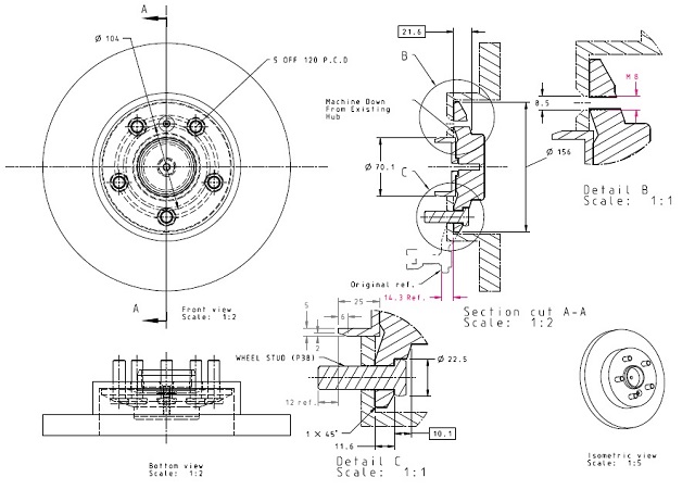

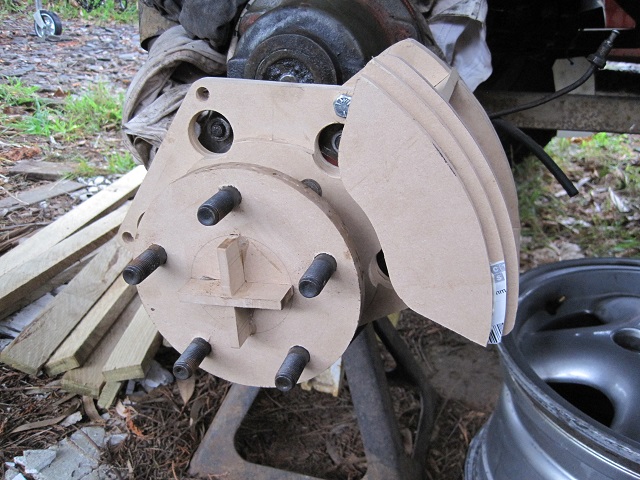

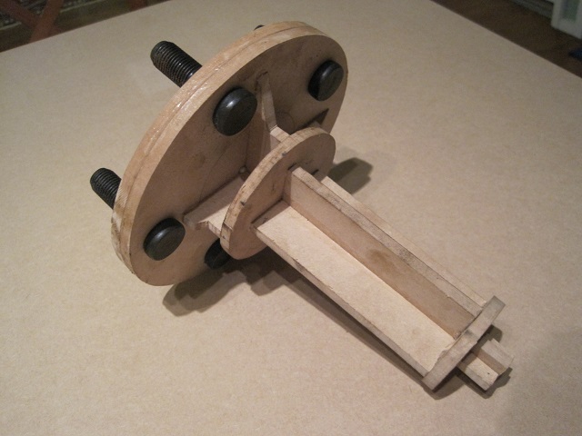

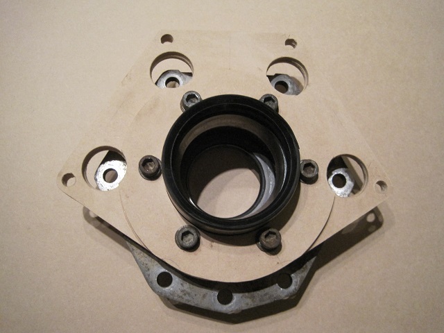

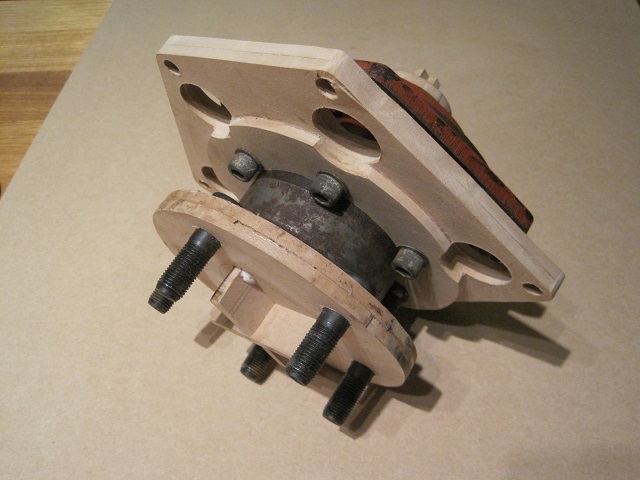

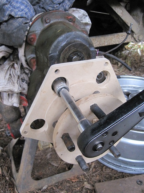

Progress on the disc conversion is slow, but there has been some. Hub has been scanned and converted in Catia. I had a friend model up a re-machined hub using Range Rover P38/Disco 2 discs. This part looks pretty promising.
Using the standard 8x16 wheels to suit 315/75R16s, the track increase is just 13.7mm/side vs an Austalian registration requirement of 25mm max.
I bought a full set of calipers from a Disco (plan is for 2x twin front and 1xsingle/rear axle), but cannot make them fit.
After some searching around I think I can get the Wilwood calipers to fit, but still trying to get some more detailed information on them as they will get pretty close to the wheels - approx 3mm clear at best estimate. This is using the 25mm thick front vented discs from a Range Rover.
The rear discs will be solid, and will have to be machined down to the same dia as the fronts otherwide the calipers will scrape the inside of the rim...
It is proving to be a delicate balancing act...
- New Hub.jpg (85.6 KiB) Viewed 8853 times
- Caliper Mounting Bracket.jpg (91.81 KiB) Viewed 8853 times
- Hub assembly.jpg (91.39 KiB) Viewed 8853 times
- Tool Access.jpg (152.6 KiB) Viewed 8853 times
- Disc Conversion.jpg (146.65 KiB) Viewed 8853 times

Plus hub drawing for reference.

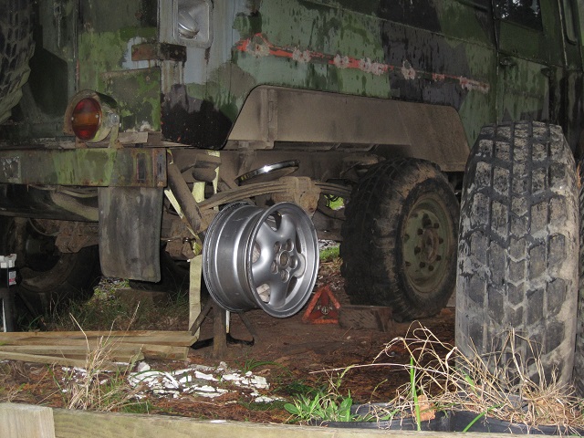

And the "pimp my ride" rims...
- Machined Hub Drawing.jpg (77.85 KiB) Viewed 8854 times
- New Wheels.jpg (153.88 KiB) Viewed 8854 times
