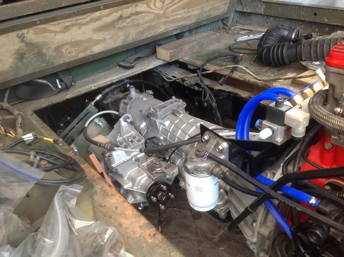

After having spent many weekends, and still going, clearing up the garden after we had three trees taken down (which including having to move the Volvo off the drive on 5 wheels :shock: - from under one of the trees ).
Spent some time on the transfer case shift mechanism, which needs to be a unique set-up for obvious reasons.
Diff lock actuation uses the standard Volvo vacuum actuator, which has an internal spring to return when no vacuum is available. This set up means that the diff will be locked when the engine is off, and open when a vacuum is applied - similar principle to the original Volvo set up. It also means that under heavy braking, a pressure switch in the brake circuit switches off the vacuum causing the diff to lock and preventing either front or rear wheels locking independantly. This is how the part time transfer case worked, and I hope the LT230 is strong enough for...
Appears to function so far, but have yet to try with a vacuum. :D
High/Low range is to be actuated by the bowden cable, with a yet to be decided lever in the cab.

The LT230 will be plenty strong as it is noted as being one of the strongest OEM transfer cases in the business.
I am not sure why the original system in the Volvo and the one you have retrofitted here having the CDL auto vacuum locking is the way to go as it seems a bit of a backward step - I guess the braking system is very basic with no proportioning valve system in the brakes to ensure brakes do not lock independently - even with the system you have, unless the axle diff locks are locked, individual wheels will still be able to lock.
My 101 has a manually vacuum locked centre diff lock and I have never had an issue but these are problematic with vacuum issues either diaphrams failing or vacuum leaks and in your case you could be driving on the bitumin with the diff lock activated causing transmission windup. Many older Landy vacuum diff lock systems have been upgraded to purely manual system that the LT230 originally had.

A good point, and one which I have experience of too... when I first got this truck, the vacuum diaphram was a little perished. It took quite some time to figure out...
In this version, I now have a warning lamp that will tell me if the diff is locked. So at least I'll be able to see the failure (which reminds me - need to add this new lamp somewhere).
The main reason for going this route is to avoid issues with compliance to the "engineering code for modification" when it gets the disc conversion. This requires all commercial vehicles (like mine) to have a load proportioning valve, but mine was original engineered (VIC) without, and by carrying across the same functionality, I am hoping I do not need to add.
If I do, with twin axles on a loadsharing pivot with dual brake circuits, I think I need 4 load proportioning valves... :shock:
