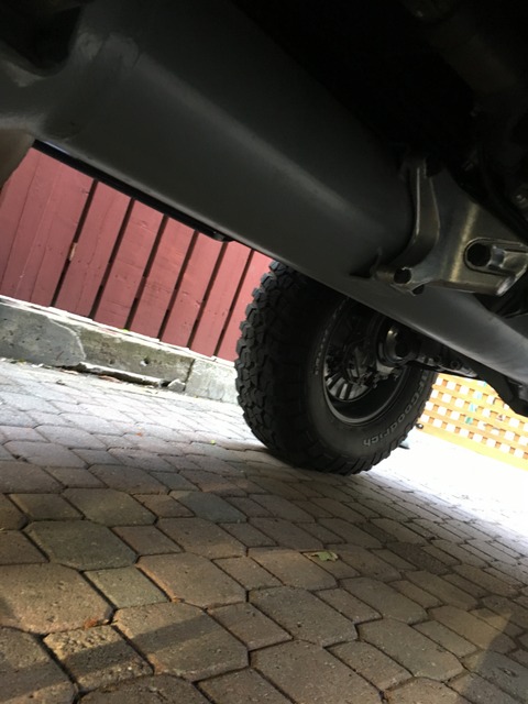

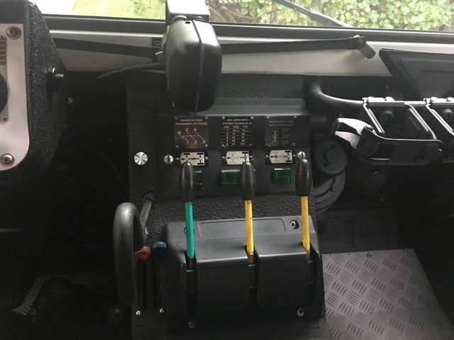

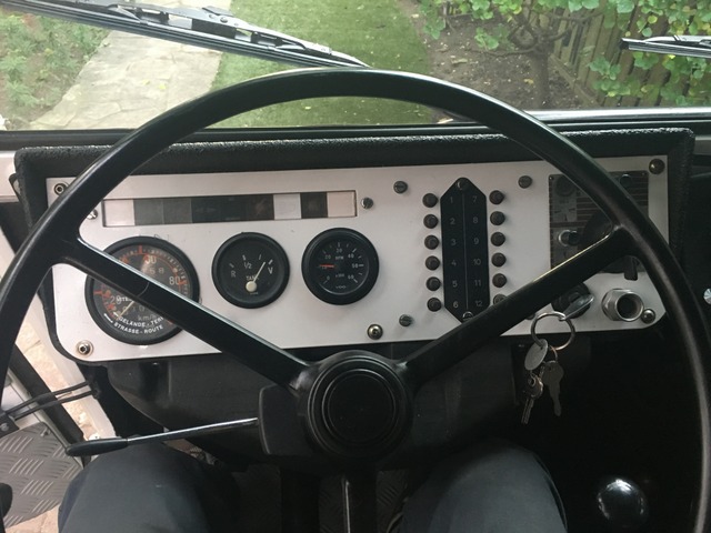

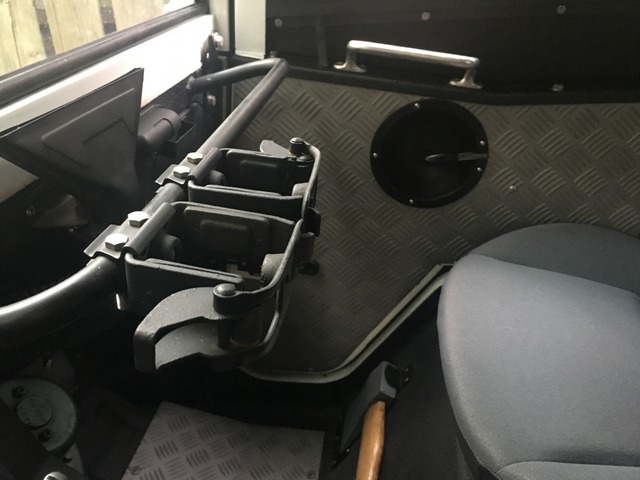

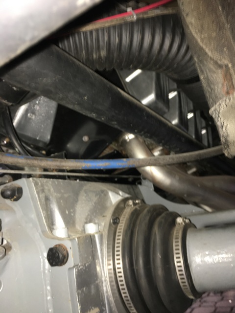

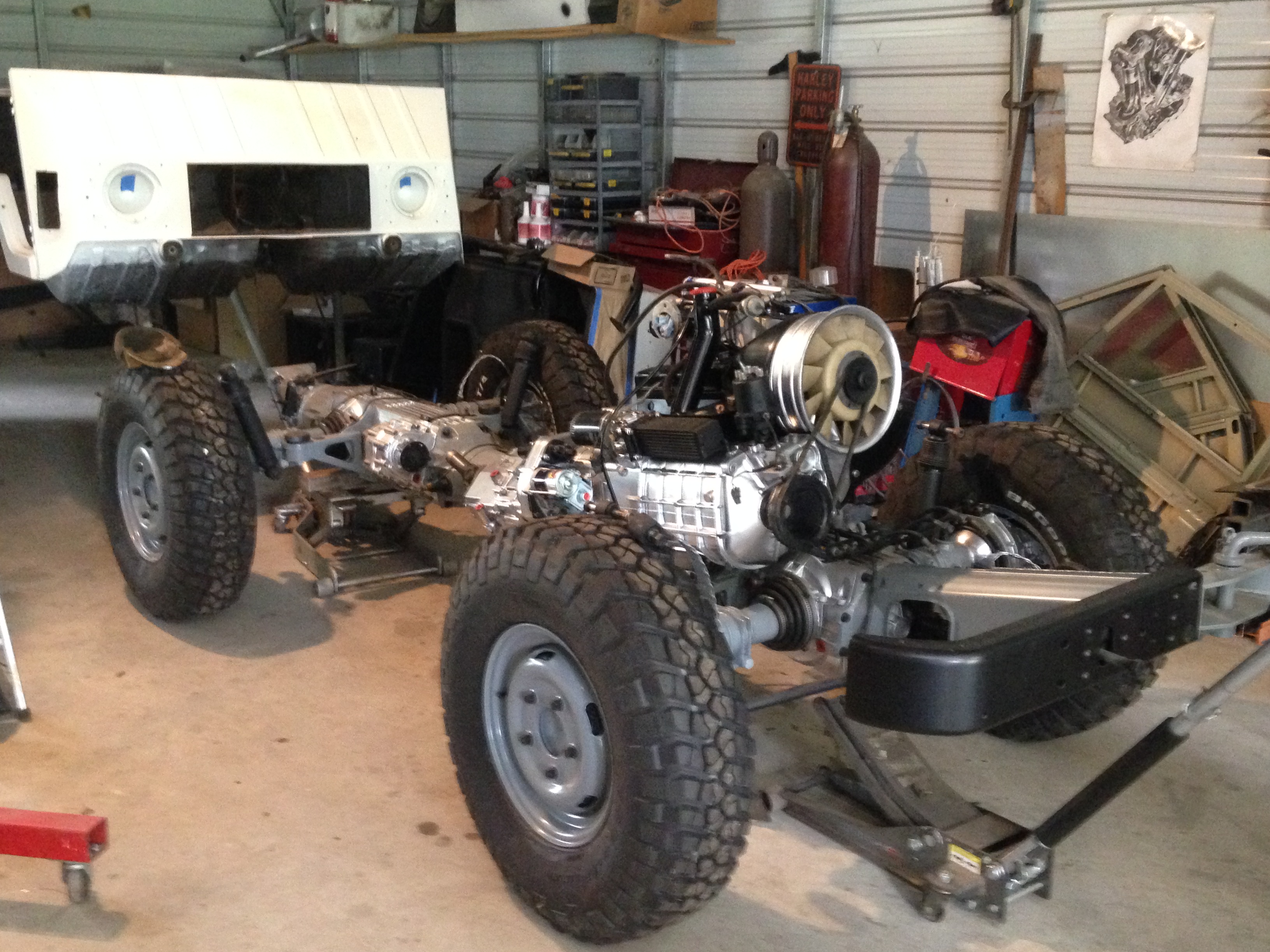

Here are a few more pics.

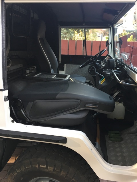

Here is the Smart Car passenger seat - folds nice and flat - basically even with the engine cover
Re: 710M rebuild

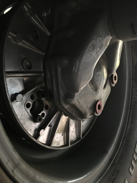

Moar...
Re: 710M rebuild
That's much too clean for a Pinzgauer! Nice.
Re: 710M rebuild

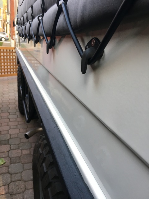

Bit more...
Re: 710M rebuild
Sorry for all the pics but wanted to give Jim L's work some photo time as well as Andre's :D

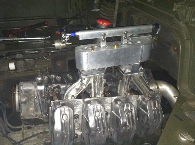

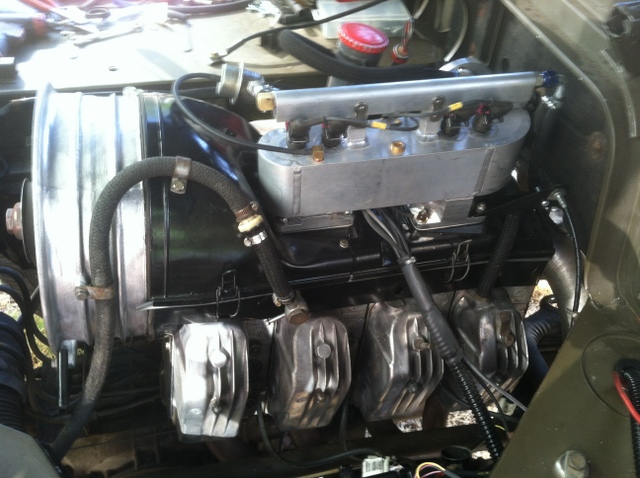

Love the pic's, super nice truck. Though, someone might have to walk me through the fuel delivery system...

...have to walk me through the fuel delivery system...
Airflow is through the stock filter, through the throttle body (visible behind the oil filler tube) and into the EFI manifold. The bar across the top is the pressure rail for the fuel; four injectors are right above each intake runner, shooting fuel straight down each intake. The higher end EMS system has sequential fuel delivery, each injector shoots fuel as each intake draws air. The front end of the pressure rail has the vacuum controlled pressure regulator (less fuel pressure at idle, more fuel pressure when vacuum drops as you put your foot into it). Mechanically it is very simple, very effective. The electronics on the other hand, while a simple "box", are much more involved but very capable.
