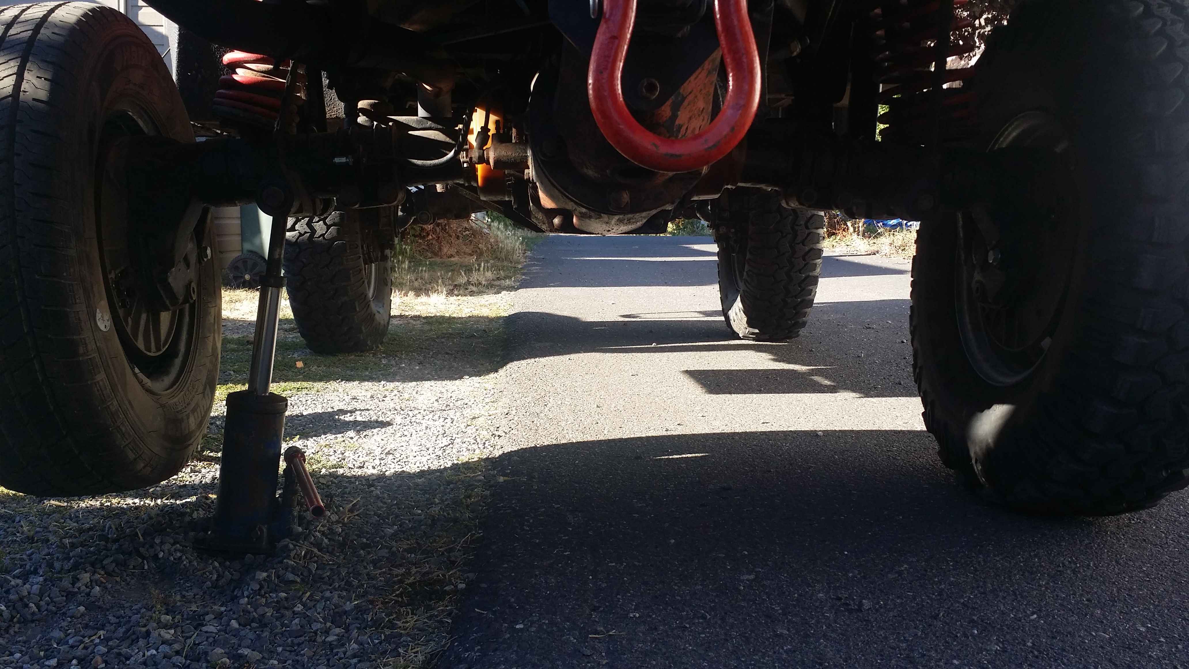

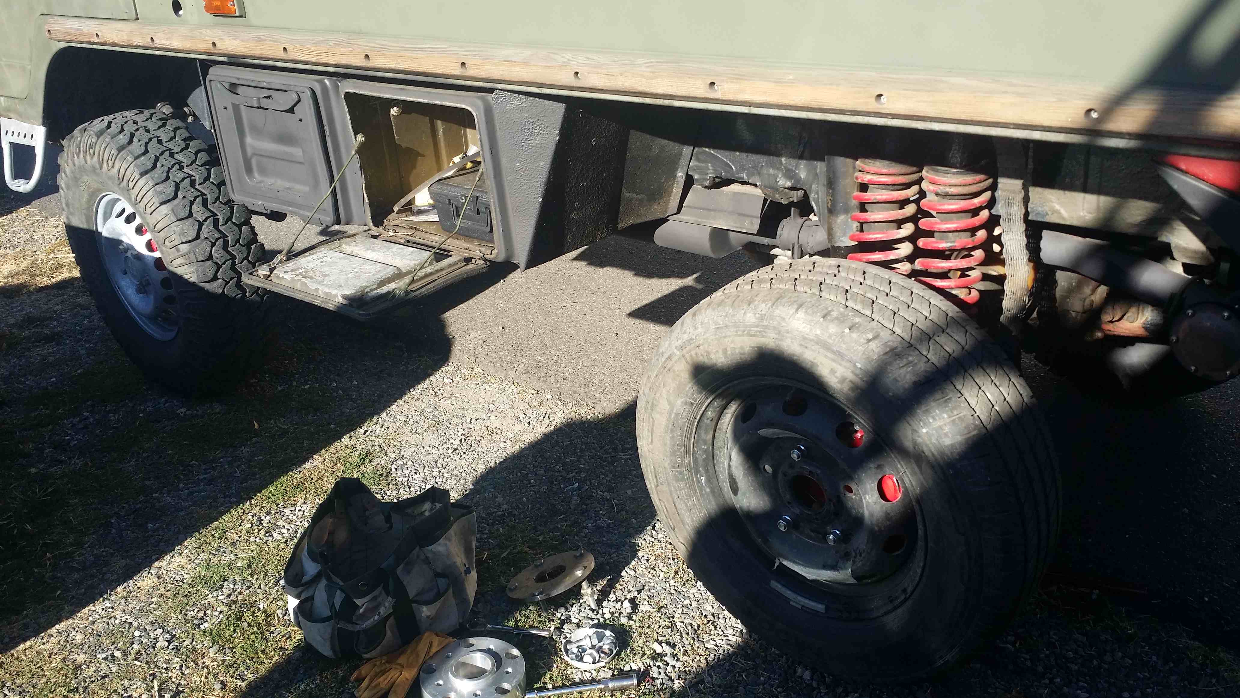

Was able to do a test fitting of a Euro-type Transit 16 inch wheel on the disc brakes - it looks like they will require the same thickness of spacer as the Sprinter wheel and so will require an "adapter" type spacer (i.e. one which uses the stock lug bolt to attach the adapter and then has five additional lug bolts for the wheel to attach.
The outer edge of the Transit wheel appeared to be at the same position as the outer edge of the Sprinter wheel - so a very reasonable amount of offset in my opinion.

I was able to test fit one of the Ford Transit wheels with the disc brake conversion using an adjustable spacer I improvised. Looks like they will work very well with only a small increase in the spacer thickness compared to the Sprinter wheels (about 1/8 inch or 3/16th of an inch).
Here are some (not so great) pictures...
In this first photo the angle of the camera and the camber of the wheel with it in the air while up on the jack make it look like the tires stick out more than they actually do - the edge of the tires tread is actually even with the outer edge of the wood rub rails when the wheels are in a vertical orientation (i.e. with a small typical load in the Pinz).
