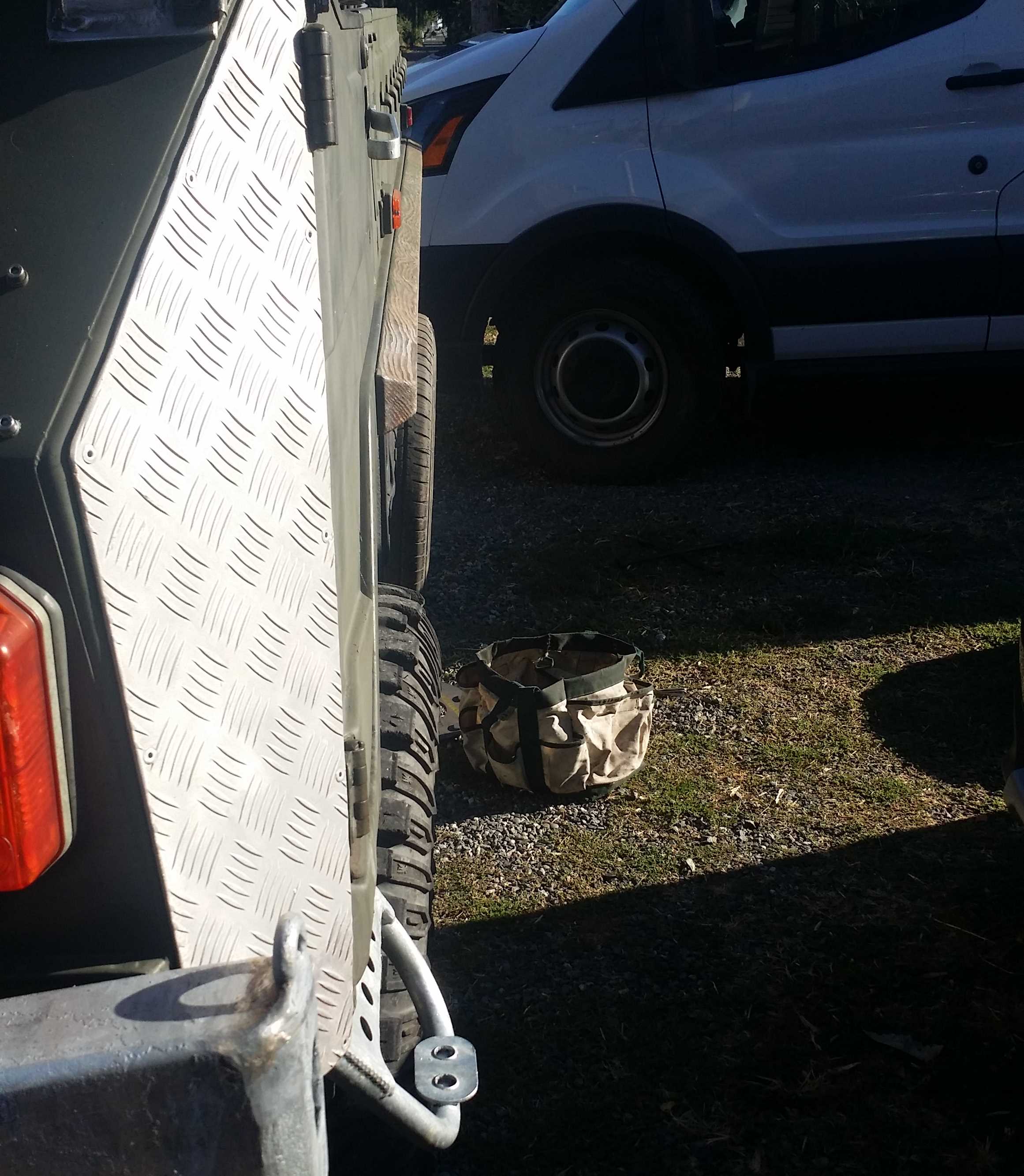

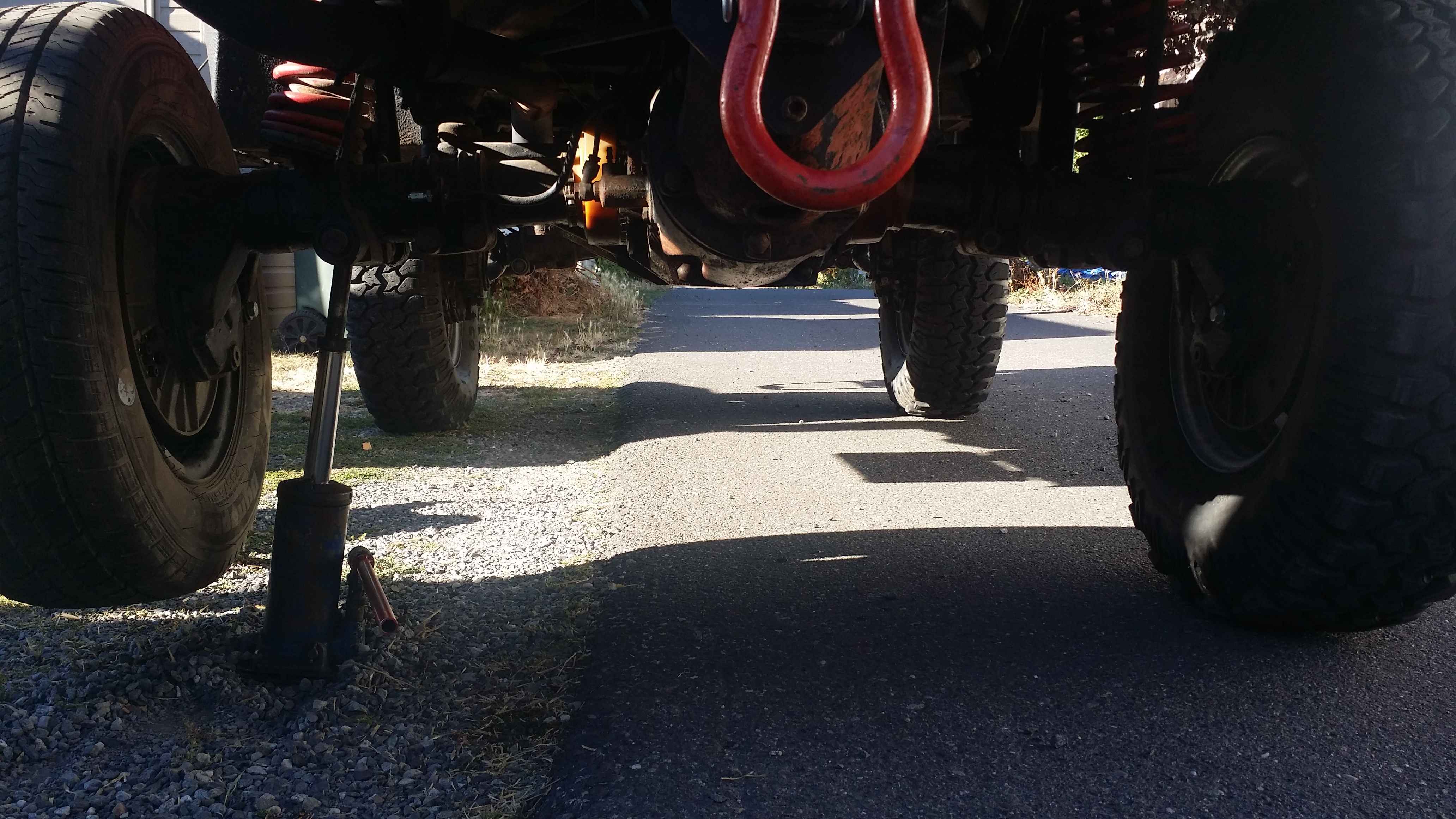

I was able to test fit one of the Ford Transit wheels with the disc brake conversion using an adjustable spacer I improvised. Looks like they will work very well with only a small increase in the spacer thickness compared to the Sprinter wheels (about 1/8 inch or 3/16th of an inch).
Here are some (not so great) pictures...
In this first photo the angle of the camera and the camber of the wheel with it in the air while up on the jack make it look like the tires stick out more than they actually do - the edge of the tires tread is actually even with the outer edge of the wood rub rails when the wheels are in a vertical orientation (i.e. with a small typical load in the Pinz).
Transit rim test 2.jpg (423.65 KiB) Viewed 9343 times
Transit rim test.jpg (615.34 KiB) Viewed 9343 times
