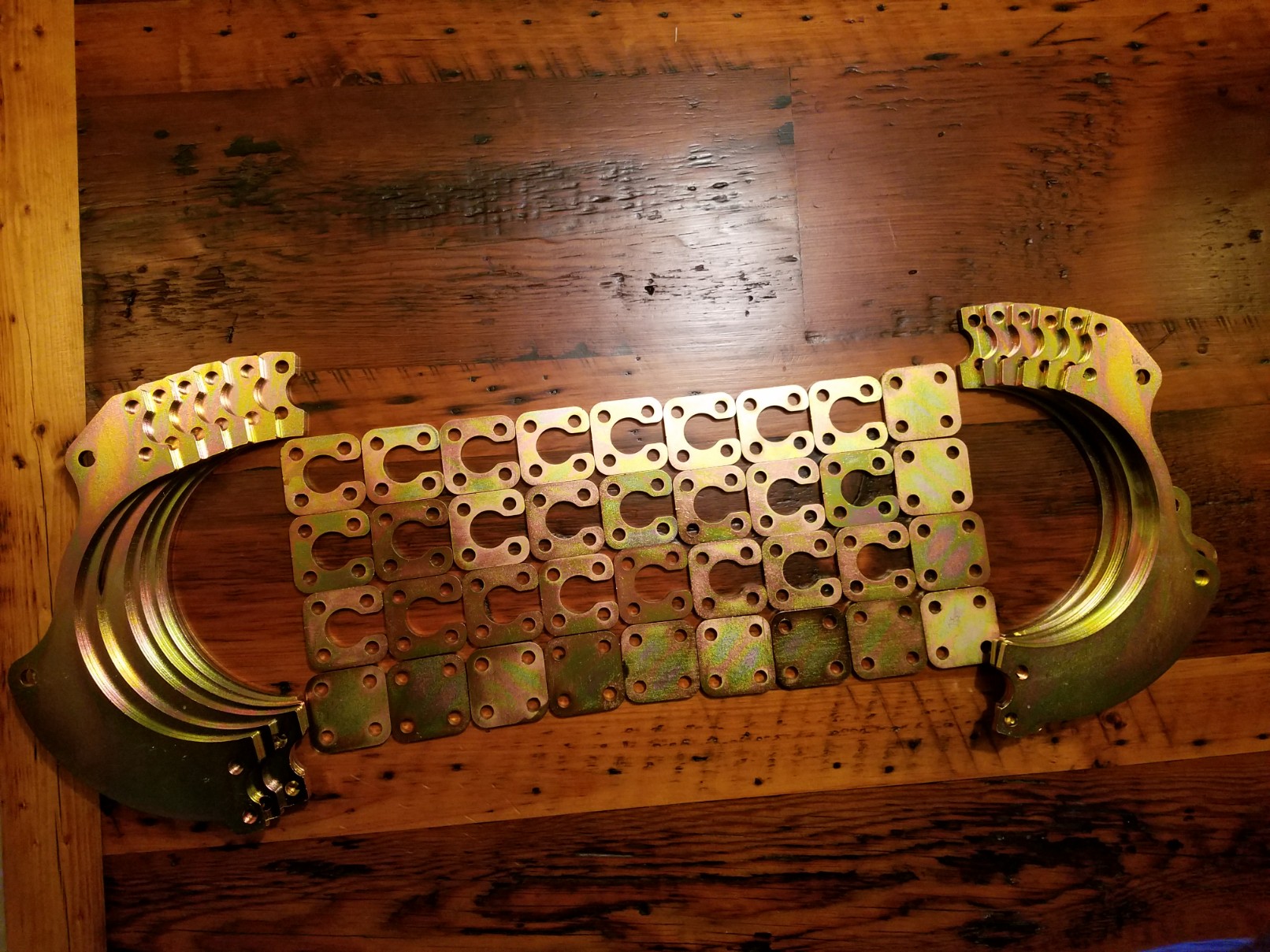

Hello everyone
no news from Chris
anyone have the DXF of the brake plates?
thanks
Eric
no news from Chris
thanks
Eric
