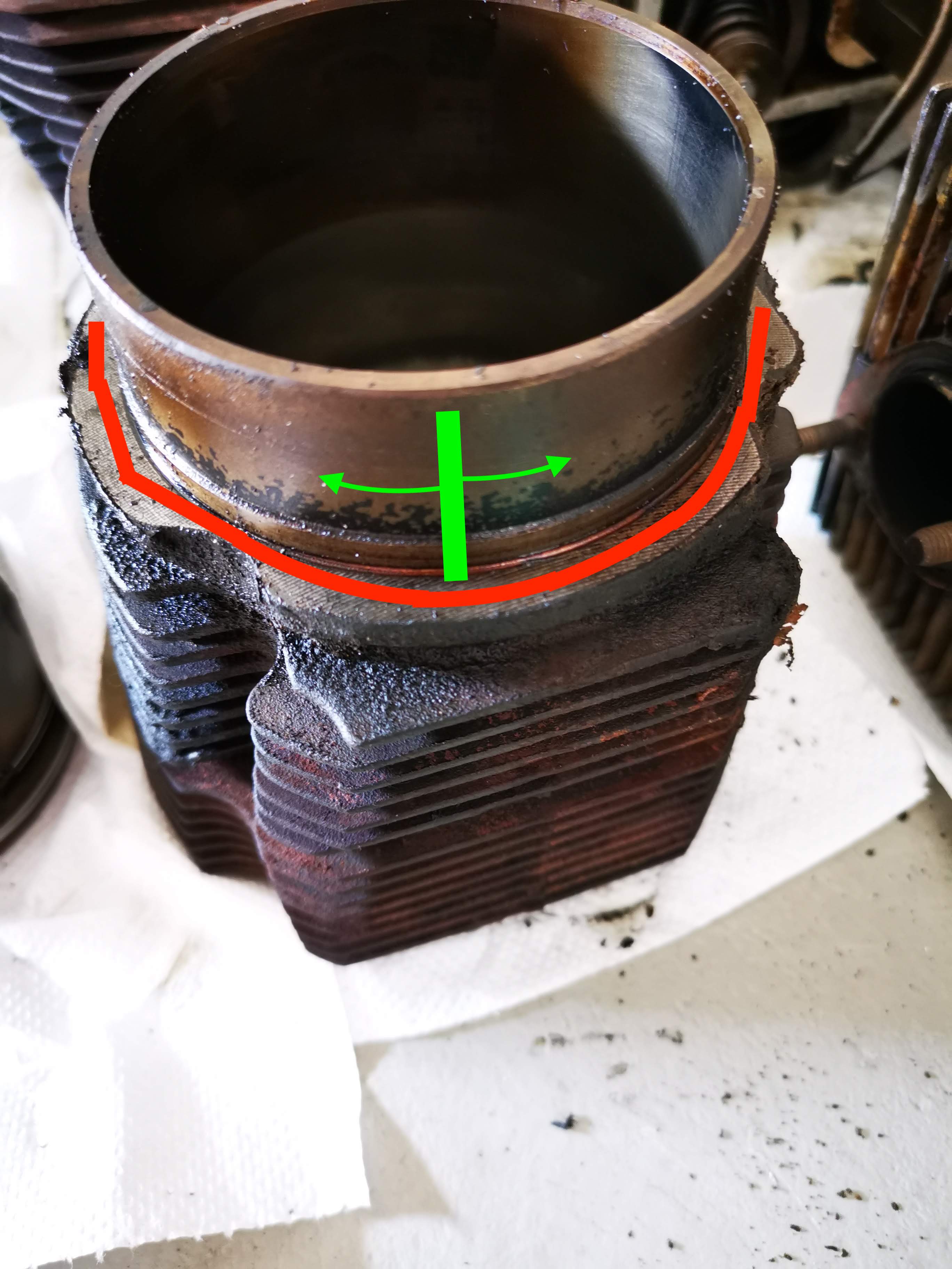

Ok, on the block side, I got it clear,
Above you wrote, "on the head side", I guess you meant cylinder.
I show a picture below of my old cylinder, so i apply sealant on the red and green areas ?
- cylinder.jpg (475.24 KiB) Viewed 13123 times

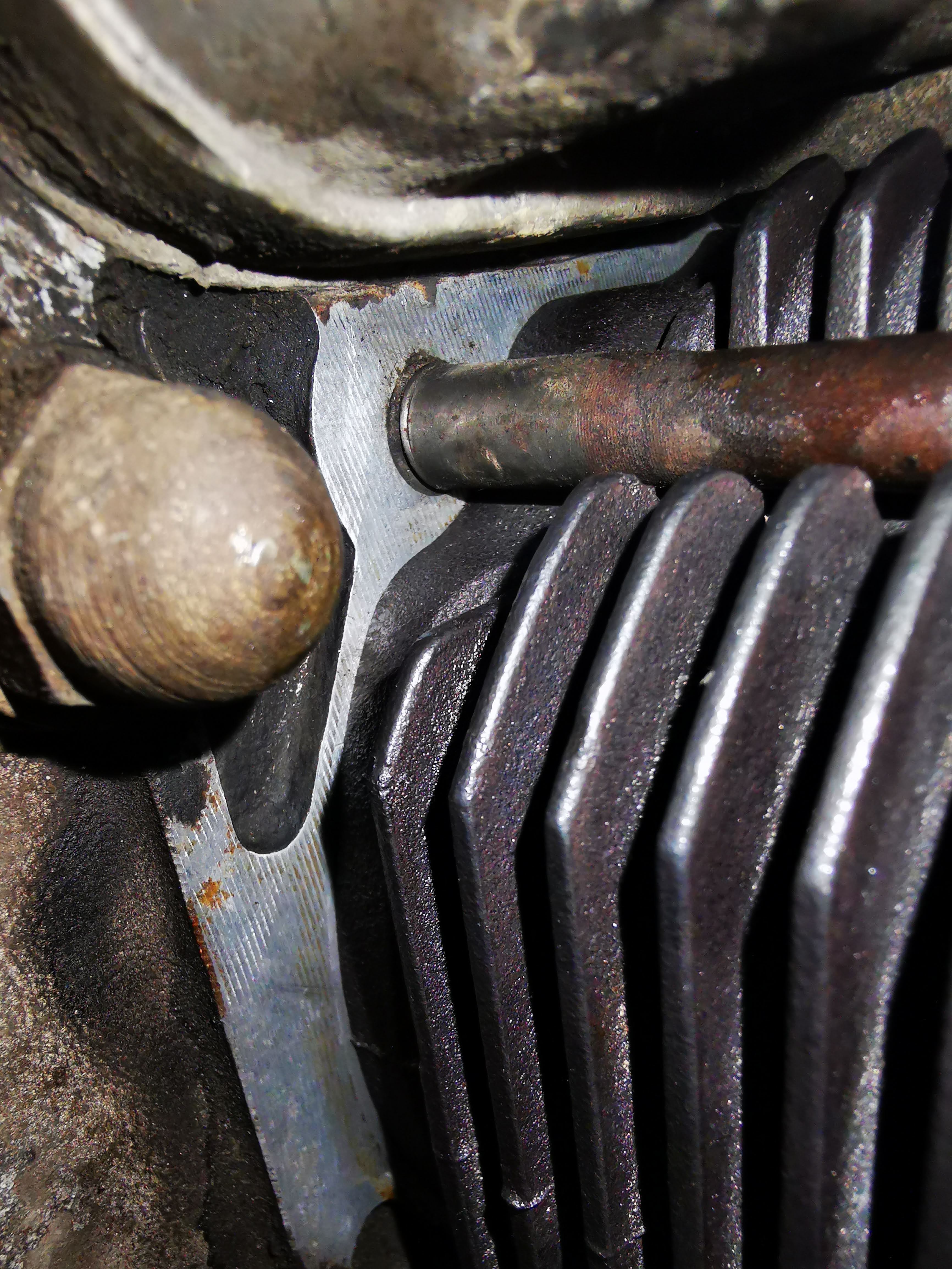

I must admit that I did not manage to remove the 4 retaining long bolts. They are seriously stuck and i have nightmares about bolts like this snapping into the block.
If it had been 1 or 2, i would have give it more try, but 16 of them is too much for a newbie like me.
Besides, as pictured below, these bolts stand outside the mating surface between the cylinder and the block.
- retaining bolts.jpg (1.12 MiB) Viewed 13123 times

Yes that was a typo....and yes along the red area you noted.
And about 15mm up the side wall should do.
With respect to the cylinder bolts, heat is your friend. You
could try a little heat from a propane torch. The Aluminum
will expand more than the hardened steel bolt. They can
be a real pain to remove. You could keep them in place but
make sure there is absolutely no residual old sealant laying
around, the lower two bolts are a potential area to leak.

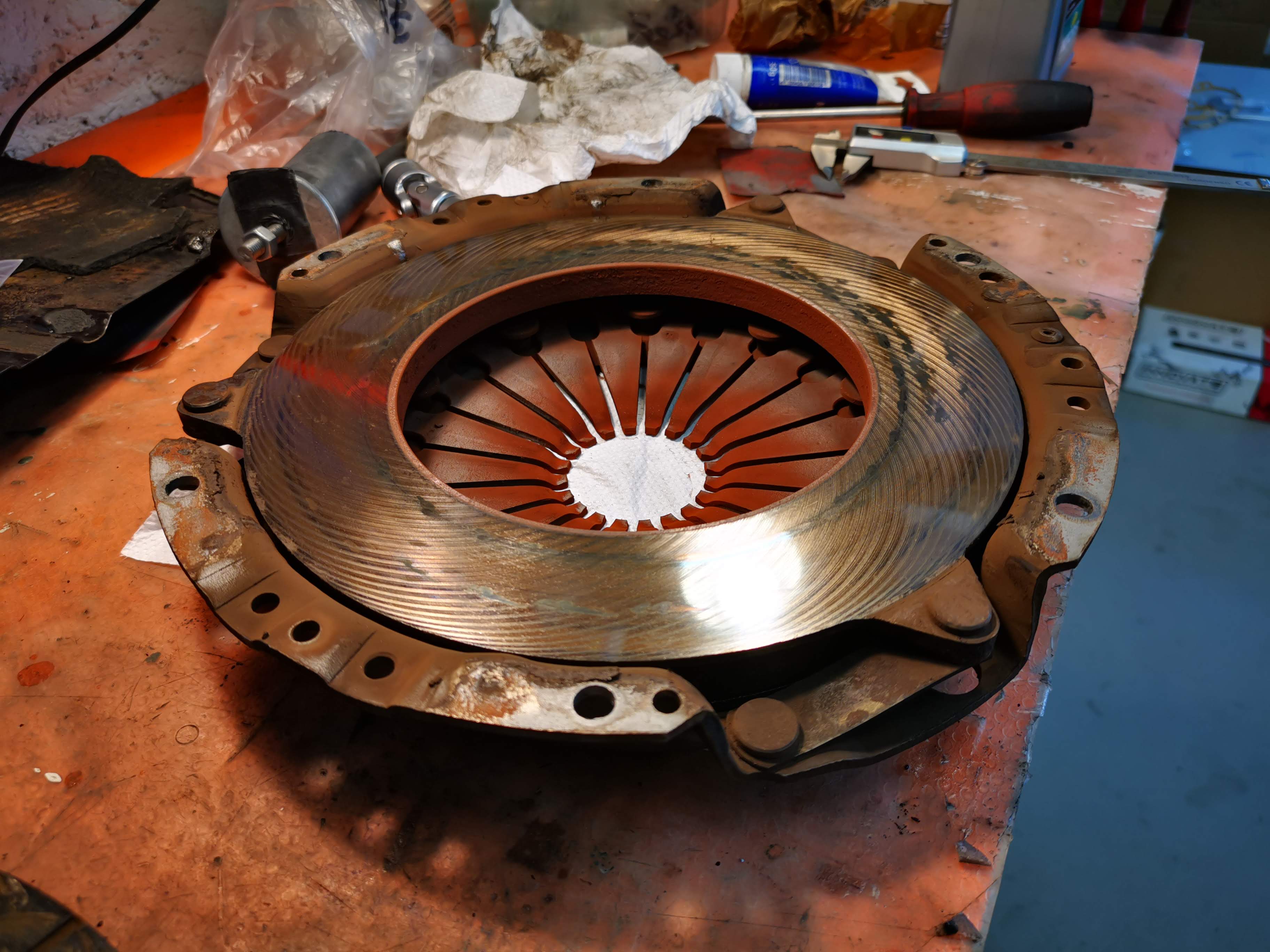

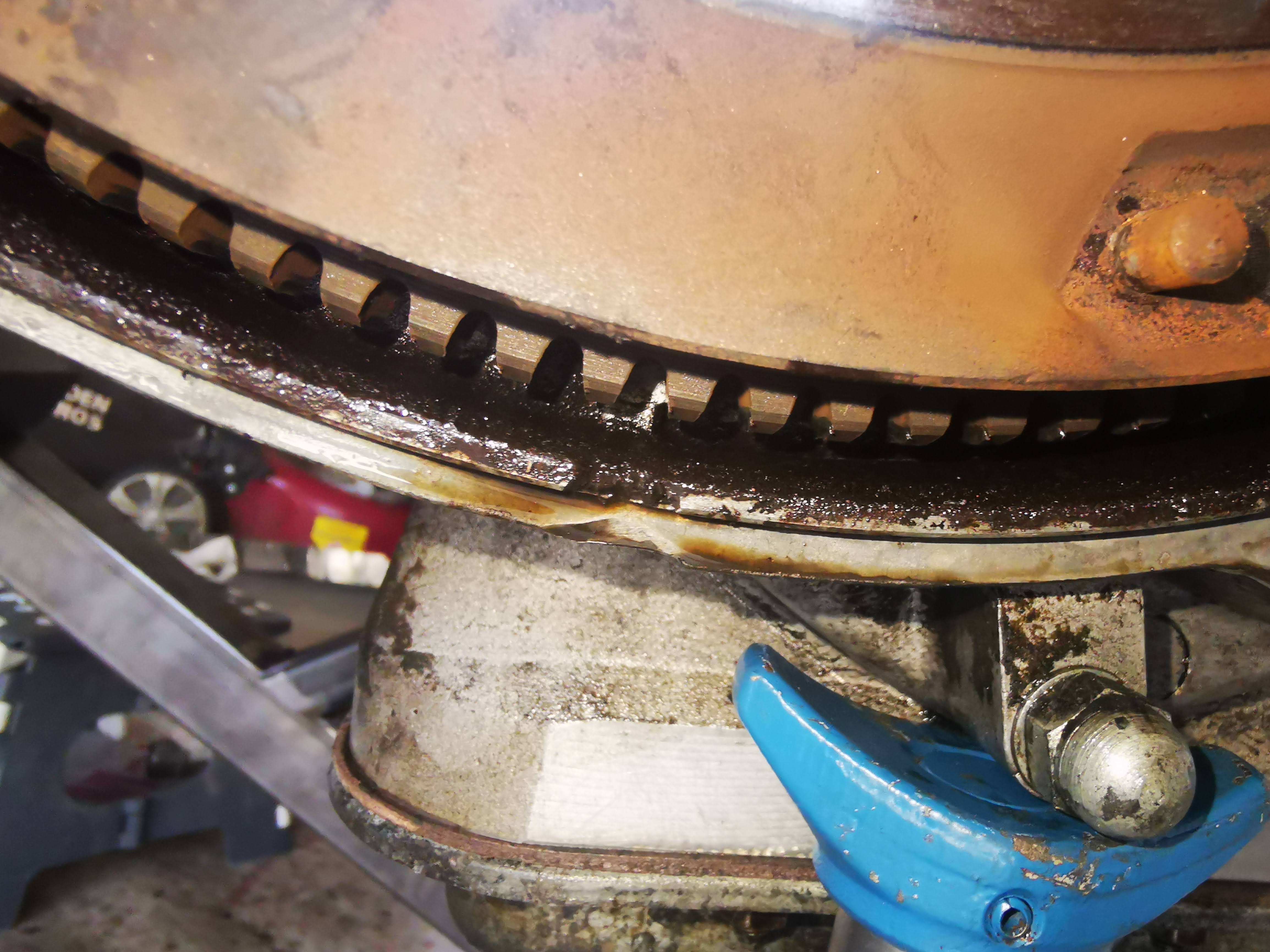

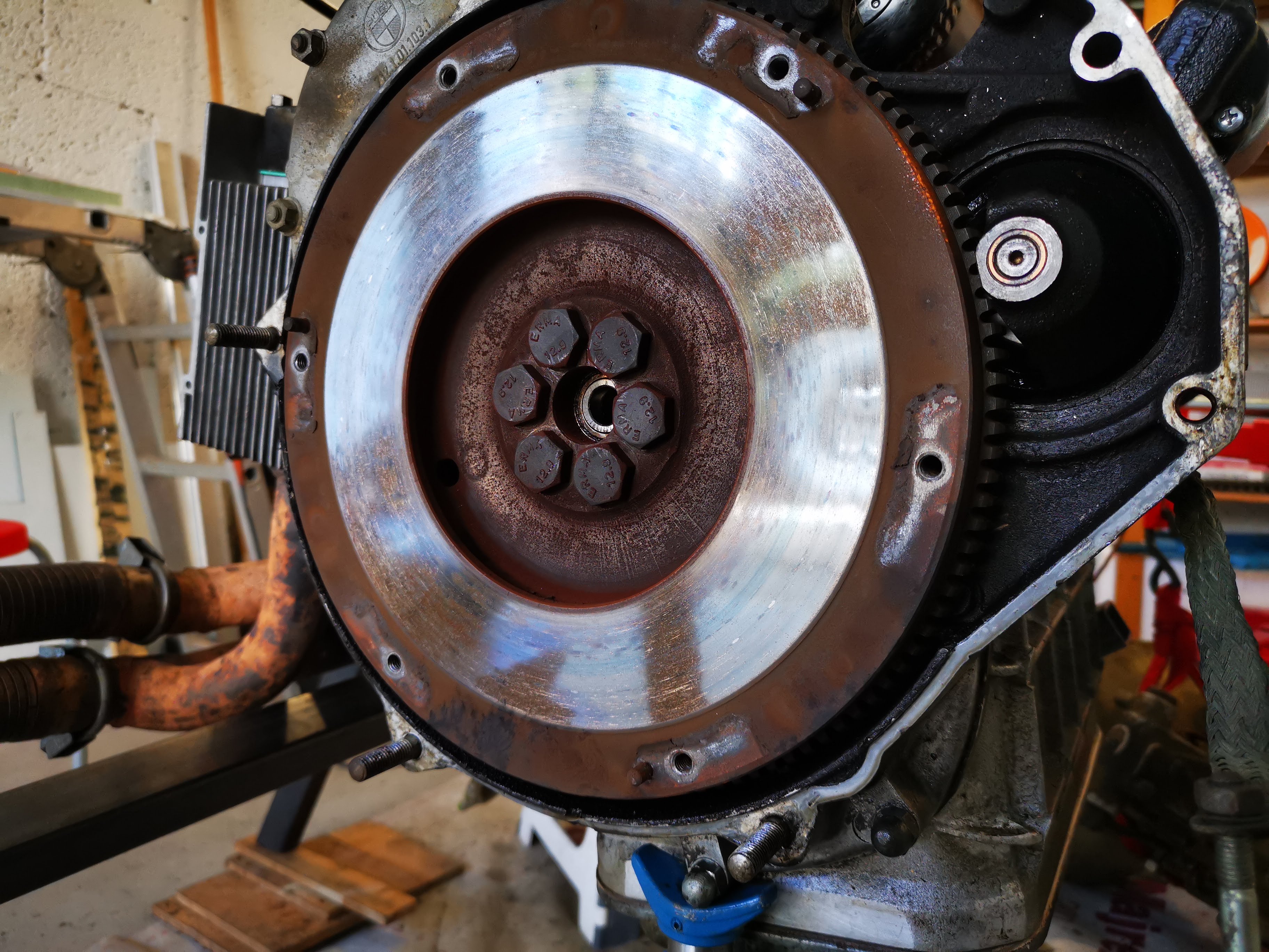

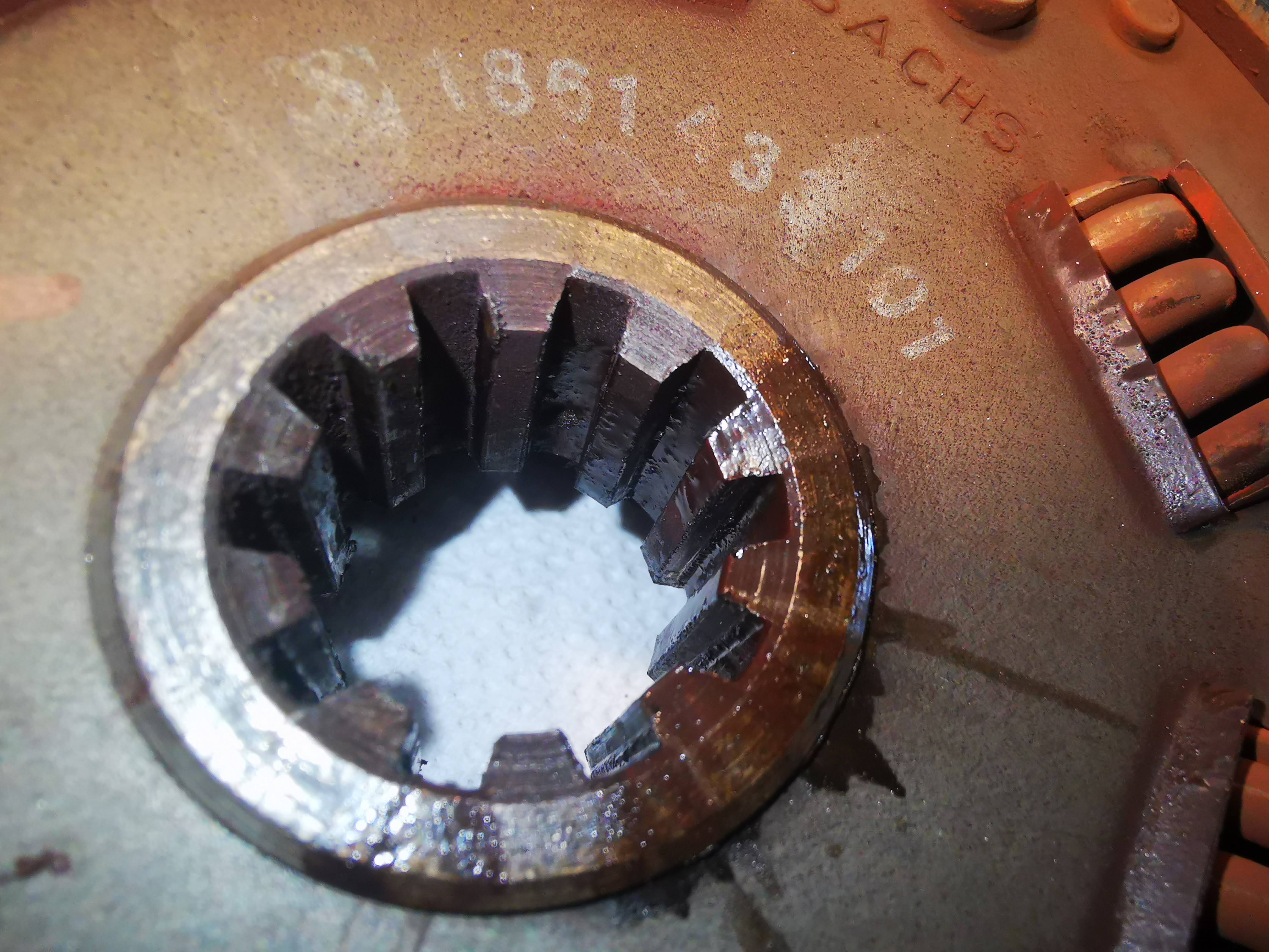

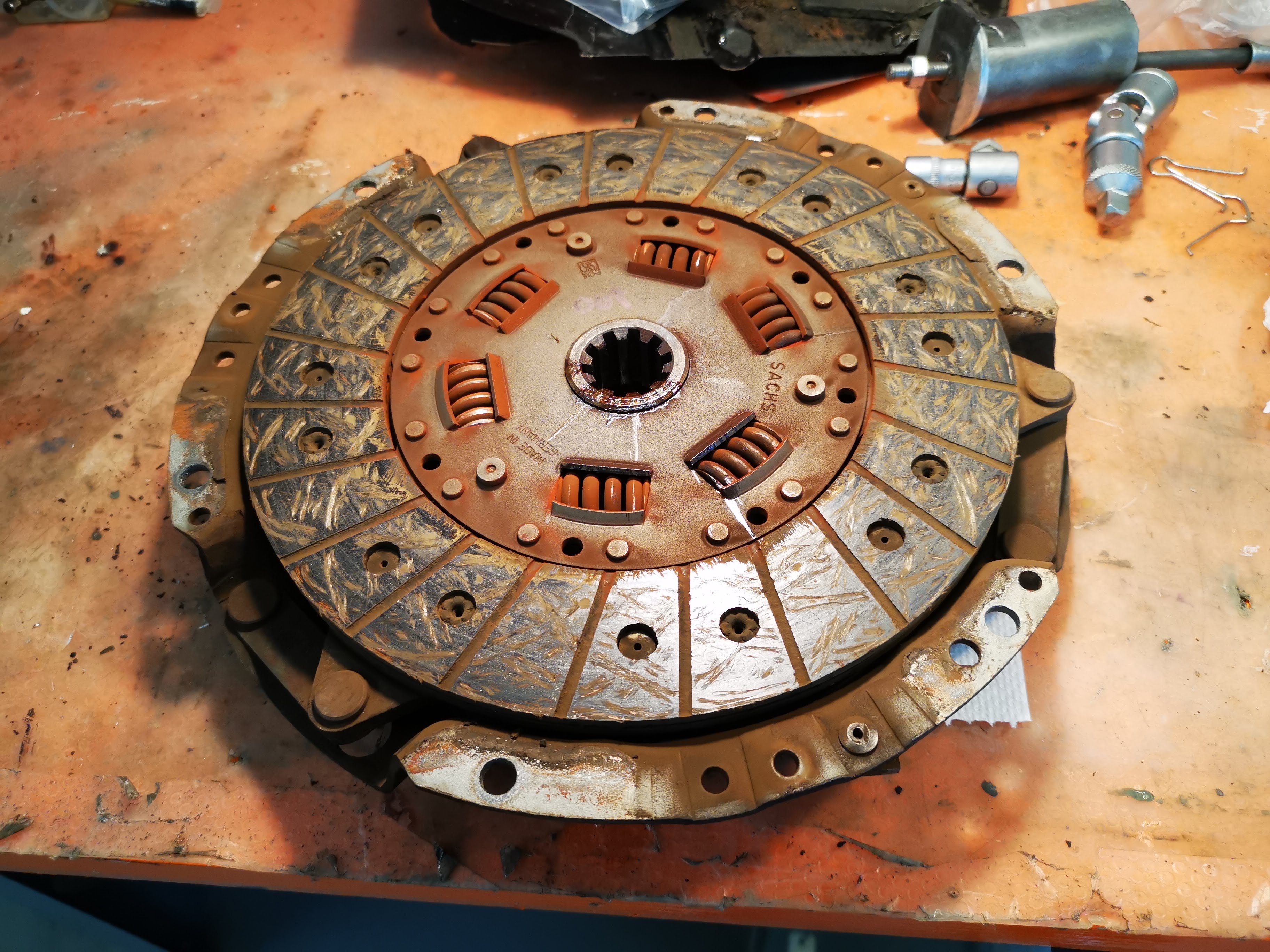

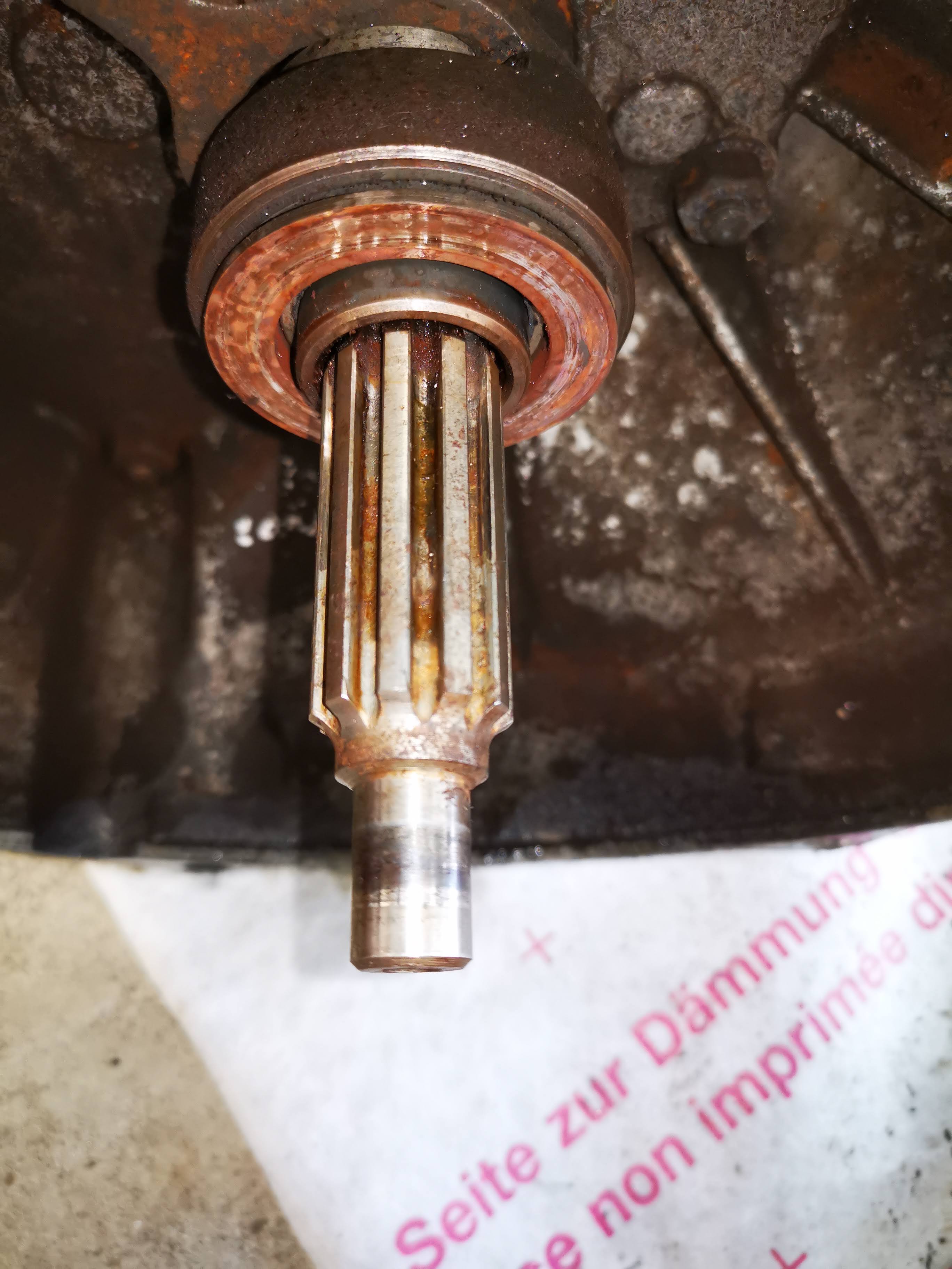

As my Hylomar AF HV is delivered only monday, I took the opportunity to have a look at the clutch:
The splines and flywheel appear to be OK
- spline tranny.jpg (489.04 KiB) Viewed 13425 times
- flywheel bottom.jpg (668.05 KiB) Viewed 13425 times
- spline clutch.jpg (786.59 KiB) Viewed 13425 times

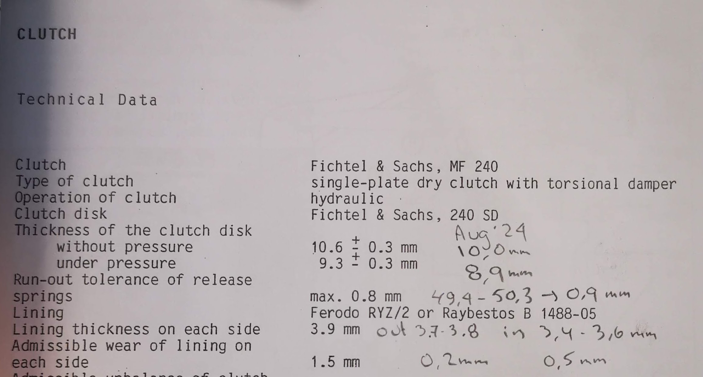

and these are my measurements, it looks like the wear surfaces are still working.
max. 0.5 mm wear of 1.5 mm permitted.
- disc engine side.jpg (1.54 MiB) Viewed 13425 times
- disc tranny side.jpg (566.82 KiB) Viewed 13425 times
- clutch.jpg (1.58 MiB) Viewed 13425 times

my measures vs Pinz manual
- measurements.jpg (221.25 KiB) Viewed 13423 times

Do I need to put any grease on the spline when putting the tranny back ?
Pinz manual does not say anything.
Flywheel gear seems to be running dry, no grease either ?

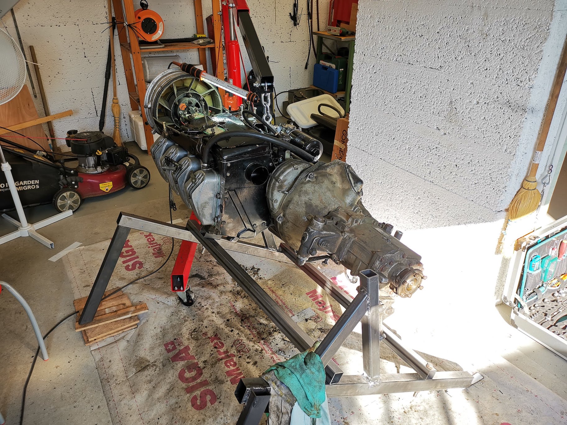

Posted: Thu Aug 29, 2024 12:34 pm
by Hugues

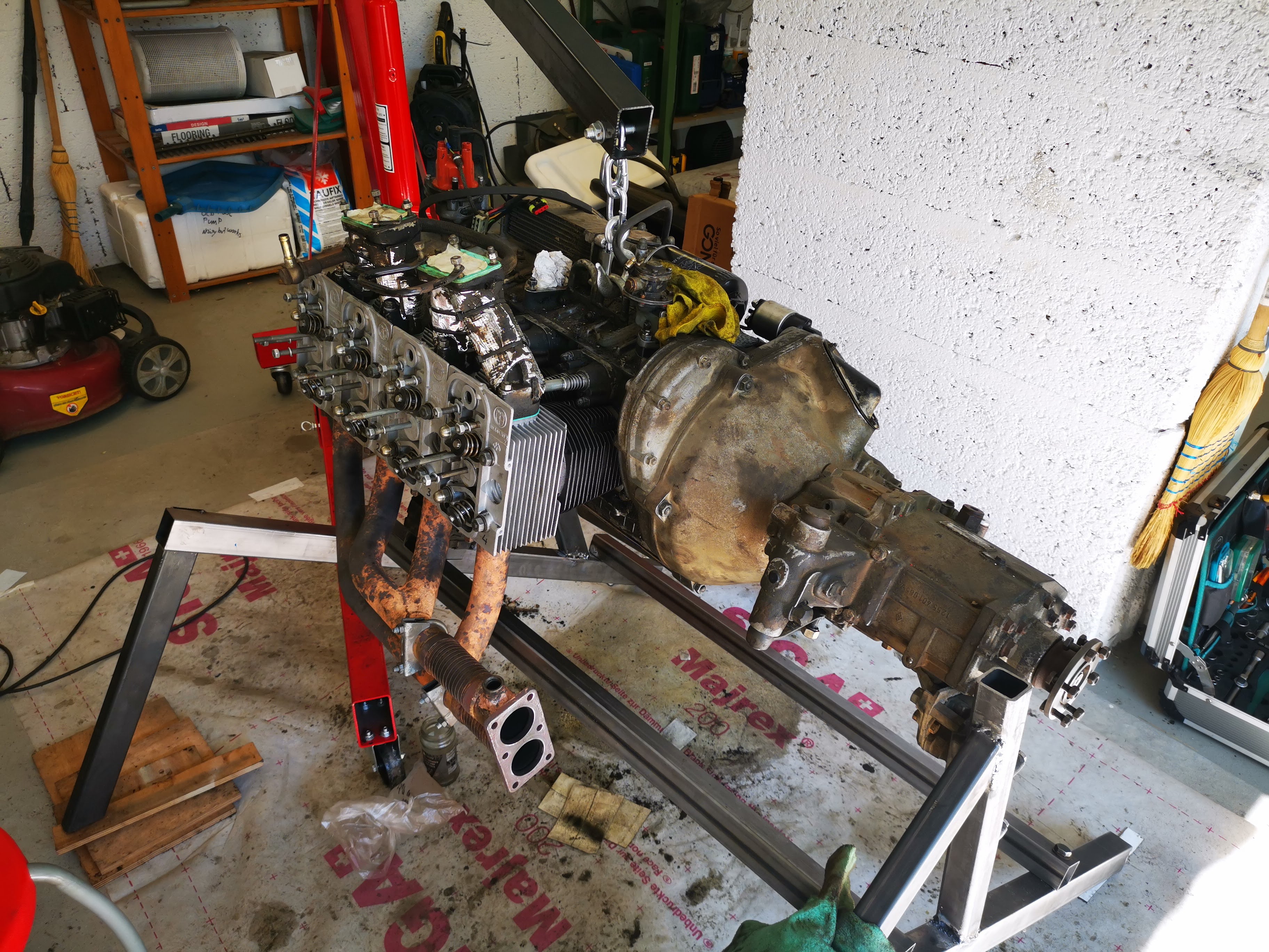

Engine assembled
gores back in the Pinz tomorrow
saturday i can test it, slowly, slowly
- IMG_20240829_172410.jpg (764.93 KiB) Viewed 13165 times

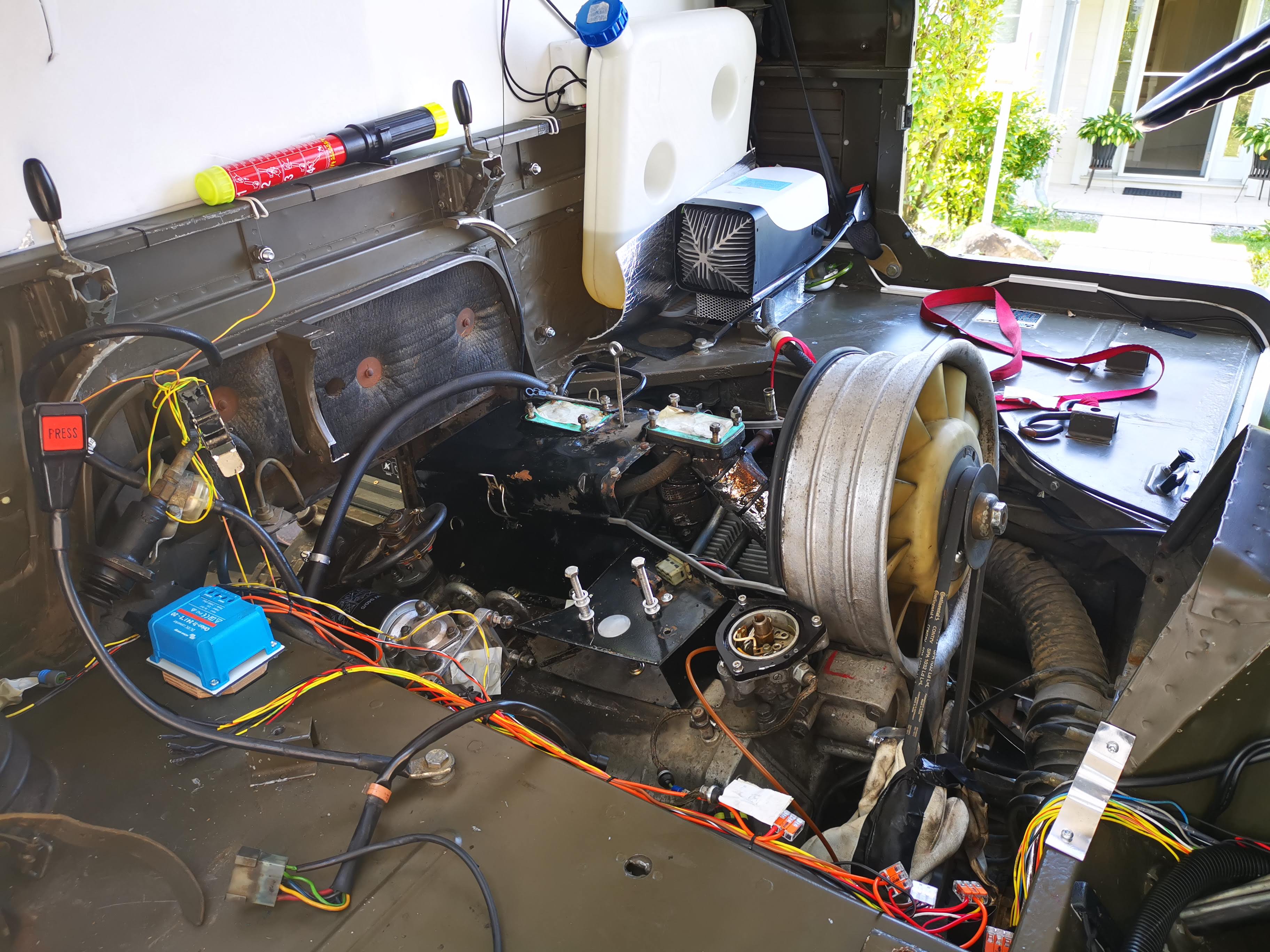

Re: Changing piston, cylinders and cylinder heads
Posted: Fri Aug 30, 2024 9:01 am
by Hugues

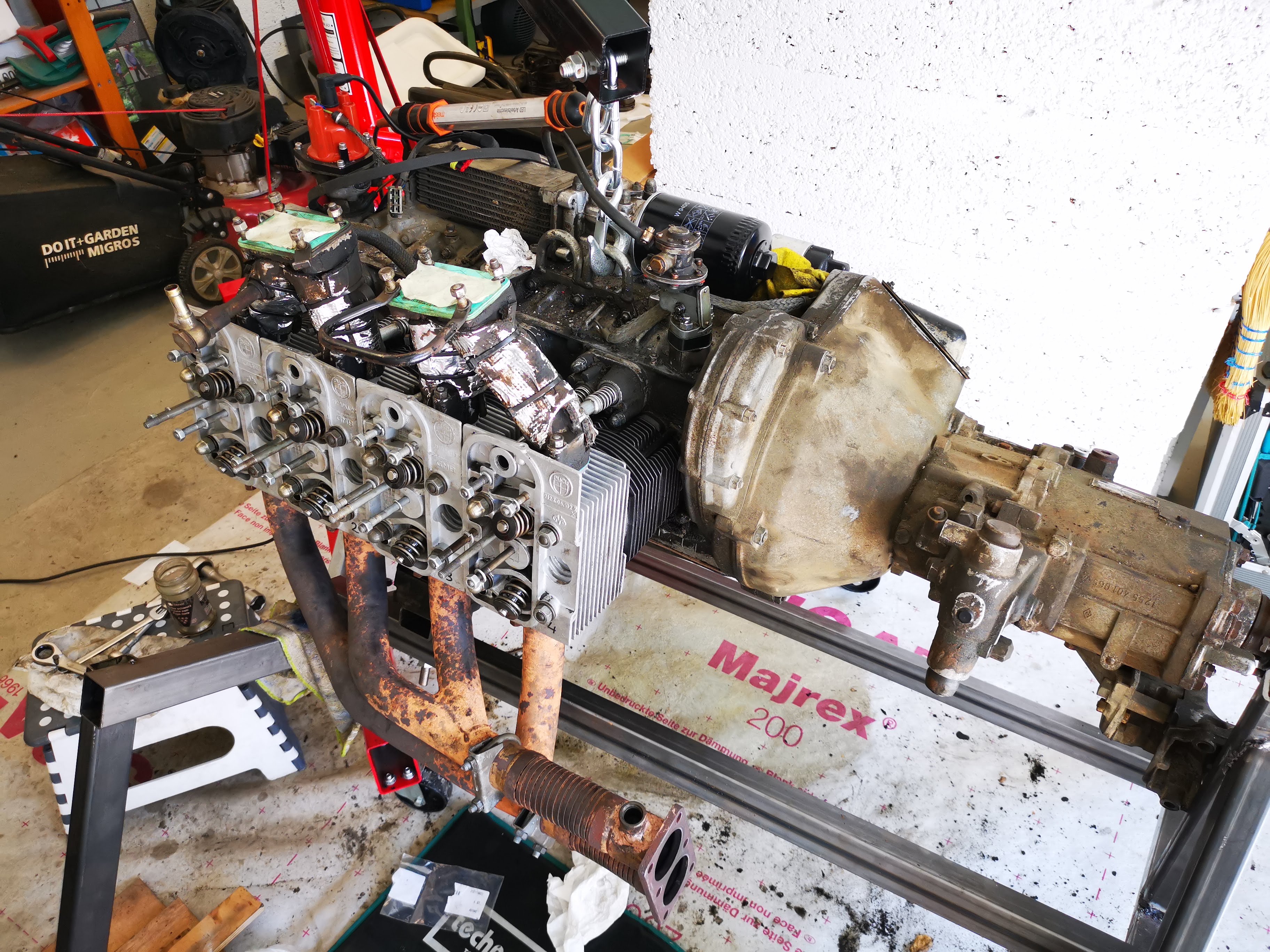

Engine is back in the Pinz !
I ran the engine on the starter while measuring the compression on each cylinder (and waiting for oil top come into the heads). I see:
135 psi on each cylinder,
that's pretty good, considering the engine is cold and the rings are new.
My previous engine was showing 120 maximum.
Then I could see oil coming to the oil filter (just unscrew it a couple of turns).
Then oil started to flow from each push rods on each head, so I closed the valve covers.
Tomorrow saturday:
i will install the exhaust, gear shifter, carbs, air filter, fuel pump, ignition, spark plugs,...
And start the engine with fuel and let it run a few seconds at a time and check temperature, recheck valve gaps, torque heads,
recheck compression and leak down test when engine warm
Sunday:
if everything is ok saturday, will run with the Pinz in the village for a short ride, no big load,
monitor combustion, check for oil leaks,...
