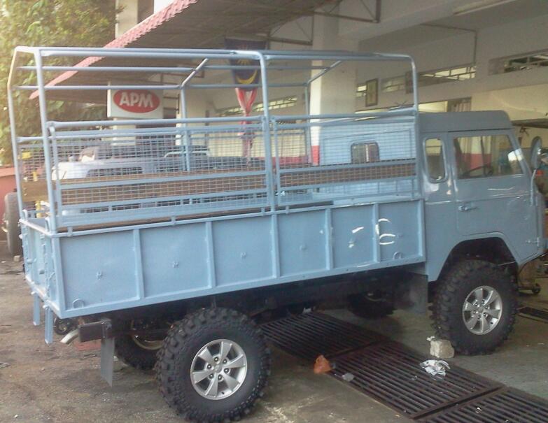

by geckoadventure
2012-01-04 19.04.58-1.jpg (67.81 KiB) Viewed 7681 times
Saw this one at the local workshop just restored back to police specs like mine was once
Running 1JZ toyota engine and disc conversion
Re: Intro from Malaysia - WR7002 - C304 - Tires on gray truc
Posted: Thu Jan 26, 2012 9:24 am
by kpoling
Hi Gecko: Those tires on the picture of the gray truck you posted on Jan 26th, do you know the manufacturer of them? They look like excellent mud tires!
Posted: Thu Jan 26, 2012 3:26 pm
by VinceAtReal4x4s
They look like Simex tires. Great tires and popular, but not in the US.
Posted: Thu Jan 26, 2012 6:17 pm
by geckoadventure
Vince
They are indeed SIMEX XT 35" 10.5 * 16" tires - Not sure if you can get in the US. They are what we all use as the factory is <2k from me at work :)
They are SOFT and I think not suited to the Volvo due to its massive WEIGHT as they seem to cut out .
Normally we get 15-20K out of them before they have to be replaced.
Silverstone also have the same tire MT117 EX
Posted: Tue Jan 31, 2012 9:42 am
by mad_as_hec
Are the wheels on the grey truck Mitsubishi? They look like the ones on my wife's Pajero (Montero).
Posted: Tue Jan 31, 2012 6:37 pm
by geckoadventure
YEs they are MISTSUBISHI (MISSY BITCHY :wink: or MISSING BITZ)
common over here after the DISC conversion. Too many issues with the LR Brakes in the MUD so DISC conversion is done.
