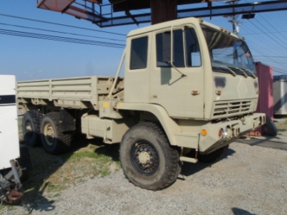

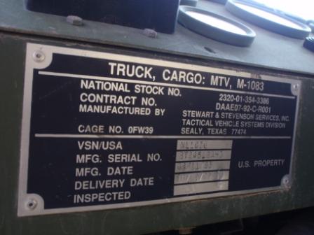

Re: New Member Intro
Mopar, here is a pic of the MTV that I found on a recent trip. It was a 1995 model that was sold last year on GL. Obviously this is the Medium version of the Light/Medium Tactical Vehicles. Nice condition.
- MTV Data PLate.JPG (29.94 KiB) Viewed 4029 times
- LMTV Demil 1.JPG (76.75 KiB) Viewed 4029 times
