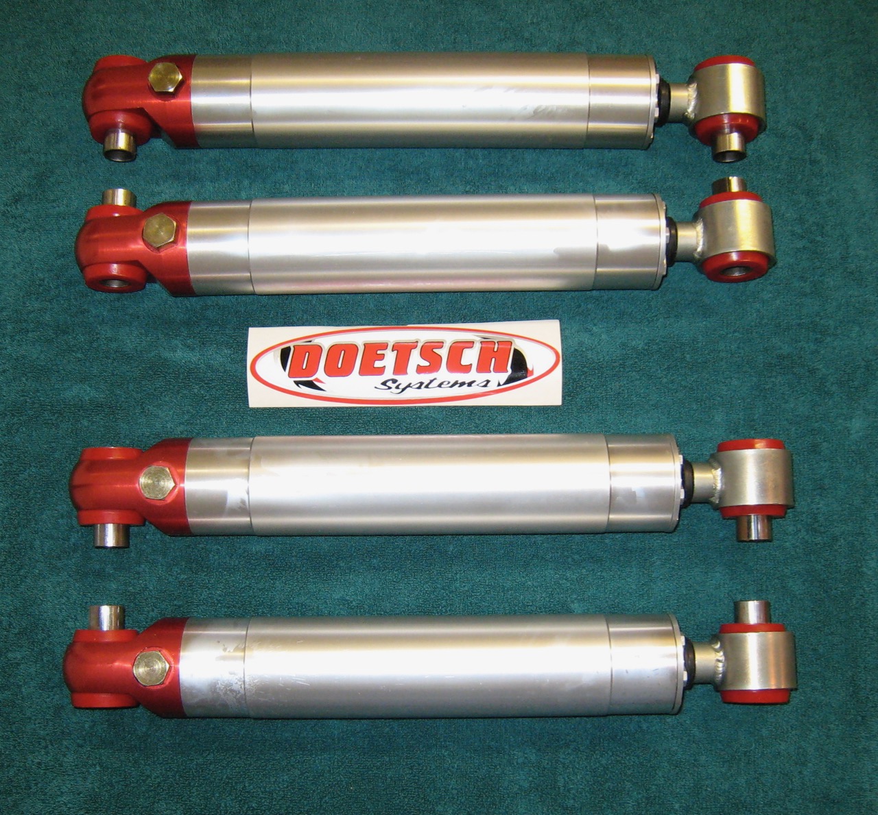

4x4Pinz wrote: Sun Jan 20, 2019 10:37 am I had the doestch shocks for a short term but they caused a lot of problems for me. Many broken shock bolts and the constant need to rebuild then after a couple outing became the norm. Finally tired of them and went back to rancho (which I hated to do). Looking forward to the availability of factory shocks, cost might be high up front but long term I expect a better return.
Did you happen to have the original Doetsch shocks as pictured here:
They were made by Doetsch and were rebuildable. They were the first set I purchased, direct from Doetsch, and did not last a year. They corroded and leaked. Were quite pricey too.
About that time Scott began selling the non-rebuildable shocks and I switched to them. I never had a problem with them other than the incorrect bushings on the first set.
Re: Doetsch tech shocks
That is the ones. Rebuilt them several times before realizing I was wasting my time and money. Soured me on buying any doestch shocks ever again.
