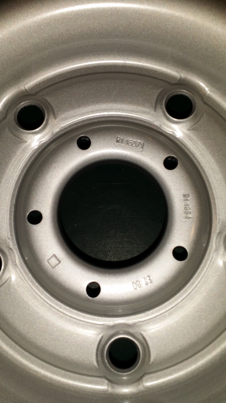

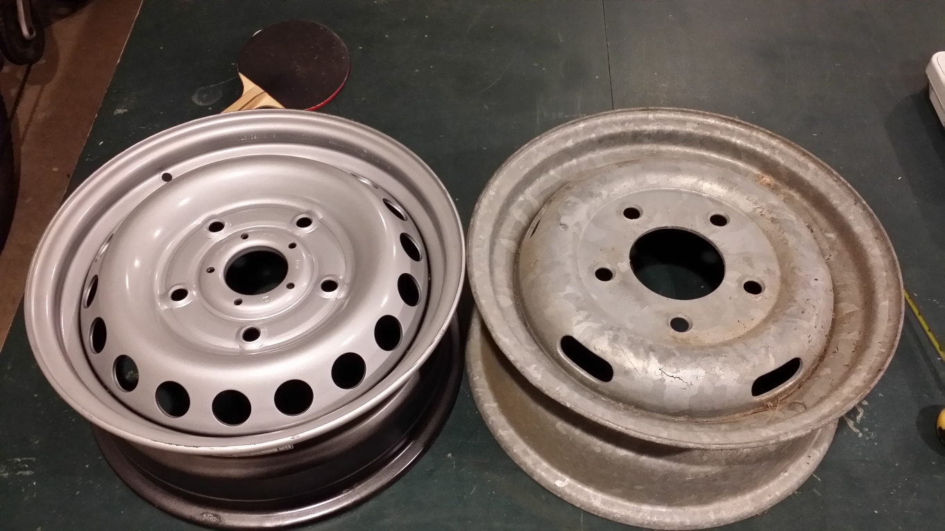

I just order and got in a set of the European Ford Transit steel rims - 6.5x16 with an ET of 60 which puts them just under one half inch / about 12 mm farther outward compared to the standard Pinz rim. These are slightly different than the US Ford rims in that they have 18 round holes instead of the 10 oval holes used on the US versions. I ordered the off of EBAY from a German company and got them for about $70 USD each including shipping to me here in WA state. It seemed like to good of a deal to pass up. I ordered them on Nov 30th and they were delivered on December 4th to my place in WA state - shipping was $32 total. They are very similar looking to what was just posted - but I think a different manufacturer?
I got them from an ebay seller "Tunershop-Germany" and they were brand new never mounted in original boxes - the front side of the rim is silver - not black as shown on the Ebay listing. Just be very careful when ordering because there are rims with 5 and 5.5 inch widths x 16 and also some 15 inch rims also. Here is a link: http://stores.ebay.com/TUNERSHOP-GERMAN ... 7675.l2563

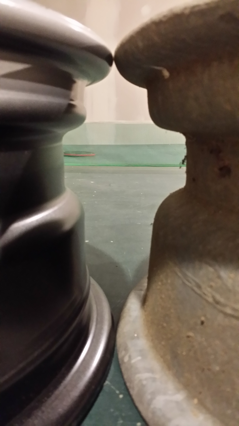

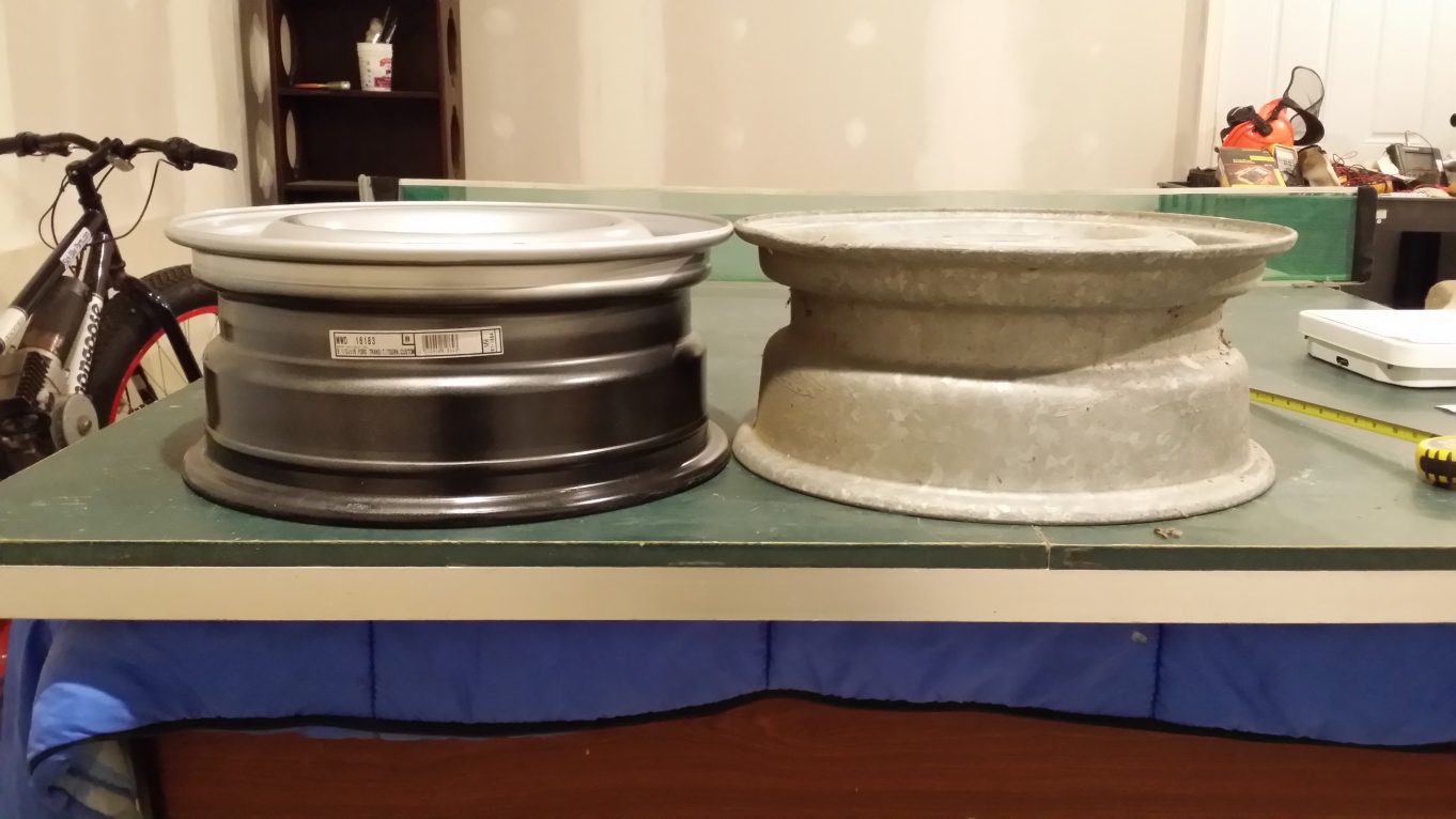

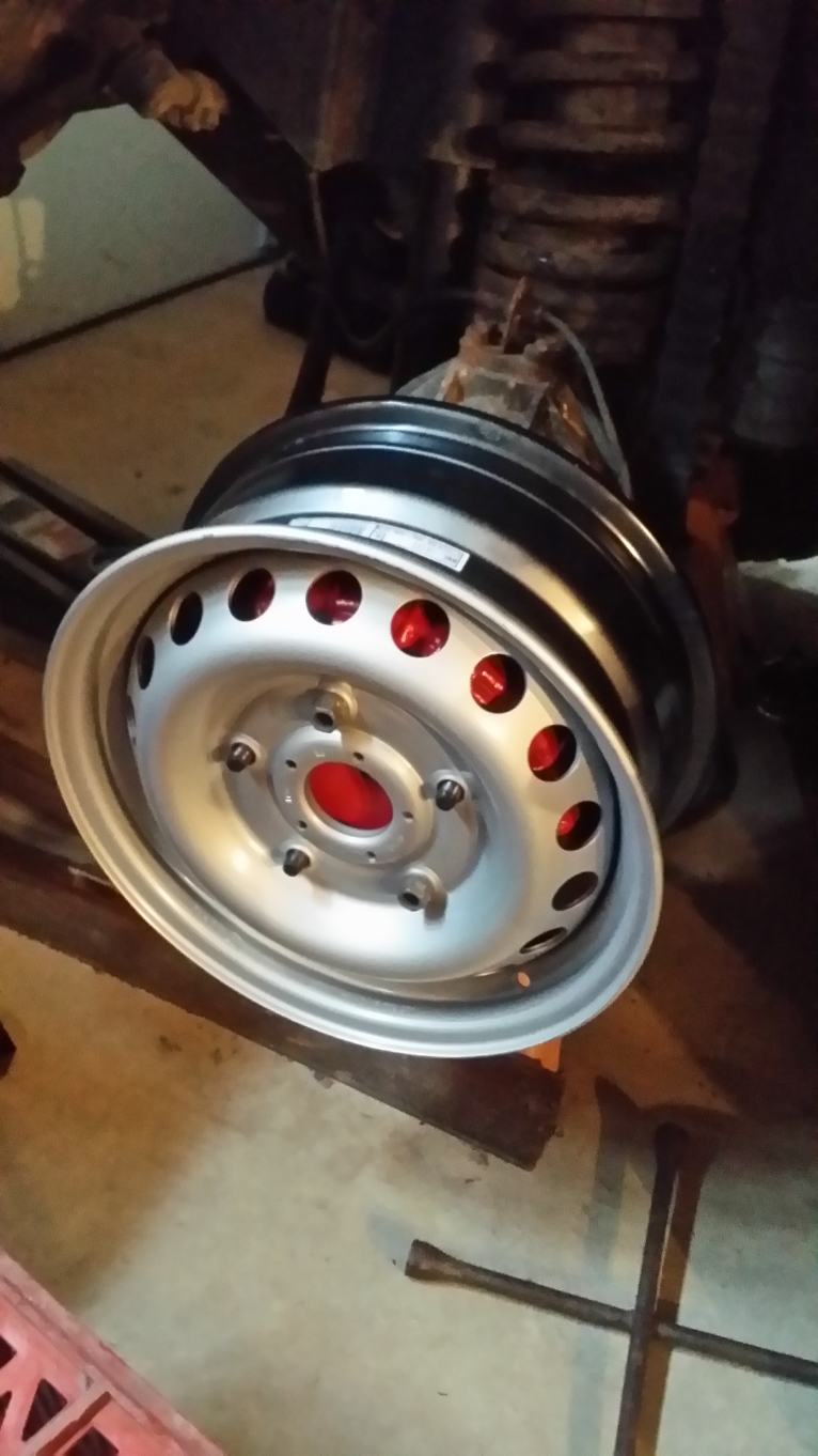

Test fit them on my pinz - no problems. Can't imagine that a 15 inch rim would clear the tie-rod ball joint BTW.
I checked the backspacing again - looks like they sit further out by 1/2 of an inch / 12 mm.
