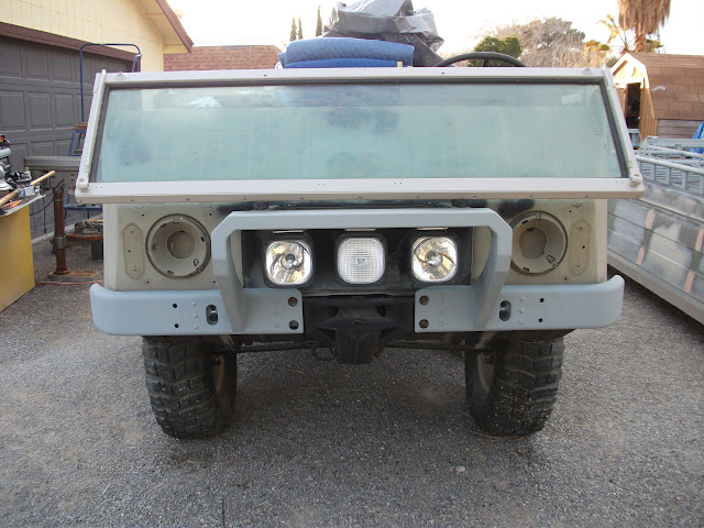

I got the bumper fabrication finished but still need to add paint, used 3"x 1.5" rectangular tubing with a notch and bend construction.
The bumper with the lights mounted.
The whole light array can be removed by removing 2 wheel lock nuts and unplugging the wiring.
Showing the windshield down.
Easier to see the construction without the lights installed.
The lights are the ones CAT uses on their heavy equipment. They are 24V 35watt H.I.D. lights with all of the electronics potted into the back side of the cast aluminum housings, so they are vibration and water proof. I have a full set of 3 each of High Beam, Wide Work and Amber Fog Lenses and they are replaceable with 4 screws for easy on the trail swaps for what ever conditions I may run into.

Great design. It compliments the angles of the front end of the Pinz. Looks like an integral component rather than an add on!

Good work. Is the flimsy pinz bumper capable of supporting that add on piece?
Re: Miles Pinz Restoration Progress (pic heavy-milestone thr
The added bumper nose is welded between the mounting bolts so it is very solid, enough for me to stand on it with no problems, while leaving the ends of the bumper to be weak enough to bend without bending the other parts of the frame and body. Let the bumper do what it was designed to do, when you put too strong of a bumper in place all the energy of a light bump gets transferred into the frame causing damage with every light bump.
I'm happy with the design and will be making a set of bumpers for the rear from the same 3" x 1.5" tubing stock; I never liked the look of the round tube bumpers on the rear.

Thanks for the response. I have a very strong bumper in the front. Had not been thinking along your lines of thought about transfer. I thought...stronger is better.
I will be anxious awaiting photos of your rear assembly as I am also not particularly enamored with those little tubes either. I did not want anything that interferes with the
tow pintle.
