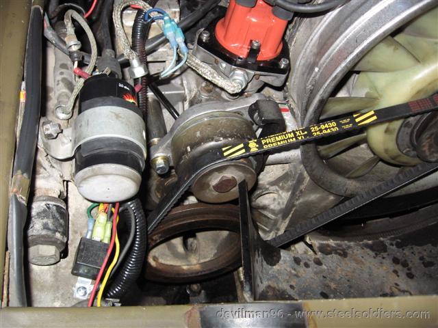

Thought about installing a separate 12v system using a small 12v magneto or alternator from a garden tractor or such. Don't remember where I found this example.
Re: Pinzi SSI
So.... not a double pulley but a longer belt to accommodate the pulley on the additional alternator. I have only seen it done with a double groove pulley which is an even greater expense. Looks to be an acceptable solution to making 12V, not from a battery or converter, since the additional voltage is only required while the engine is running.
Re: Pinzi SSI
krick3tt wrote:So.... not a double pulley but a longer belt to accommodate the pulley on the additional alternator. I have only seen it done with a double groove pulley which is an even greater expense. Looks to be an acceptable solution to making 12V, not from a battery or converter, since the additional voltage is only required while the engine is running.
It seems they created a separate 12v system here is a link to where i found the photo several years ago http://www.steelsoldiers.com/showthread ... stem/page4 You need to be logged into SS to see the photos. Thought about doing this never got around to it. :(

Re: Pinzi SSI
Very cool!!
