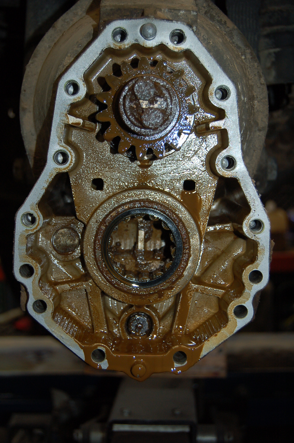

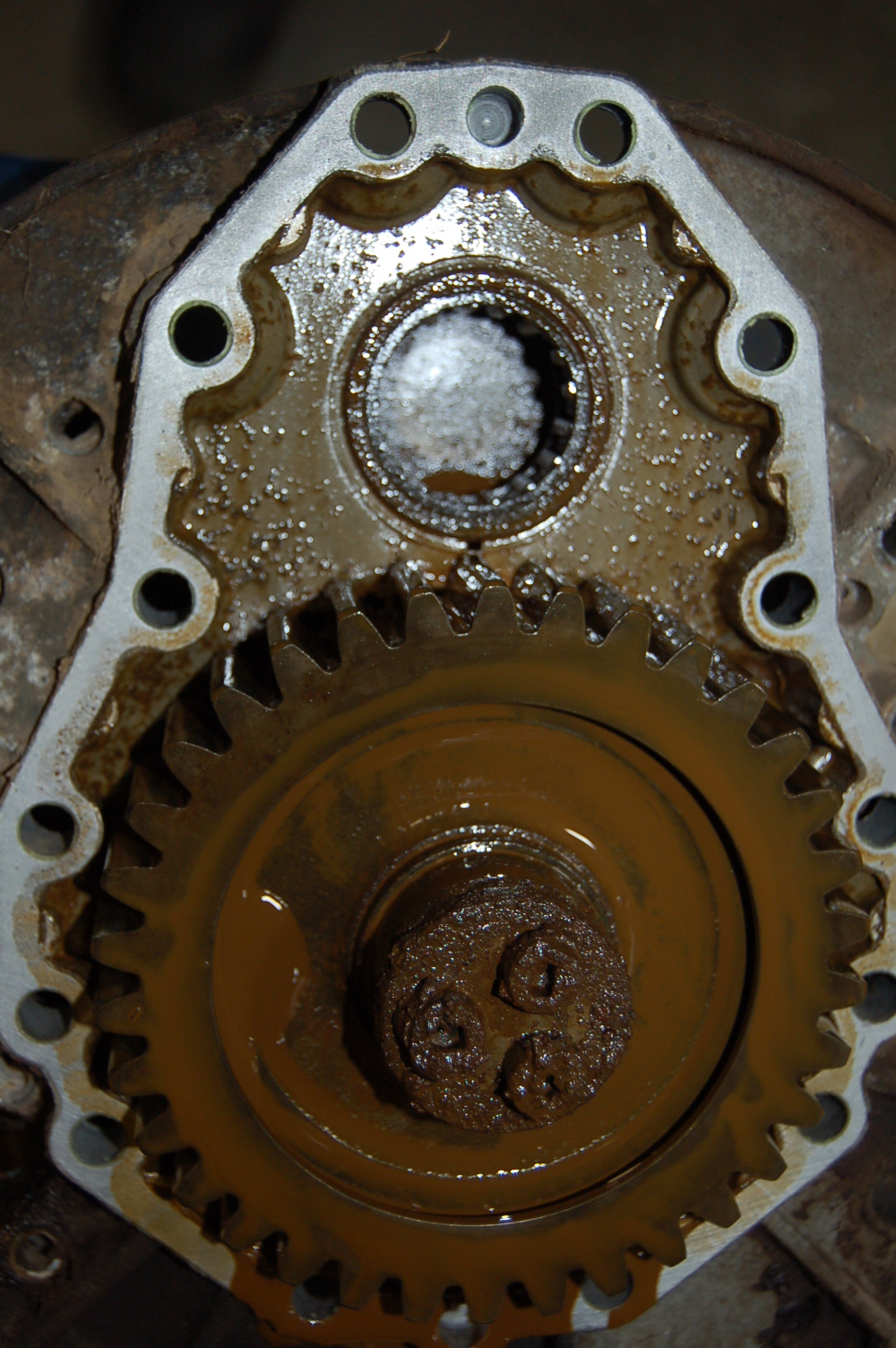

FYI, if you have not seen these pictures before this is what happens when you park a truck in water for a couple of weeks (20"+ deep), then drive without changing fluid.
712M Reynolds Backing Plate Removed 1 Hub Seal Leak (35).JPG (853.78 KiB) Viewed 8719 times
712M Reynolds Hub Seal Leak (37).JPG (755.3 KiB) Viewed 8719 times
