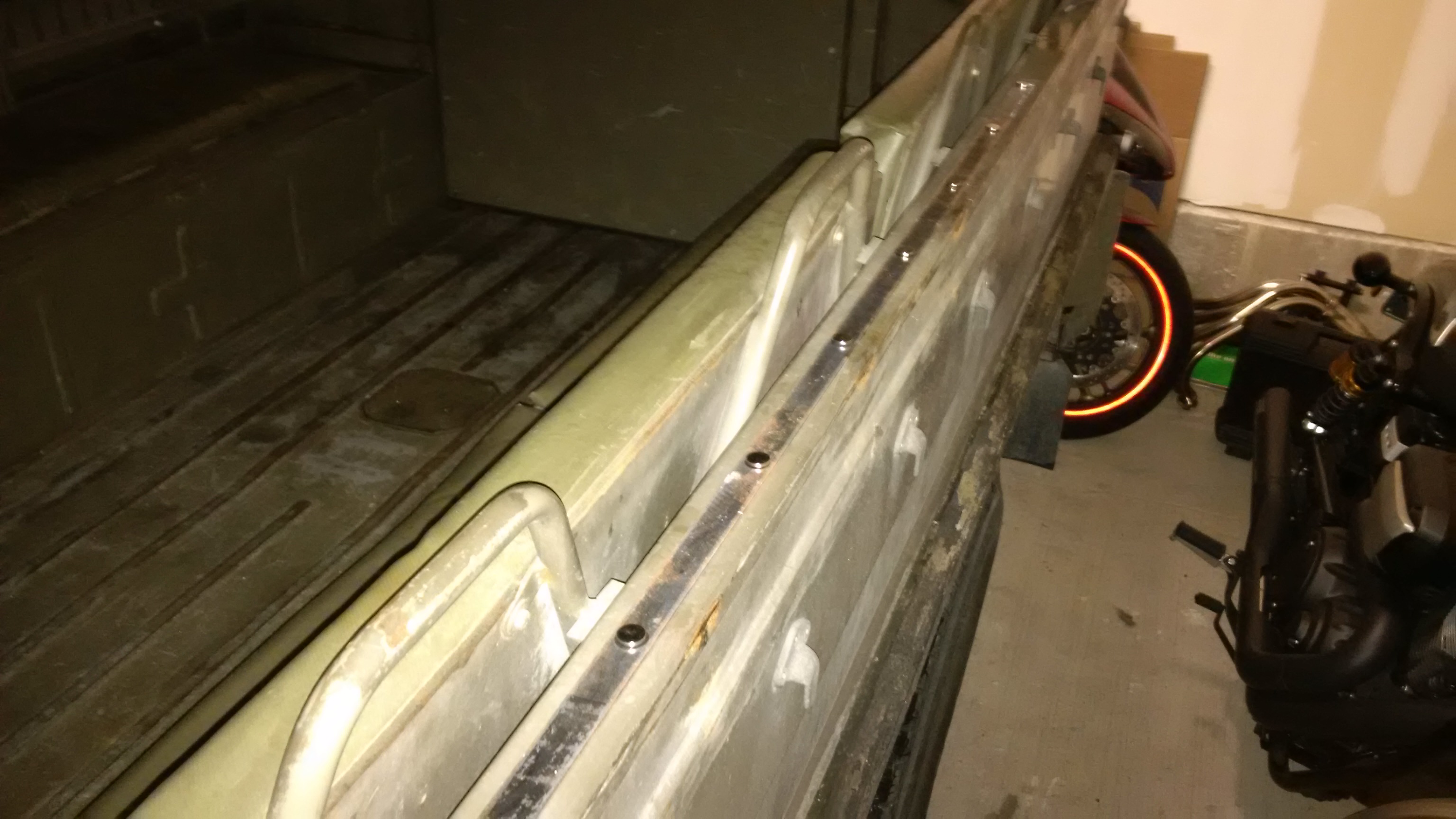

Now that it is actually 'cold' in Texas, I've gotten some real use out of my heater and starting plugging the holes. Starting with the most major hole was where the rear cabin flap came down.
It wasn't even CLOSE to sitting flush and heat poured out of this opening.

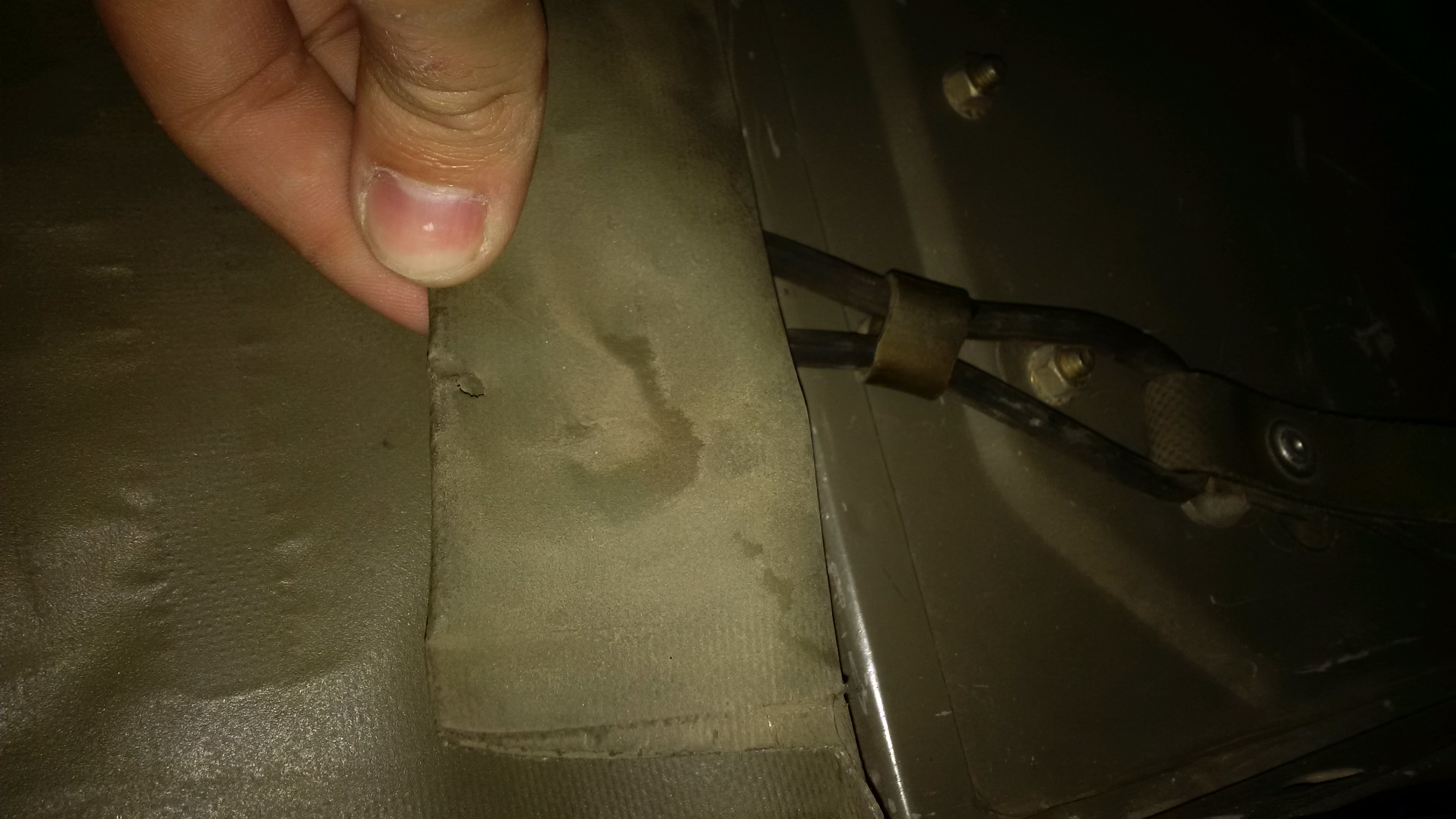

Wanting a simple solution that looked stock, I glued some high-strength rare earth magnets to a spare piece of flat bar I had.
Made a small incision under the hole shown in the cabin flap and slid it in! It's doubled over at the bottom making a nice pocket.
I used 44" of flat bar and 8 magnets. The two center hold down straps I just flipped around and clipped on to the cage so the magnets had a flat surface to stick against. End result is awesome and this took all of 30 mins of waiting for epoxy to set.
Hope this helps a few folks stay warmer this winter!
