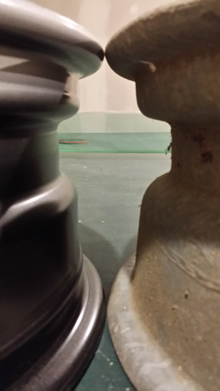

I suppose the availability of 17 inch wheels would make it easier these days - very little room in the stock steel wheels for discs and calipers. I know that the Trail-Ready wheels are huge in comparison. Even the Ford Transit rims I recently got have a lot more room in them as they don't taper as much internally so they actual center of the wheel is much larger in diameter - at least an inch larger.
I wonder if those ML mercedes wheels are 16s or 17s?
