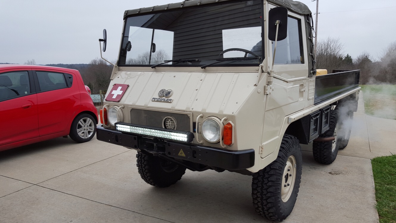

My son was kind enough to get this for me for Christmas, finally had time to install today. Yes, it is from China, but it works pretty slick. I used a Rigid light wiring harness, also pretty slick. Took it out on the ridge tonight, and YIKES! The problem is, you get used to seeing everything, and then you go back to regular headlights and it's a bit of a letdown.....

Hello. I have been looking at those also. I saw one of those on a semi, and it was extremely bright. But it was half the size of the one you have. What is it rated for 12 thru 36 volts or was it specifically a 24 volt item. I am looking at installing a set of LED square auxiliary lights for the front also. Did you run this off of a relay? If so, where did you tap the power for the relay and the hot for the lights? Did you run a new hot lead off of the batteries? Can you show me a picture of your dash where you installed the light switch? Where did you get the wiring harness? I was going to make my own but if you got something reasonable, that may be the way to go. Thank you. Brian.

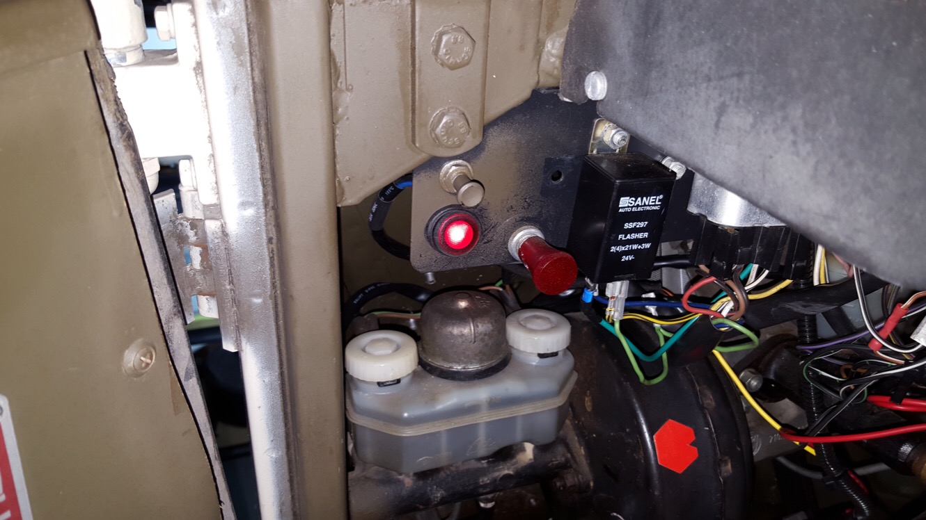

Brian, above are the products I used, the harness is a no brainier. I used my 12volt converter for power, but the light is rated for up to 30 volts. I installed the switch in the dash panel where the 24v aux. plug was, just needed a little filing to fit snug...

Why not connect straight to 24v? You're drawing more power to drive them from your converter than a direct connect.
- muttandjeeps
- Posts: 99
Re: 712 Farm Pinz gets a light saber.....err light bar....
Harness relay and light switch rated for 12v......
