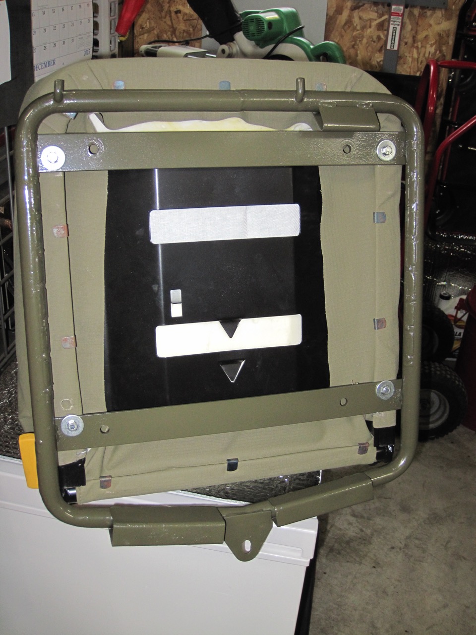

Re: Seats...Again
Here's some photos of the seat frames. The passenger one I had previously used on another seat which is why there are 4 extra holes in the cross bars. Also I would have welded the bars between the side frames rather than on top of them like shown if I were to start fresh. That would probably save 3/8-1/2 inch in seat height.
The drivers side was a fresh start so I welded the cross bars at the center of the side tubes - on top would have added unwanted height to the seat cushion but you do have to have the bars somewhat up from the bottom or you wouldn't be able to insert the seat bolts.
The headrests are adjustable vertically and front/rear. They fold forward far enough so that removing the passenger seat is relatively easy. BTW, the seats are not light but seem reasonable. I think about 35 lbs or so.
Re: Seats...Again
Wow super easy! One of those " now ive seen it " moments. Thanks
