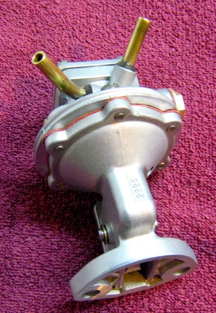

BTW, I also remembered that one time I had a fuel pump rebuilt professionally it was pointed out to me that the brass inlet & outlet tubes had become loose and air was leaking out (or in) at those points. A careful application of JB Weld took care of it.

I had a no fuel scenario on the beach with a rising tide once. I flipped the diaphragm over and the pump worked great since.

I ended up pulling the pump, opening everything up and cleaning everything, plus I did the JB trick on the brass intake/outlet, just to be safe. Put it back together and it all seems fine for now. I did order a replacement, SAV was running a special on NOS pumps, didn't cost much more than a VW one, and now is in the spares box.
