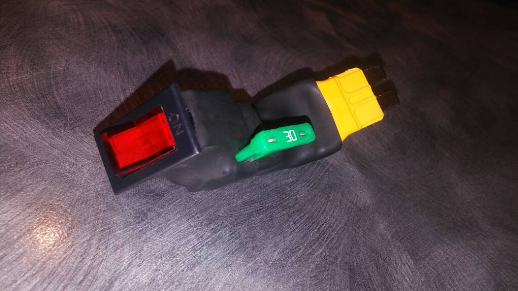

Solution: build a rigid fused toggle assembly that plugs into the oe converter fuse and reach over to shut it off. It only draws 2 milli amps, but if left for several weeks would draw down the Optimas so I came up with this.

This allowed me to do it at the source or converter that is mounted on the passenger side. I could have run wires over to the cutoff ( which doesnt work on my rig) but I had this stuff laying around.
