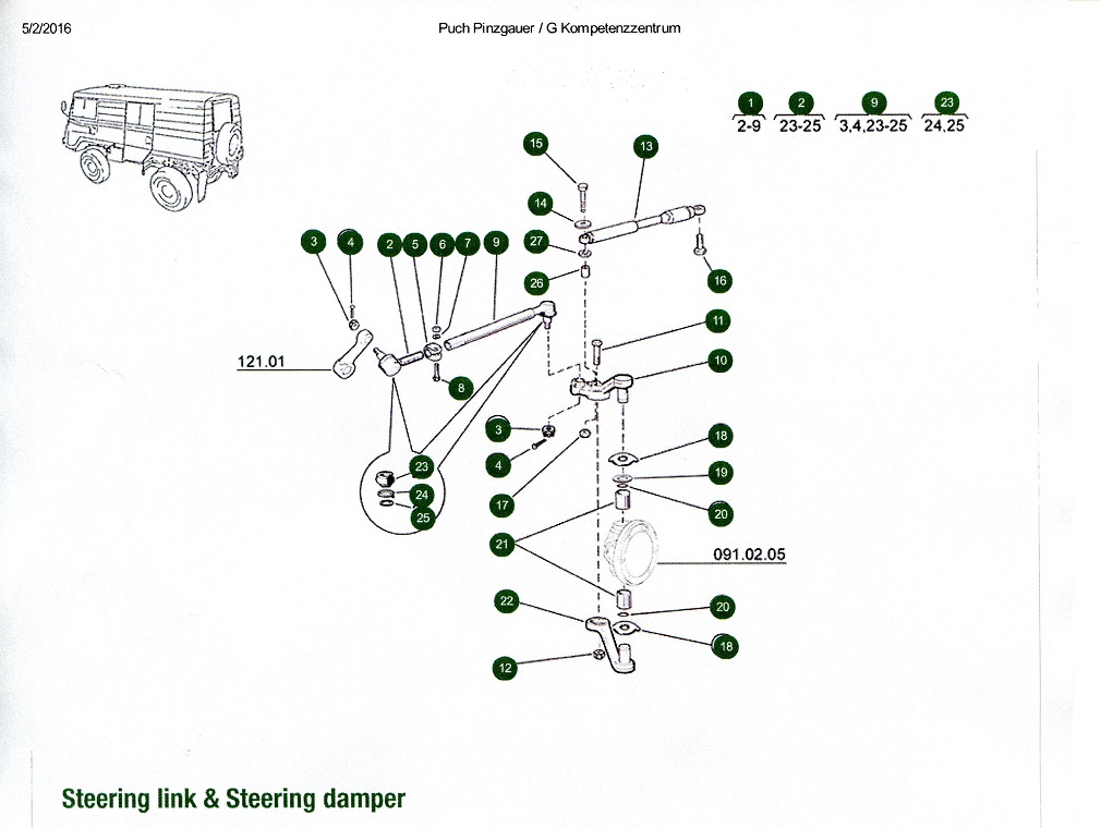

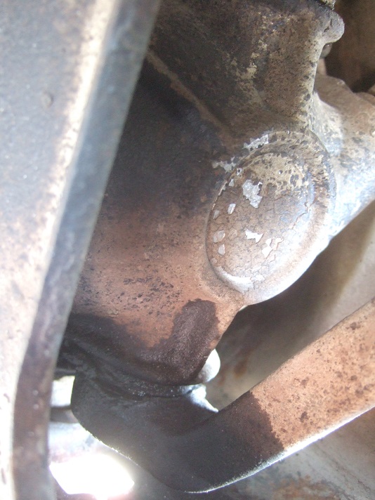

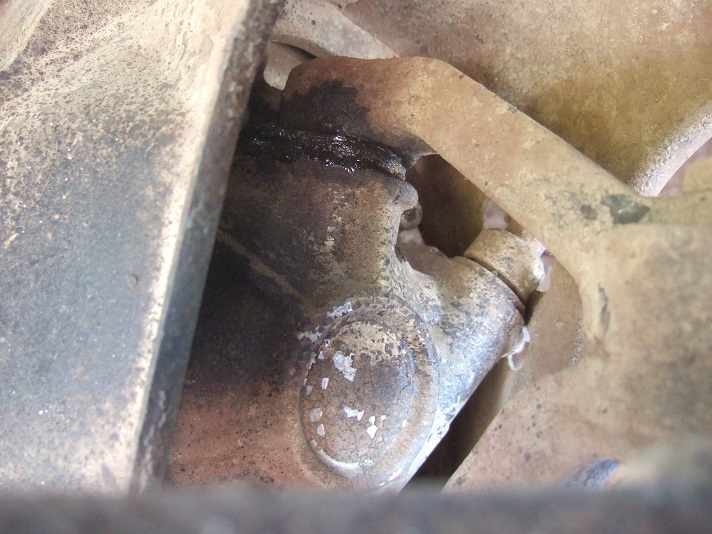

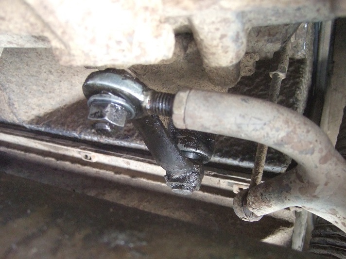

Gents,
After years, suddenly two points are starting to leak, that never did before...
My Pinz did not leak before, because I bought a Puch-factory overhauled (in 1995-1997 all Austrian Army Pinzes were factory-overhauled) Pinz in 2007, that then had a new-refurbished engine, start-motor and carburetor and only drove it about 4000 km since then because of other issues.
Anyway; after bumping on a speed-bump my steering-gear-box started to leak. We took it apart and put new seals on it. It still leaks a little from the hole where the wire goes in, hopefully it will stop after a while when the excess has 'leaked out'
The 2 new leaks are:
Gearbox-selector-shaft
Steering-link and damper
It probably is a simple question, but I would think the seals are cracked and started to leak. Has anybody renewed these seals and how hard was it to do. ?
- The gearbox-selector seems like you have to approach from the top at the back of the Pinz, ie take off the gear-box-cover
- The Steering-link seems like a hard job, as you have to take off a lot of rods and put the them back exactly where they were...
Suggestion as two which seals to order and renew ?
As always, thanks a million in advance for your comments
Best regards,
Jules.

Hello Jules,
I wouldn't recommend renewing the seals unless the leak is substantial. Your photos seem to show seepage rather than a leak. Is there oil under the truck? If not, or very little, you may just want to check the level, top up if needed, clean the oil off the truck with something like aerosol brake cleaner, and drive it. A single drop of oil will spread to appear to be a substantial leak in dirt and corrosion. Minor oil seepage on any old tractor is a fact of life.
Unless you are going to develop concourse d'excellence disease I would start there.
Good luck.
Cheers, Clive

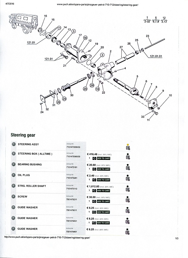

Hi Clive,
I forgot to mention that I wiped the leaks, so they look better than 'for real', however it is my wife who hates oil-leaks on the driveway...
They are only small leaks, but they are persistent and remember" Mama ain't happy, - nobody - ain't happy...
The oil-leak where the wire goes in the steering-column-gear, suddenly started to leak badly, probably after I 'ruined' the liquid-seal we had put there, by feeling at it... It is the only place that is oil-wet. So it is either broken at the bottom of the the long protruding stem (where the wire goes through - Nr 32), or 'excess oil' -leaked in the column (nr 27) is now above the stem-length and 'overflows', but this is not very likely, as it did not overflow when I filled it up the other day.
I want to put some sort of rubber seal around the wire and shove it in the hole, but it still means taking off the steering column again, as I cannot get at it - too close to the floor-board.
Anyway thanks for your comments, I do appreciate that is the 'normal' way of having an old army-truck.
Best regards,
Jules

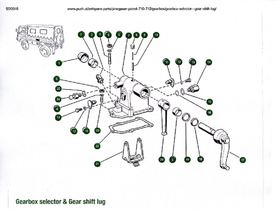

I can tell you about the transmission leak. Super easy and one you should repair, because low transmission fluid is a problem and left unattended your driveway will look like crap and you run the risk of damaging your transmission.
There is a really great post titled "tranny oil leak...." in drivetrain. Look it up, walks you through step by step. Few bucks in parts and about an hour and you'll be done. Just make sure to put the seals facing the right way, saves you from having to do it twice.
Since I repaired that, no leaks at all. And it's not like the seals had cracked or anything, just old and worn out.

Thanks Texas710 !
That is a good article about it.
I looked it up and have some hope that it should be possible, but not easy, unless you take the whole housing off.
I'll see how far I get
Best regards
Jules.
